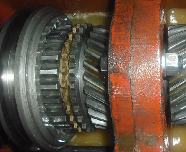

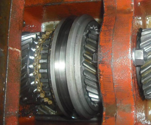

When putting the machine into forward it grinds and tends to kick out of gear and will not move. I attached a photo of the gears, It appears that the teeth are ground down and need replacing. Does anyone know what would be involved in accessing the gears to replace them? Will I have to split the tractor? Ugh, not having much luck with info on this.

I realize the gears aren't the best of shape, but is that the exact problem..?? If it's the manaul reverser like on the 310B I had, the roll pin in the shifting fork was worn, and the hole in the shifting fork itself was worn, causing lot of slop. These being worn would not lock the gears fully in place. That pin is like an 1/8" pin, so they won't take a lot of punishment.

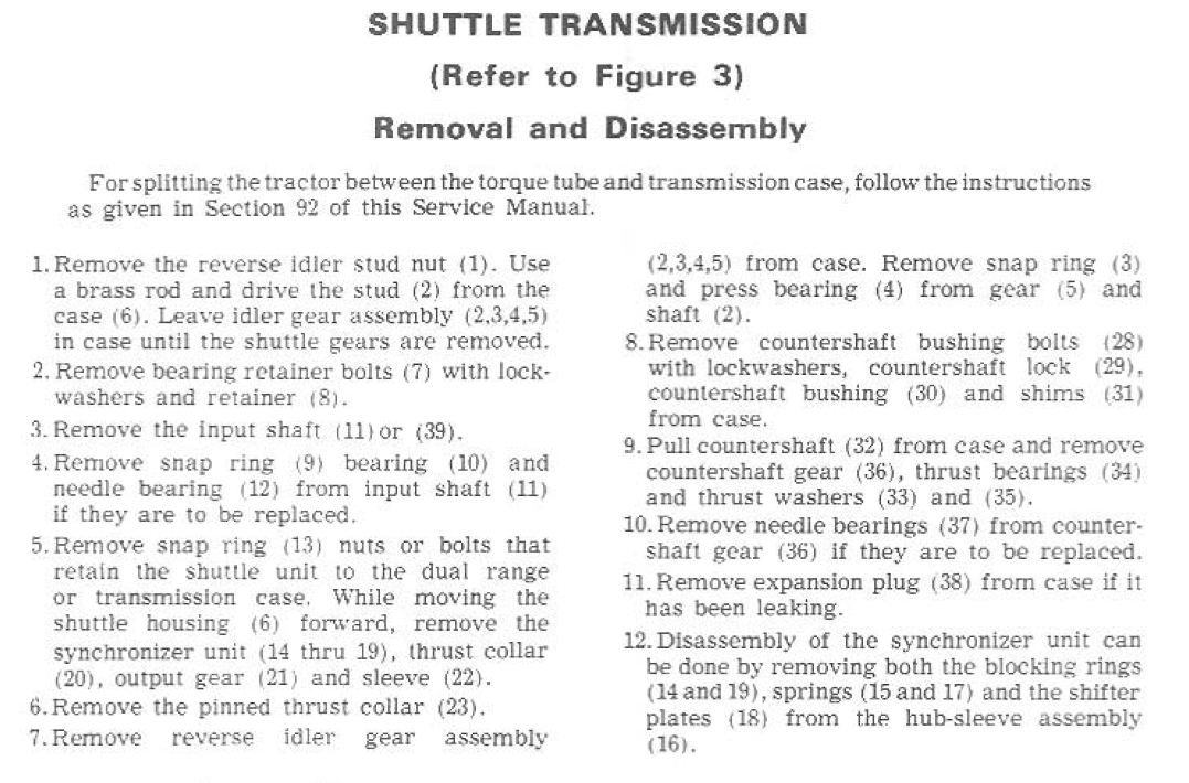

Their does not seem to be any play, The Forward/Reverse lever would actually kick into the middle position when in forward, The teeth are very worn. I am looking for the section 92 of the service manual, as my PDF seems not to have it. See picture.

Maybe this will help... This is a link to specs & service manuals for a 530 I found quite by accident 5-6 years ago. Case 530CK - Tractor Specs Quite possibly the manual shuttle is the same animal on several models. Click on manuals in the left column, then mechanical shuttle 3rd item down, in top left box.
Hope this helps..!!
