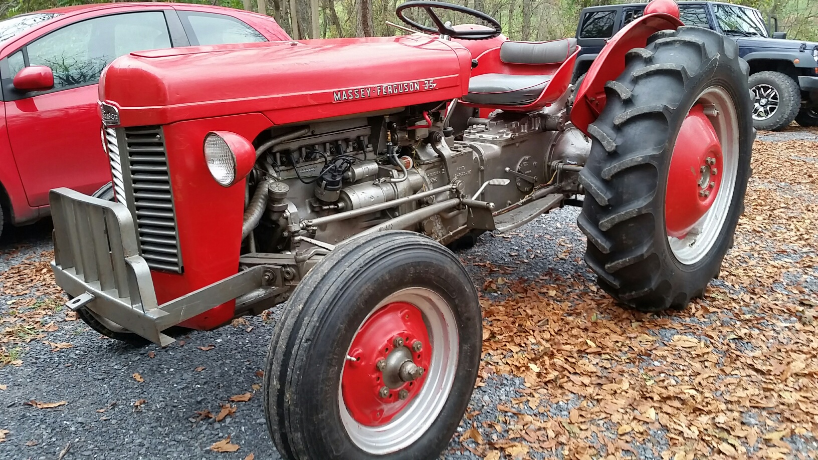

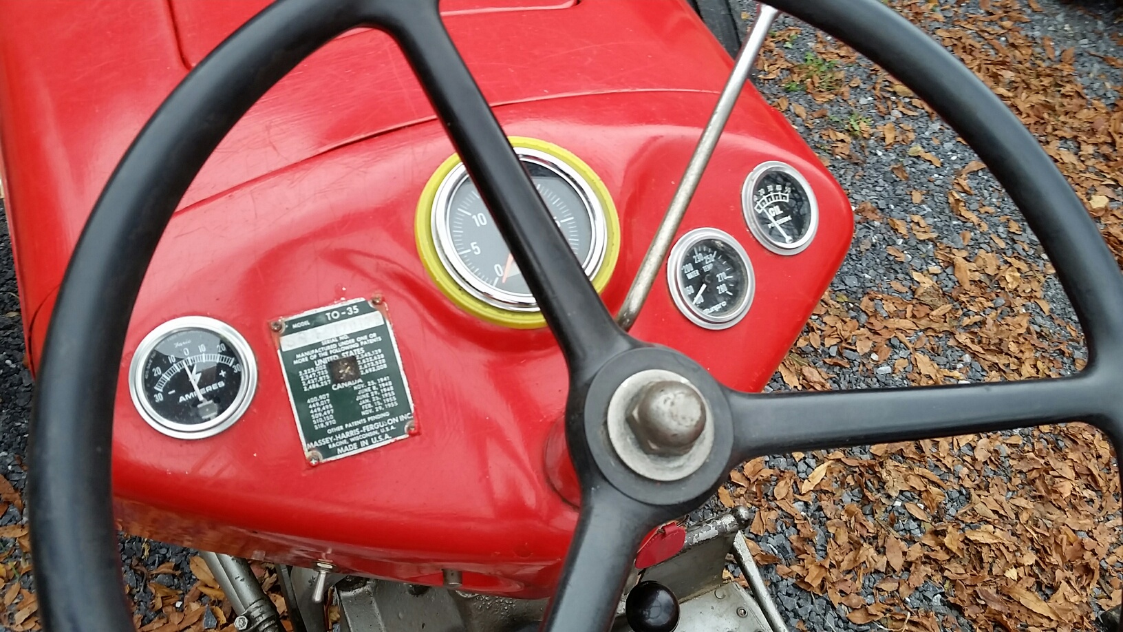

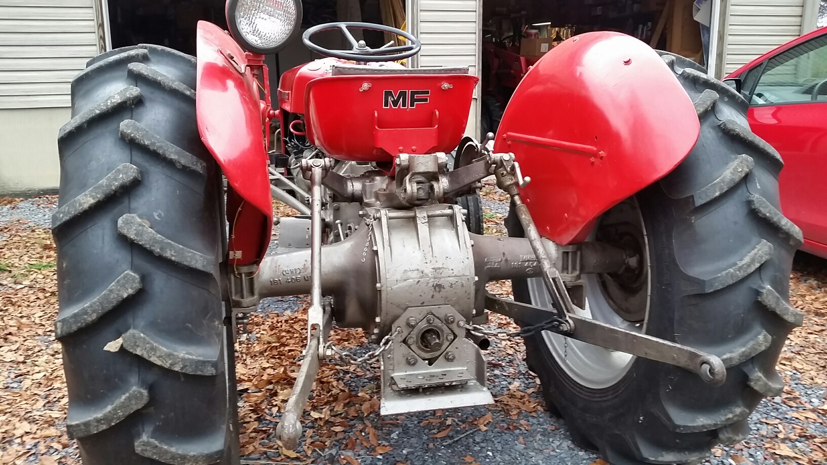

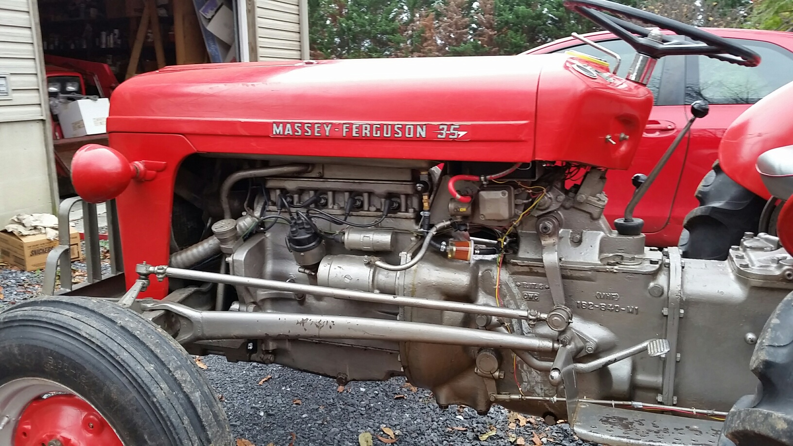

posting up several questions tonight. Keep looking online and finding more things to ask. I have read on several forums where folks seem to be having the same identity issue im having. I was told its a 1956 deluxe model but when I looked up the serial number (SGF I70I73) it says its a single stage clutch setup which I believe it does unless it needs adjusted because it acts like a single stage. thing that is confusing is it has Tach, Oil pressure gauge, Water temp gauge, ammeter and the pto is Engine/neutral/ground PTO. Any insight to what I might have?

There is plate under the bell housing that is held on with 4 bolts, if you can get that cover off, and get some pictures of what the clutch looks like.

Try the Yesterdays tractors website. There is a section under Research and Info on the left side of the page called Serial Numbers that can be helpful.
   / 1956 TO35 model? #4
S=standard, G=gas, F=single stage clutch

ok. yeah that's pretty much what I found as well. still a heck of a find. the guy who owned it before me gave me all his manuals and journals of things he did to it. little bummed it doesn't have dif lock or 2 stage clutch but the tractor came from a person who really cared for his equipment. thanks all for the help
