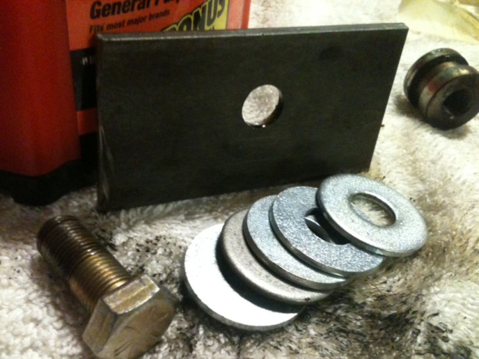

Ok, that sounds way above me. If I were to take it to a repair shop, how much should I expect to pay if the unloader valve is stuck? Don't want someone to rape me since I'm not very educated about tractor repair.
/ 1954 Ford NAA with Piston Pump #10
The naa is its own hyd deal, irs way different than 8n, and 'similar' to later models. Real trick may be finding someone who knows how to work on it.

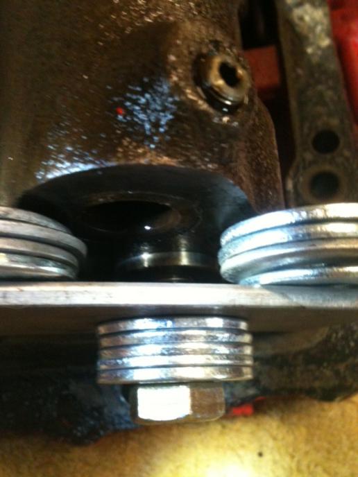

A metal bracket with 4 holes, a bolt, and alot of washers can de used as a puller once you get to that point.
#11
Ok so both my manuals came in today and this is how far I have gotten. I am not sure how or where to insert the bolt with washers that I have been reading about. See attached pictures and please give guidance. The piston in the large cylinder appears to be stuck.

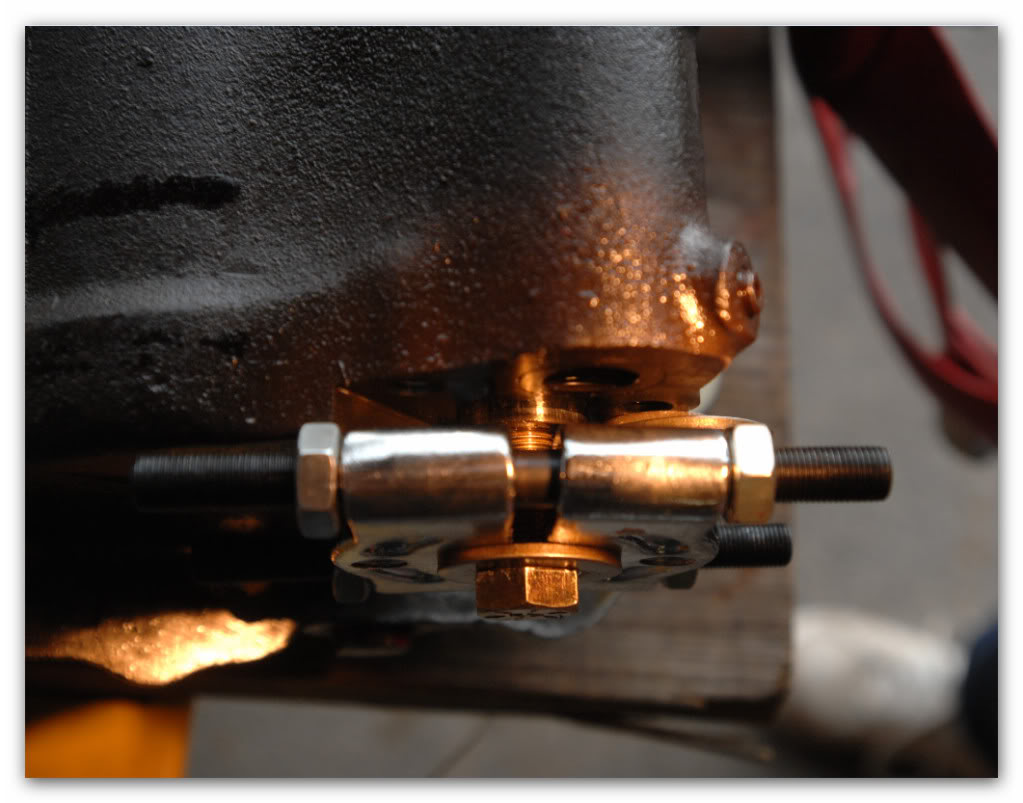

/ 1954 Ford NAA with Piston Pump #12
here
As shown, metal plate and washers.. or a bearing splitter.
