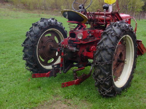

I have a farmall 200 with a 2pt hitch and touch control.It came with a home made 3pt hitch.It works good but not as easy to hook up as a real 3pt hitch as there is no independant sideways way.I have found it easiest to put the arms on the implement and start them in the 2pt.then back the tractor up.

here is another pic.let me know if you want top link bracket pic and I will take one.
