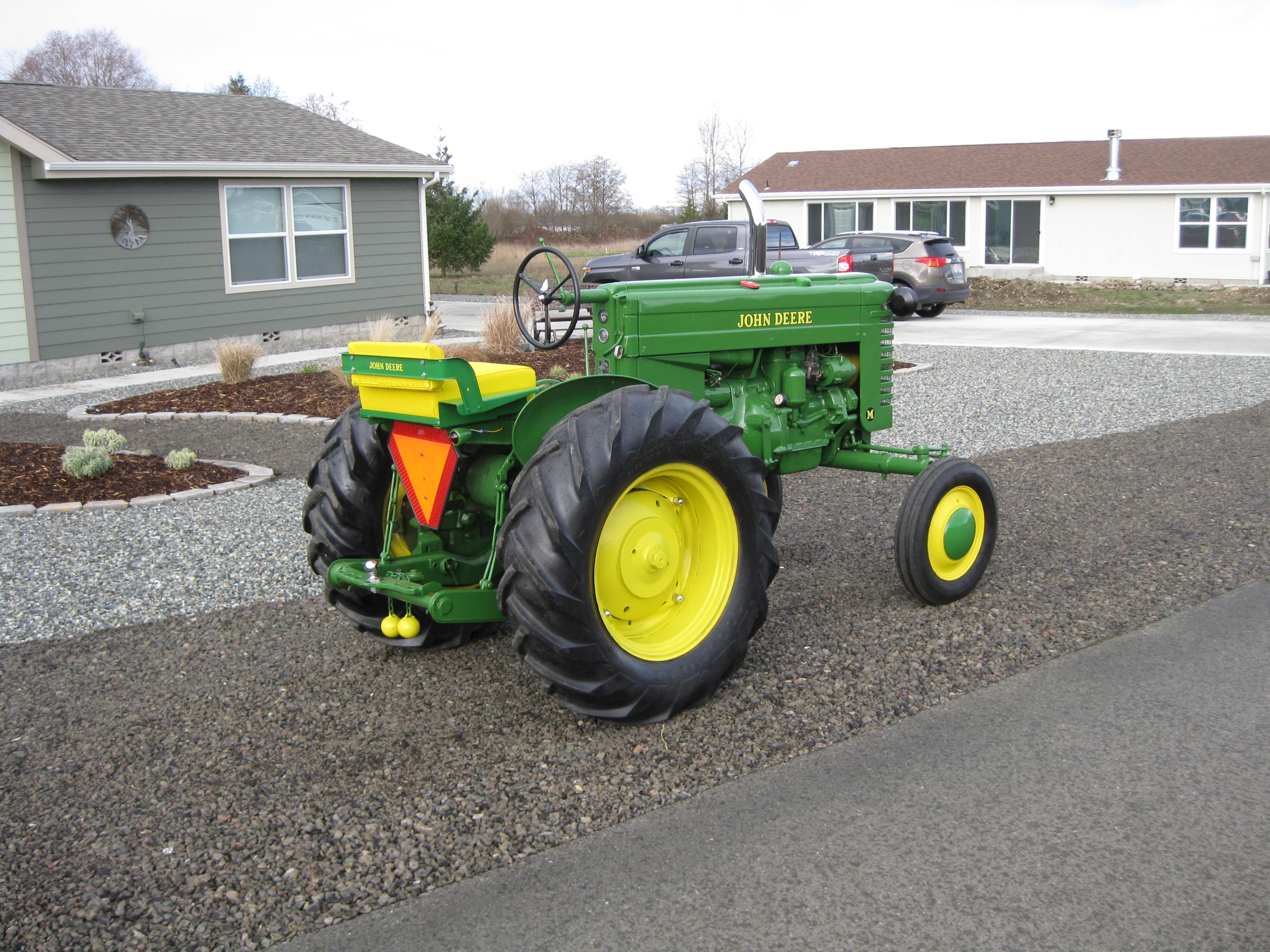

here it is my parade queen:)

Looks like a straight exhaust...
Very distinctive sound and my nephew won't hear of any talk to muffle it... it is loud and can be heard acres away...
Always a crowd pleaser.
