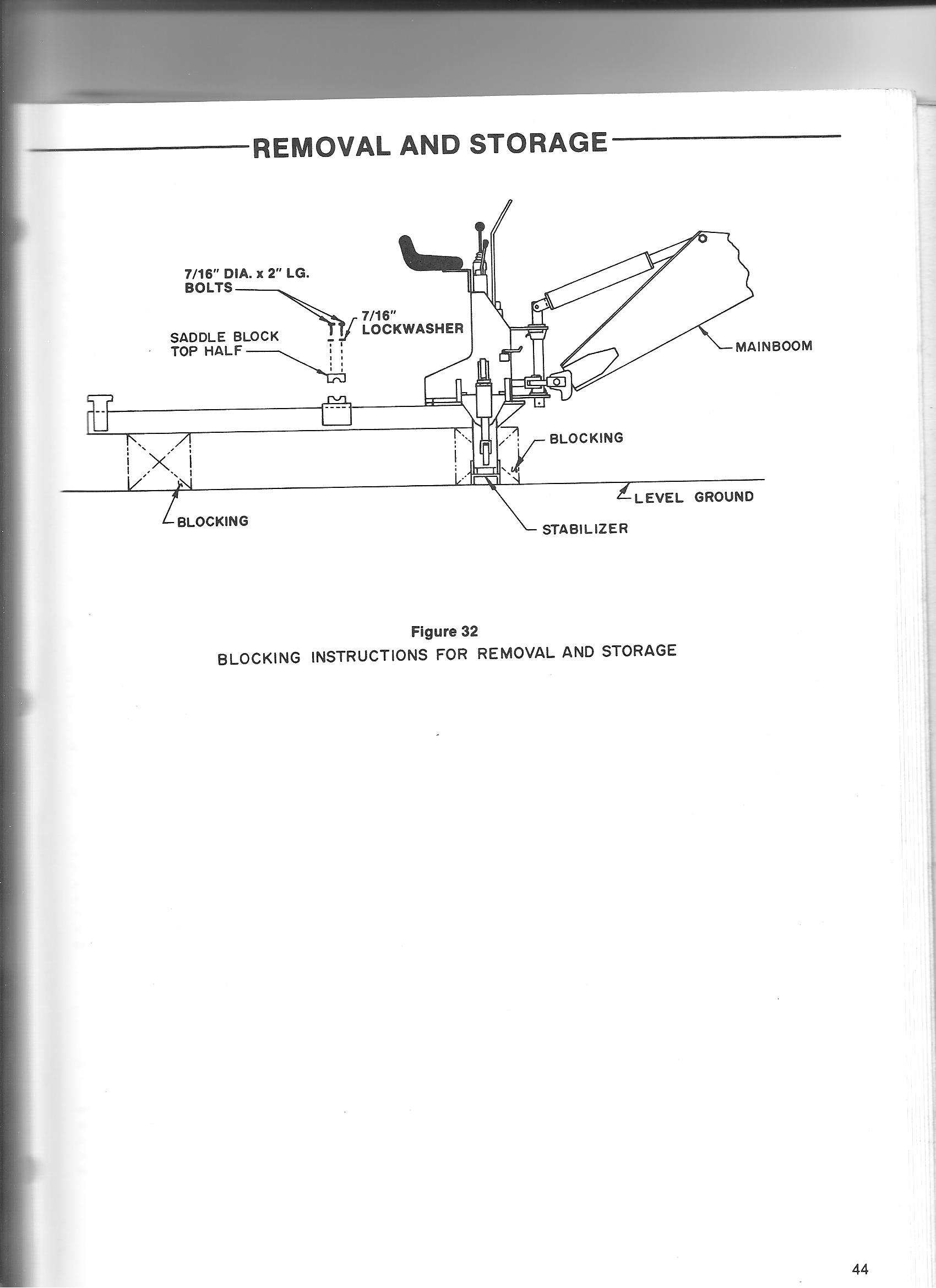

JLB, I'm a little late to the party, just saw the post. I have the 758B mounted to my TC40D N.H. tractor. The 1920 and TC40 are similar in size so mounting I believe is the same. The manual is not much help describing the mounting/dismounting procedure. I can try to answer any questions you might have but short of that here are excerpts from the manual, jpg. and PDF.
Bud
  • 758B.pdf
   / 1920 With 758B Backhoe #3
Bud
Adding a couple pages from my manual for my 758A backhoe here ....758.jpeg758 pg44.jpeg
