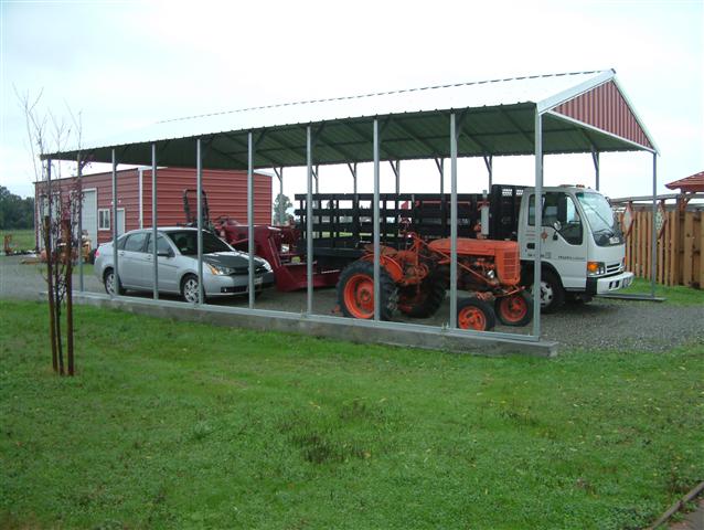

I desperately need a place to start storing some stuff and am on a seriously tight budget. I was thinking about pouring a slab and having one of those $700 steel carports put on it for now, with the idea of eventually adding walls.
should I consider a pole building instead? I know I'm going to hit ledge in some spots a couple feet down.
I'd appreciate anyones experience along these lines.

I would expect that the carport will ultimately be too small for a final solution. I plan on putting up a carport on dirt floor for my interim solution. I am currently displacing my cars from their carport for my tractor and radial saw. I need to move them, but would really need two 18x24 carports for my tractor, saw, trailer and odds and ends.
I don't see you being satisfied with the carport for long term in terms of storage space.

I know the size is small, but there's no way I can go much bigger. I need space for my small tractor, workbench, mower, welder, some shelves, and some open space to work in. Implements will stay outside. I won't be getting a larger tractor unless I move.
Also, I know if I build a huge barn, I'll just keep getting more crap to fill it with, and I'm at the point that I really don't want more stuff to deal with.

I wouldnt go less than 20 feet wide for double car port and preferable 24 x 24. That way you can later park 2 cars in it if you want without banging the sides with the doors. I dont think it would cost much more for the extra 6 feet of width. Regardless of whether or not you want more "junk" to store, you will invariably get more so you may as well plan ahead a bit. Check pricing for difference in cost for the larger area. You may be able to swing it now.

You are spending some decent money on a concrete slab. My thought is that you can put up your poles and roofing for a pole barn and have the same structure as a carport-essentially you would have a carport, but one you can side, add doors and windows, and electricity as the budget allows.

the carports I'm talking about aren't the portable ones- but the square steel tube framing with steel roofing and bracing- they are snow rated and seem to hold up around here.
I'm looking at around $1200 installed (in a day), not including a slab.

If it were me, and I were in your shoes, I would get a larger one, have concrete footings, only, poured for the metal framing, and lay a crushed rock floor, until I could later afford the concrete.
More square footage is ALWAYS better, especially if you are using it for storage AND a workshop. I have an 18x18 carport, like you describe, for my tractor, mowers, 12ft aluminum boat, and a few assorted other things. I also built a 24x30 stick frame workshop. The workshop and the carport are already crowded and I do not keep buying things.
You do not want to trip over stored items, just to work on some honey-do project.
The unmentioned advantage to a larger carport, is that you do not have to remove half of whats in there to get to what you need to use.

if on a budget, then how about the carport and gravel, retain t he gravel with a form board. you always can go back in an pour a floor if needed / add sides.. etc.
