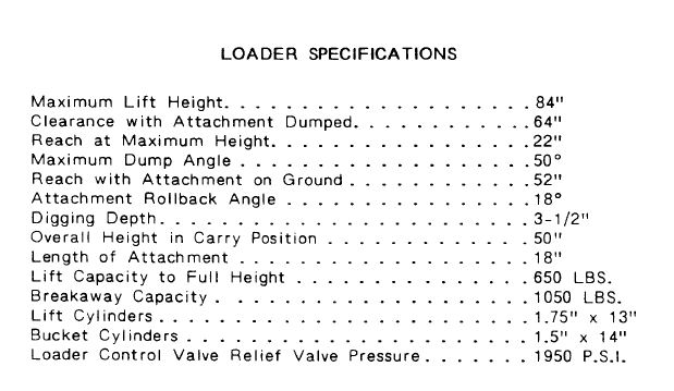

What's the lifting capacity of the YL-650 on a 186D with filled tires and a mower behind?
   / 186D with a YL--650 loader , #2
Hope this helps. From the YFL-650 186D manual.
