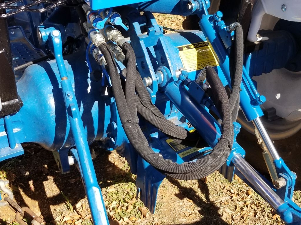

I am looking to source a hydraulic side link for my 1840M and haven't found one yet. Apparently, ball top sidelinks for Cat 1 hitches aren't too popular as I haven't found a candidate link at the usual sources. Asking to see if anyone has found one before committing to a custom link from Fit Right Hydraulics.
   / 1840M Hydraulic Side Link #2
I'm a cheapskate and don't like to wait months for something I paid for, so I made my own. I had to modify the lower connection since the cylinder wouldn't clear the rearend when down. I don't remember where I got the cylinders, but they came with the locks and hoses for less than a single cylinder from FRH.

Just a comment from left field -- unless you have a LOT of need for adjusting the angle of some implement I would never waste a remote on an hydraulic side link. Not worth the cost either...

Good point, if I can wait the 5+ months for a custom one then perhaps I don't really need one...

It was worth it to me for a back-blade. Also why I got locks on my cylinders. When set at a normal position, the hoses can be pulled from the couplers and the remote used on another implement. Perhaps like a side-shift flail mower. The locks take the pressure, not a disconnected hose. ;)

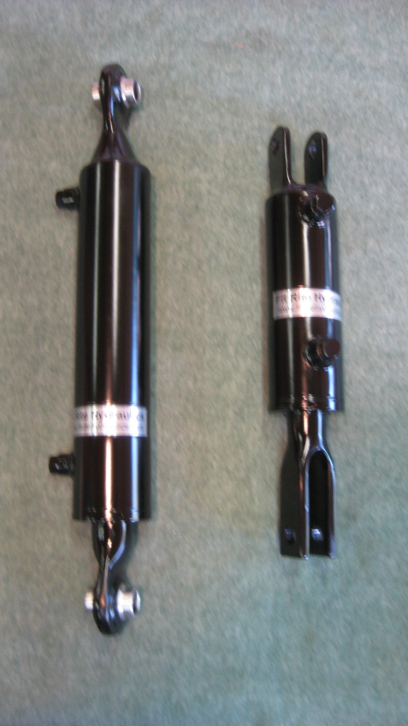

Yes I am looking for Hyd top and side link for Kioti 52 hp. Where do I find these other than dealer? Local dealer says side links are a problem. Why... dont know seems they are the same cylinder as top link..
   / 1840M Hydraulic Side Link #8
Why would you say that they are the same? Yes the same diameter and rod size, but the ends are completely different as are the strokes.
If you would like a total top & tilt quote, please go to the following link and fill out the contact page.
