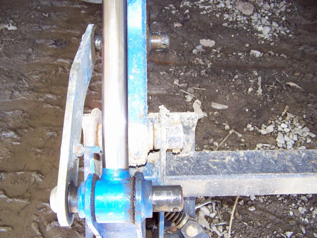

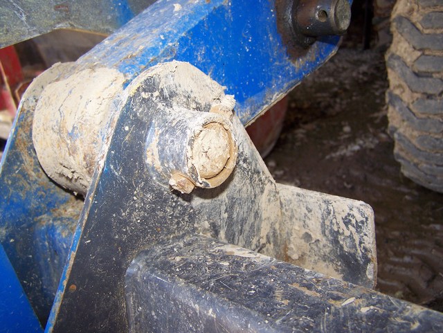

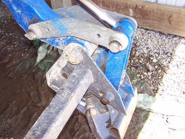

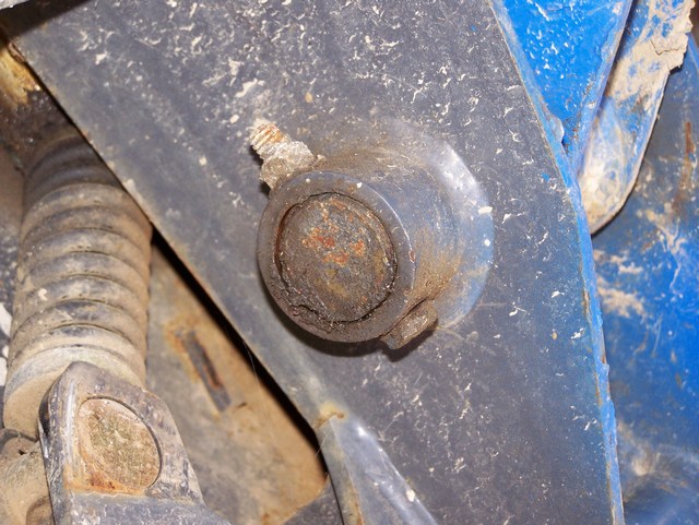

   / 17LA loader pin wear problem
As near as I can tell, it is not the clys.
Here are some pictures. Sorry for the dirt, but it has been wet around here lately.
It is hard to show what I am talking about in the photos. If you can imagine taking the QA plate in your hand at the bottom of the plate and pulling up on it when the loader is off the ground, there is movement at all four pins. I pulled the side off on one side to try to show the pin itself. Also, there are a couple of pictures of the end of the pins. Don't know if this helps explain it or not.
Did return the bushings to the NH dealer today and they could not offer any other help except to suggest buying a new tractor. Guess I can't fault them for trying.

   / 17LA loader pin wear problem #10
Slippy said:
Grease all points on a regular basis, and as I said, the pins really don't show wear. It actually has been like this since I bought it. Will take some pics.
Thanks.
If you were my customer, I'd tell you that the photo evidence indicates the greasing interval is too long. The pivot at the lower end of the loader boom looks especially dry. Also, this loader has a 4-link design. More pivots=more clearance. If these pins and bores were close tolerance, some would gall and sieze.
