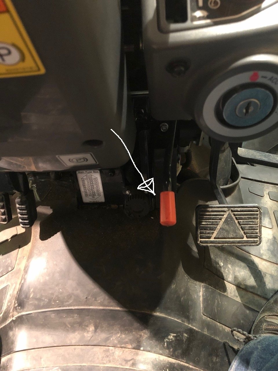

Oh my sorry, I totally brain farted, the lever for my New Holland is on the right of the seat. For the Massey its in front of your right knee with an orange colored handle, see picture:
   / 1750m Parking Brake #7
Firmly push the brake pedals down and pull the orange lever shown above up to lock them in place
The lever might go down to lock?? I can't remember. I do it so often it's just muscle memory
   / 1750m Parking Brake #8
Yes, you push the lever down to engage. To release it, you press on the brake peddles.
