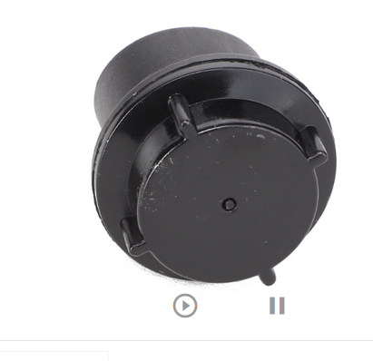

Does anyone know how the front axle fill cap is supposed to release the pressure that builds up during use.
I see the there is a v shape cut in the threads, but I don't see any way for the pressure to release.
When I removed the fill cap after using the tractor, there was obvious pressure built up.
I just don't want to blow my axle seals. Thanks for any info.
   / 1705 Front axle fill cap pressure release #2
see that thing in center of cap that looks like casting mark?
keep it clean. NEVER use tools/drills on it.
its the actual vent, a little pressure is fine, we all see it. axle won't puke fluid all over unless that center is plugged and crap gets really really REALLY hot. then at that point it has expanded enough (remember fluid not full to top of housing) and will come thru hole.

no need to go thru all that. OP did not say was any leaks. was worried about the pressure differential.
little pressure is ok. its normal actually, especially if its warmed up when you pull it to check.
overfill (if that plug is clean) may work thru it. its meant to do that.

Thanks for the information. That hole seems so miniscule, that it was hard to believe that it could actually vent.
You have put my mind at ease. Thanks again. This is such a great to get helpful information!
if you look close on inside of plug on the "shorter" side (iirc) you will see an approx 1/8 inch slot that runs up into top of plug, thats the channel to that vent.
