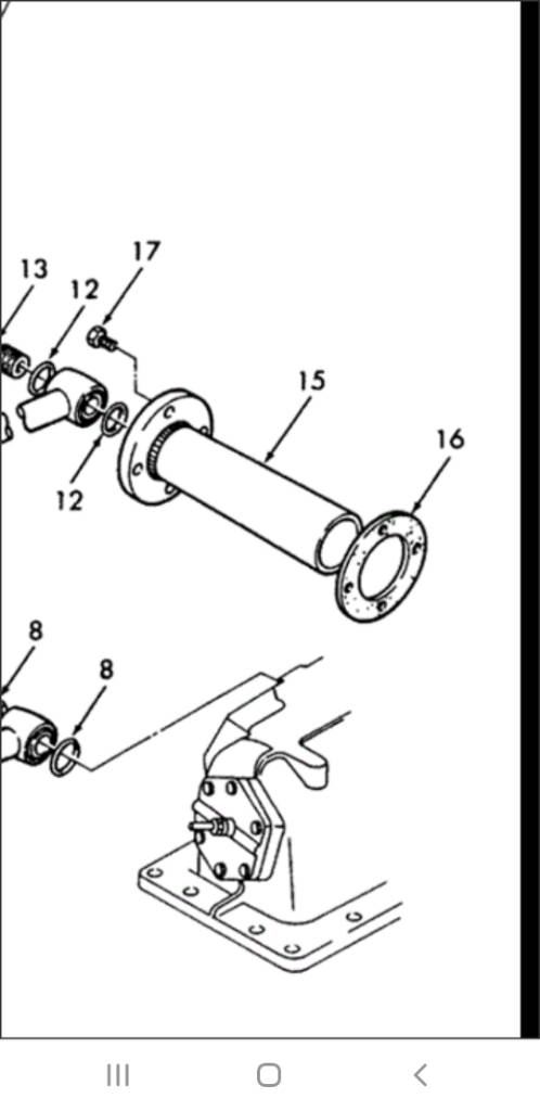

I followed the tech tips and troubleshooting information that you provided me and it was the relief valve, spring and poppet, after adjusting the control valve to specs and removing the guts from psi relief valve and running the engine the noise to go away, I found a tractor company in Colorado called FarmLand that sales used tractor parts, I purchased a used control valve 140, when i received I took it apart and found the spring 3/16 longer and the poppet in better condition. I installed and was able to adjust it immediately and alot easier than before with out the fluctuations when the fluid got hot, the loud noise is gone, there is a small noise like a purging sound it could be air, I ran it with a box blade and a rotary tiller and it ran great. Now the only issue I have is when I lift and tilt the loader to the max , I guess the stopping point I get a loud squealing sound coming from the loader side valve , do you have any trouble shooting information on that possibly? Thank you all the help that you have provided you are the Tractor Wisperer for sure, thanks again.View attachment 652290View attachment 652291
The loader should have a similar pressure relief in it. Since these loaders go on multiple tractors, there is a pressure relief so you can adjust the max lifting capacity to fit your tractor and not break it.
When ever you have open flow against a pressure relief it will make some squealing noise. It is the nature of pushing oil thru i little orifice.
I attached the 770 manual. Page 8 talks about the pressure relief.
