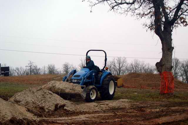

I have a TC 35D ss with a 17LA loader. Is there a place to change the presure setting for the loader? If so could someone tell me where it is. The loader has a 72 in bucket on it and it go up slow with a full load of dirt. Thanks /forums/images/graemlins/confused.gif

Since you have only 160 hours on your tractor, why don't you get your dealer to check the hydraulics. His service department has all the correct tools and specs for your loader. If he finds something failing, he can replace it under warranty. My 16LA on my TC45D lifts a full bucket of sand with no problem until I get to the very highest portion of the lift when it slows down some. Are you lifting the load up to the height of a dump truck? I have just hauled several yards of sand from a creek bottom and spread it on my yard. I had no trouble at all lifting a heaping bucket full of dirt like the one in the attached photo.
