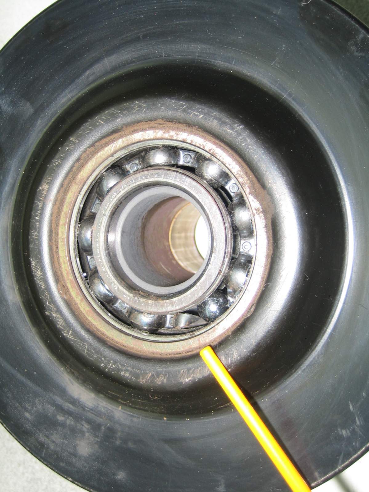

Thanks again OM.... I removed the PTO..new one is in route. PTO has less than 300 hours since it was last replaced. Not sure how this may have happened, but I suspect that because I was running the tractor for a few hours and it was hot and dry outside. Mowing conditions were dry and there was dust being thrown up by the mower deck. Should I lube this bearing at all to prevent this from happening again? Can and would it be worthwhile to have the bearing replaced?
Thanks again for all your advice. You're a good man.
PS. I'll post a picture of the PTO with the pinched bearing if I can figure out how it's done.

The bearings are sealed there's no easy way to relube. As far as replacing the bearing most of them are OEM only since the OD is metric and the ID is inch. Yours looks like it might have a adapter sleeve in so if you can get a standard size bearing it is possible to replace it. The OD of the bearing will be pressed in the bore and likely staked.
After you have the new PTO installed and before you put the belt on do this break in procedure.
