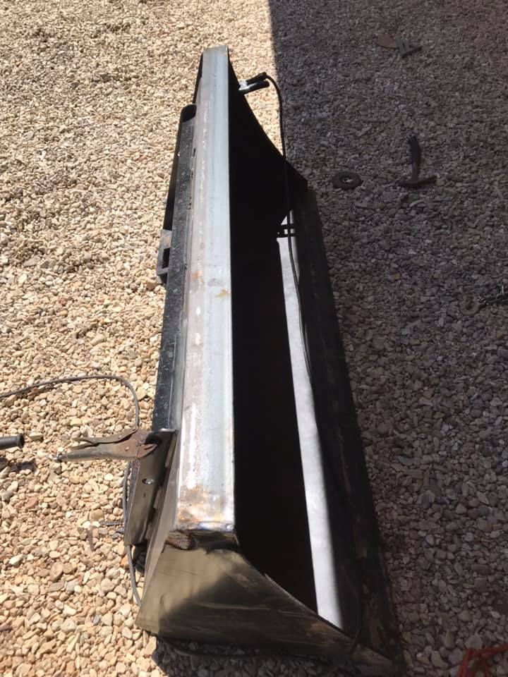

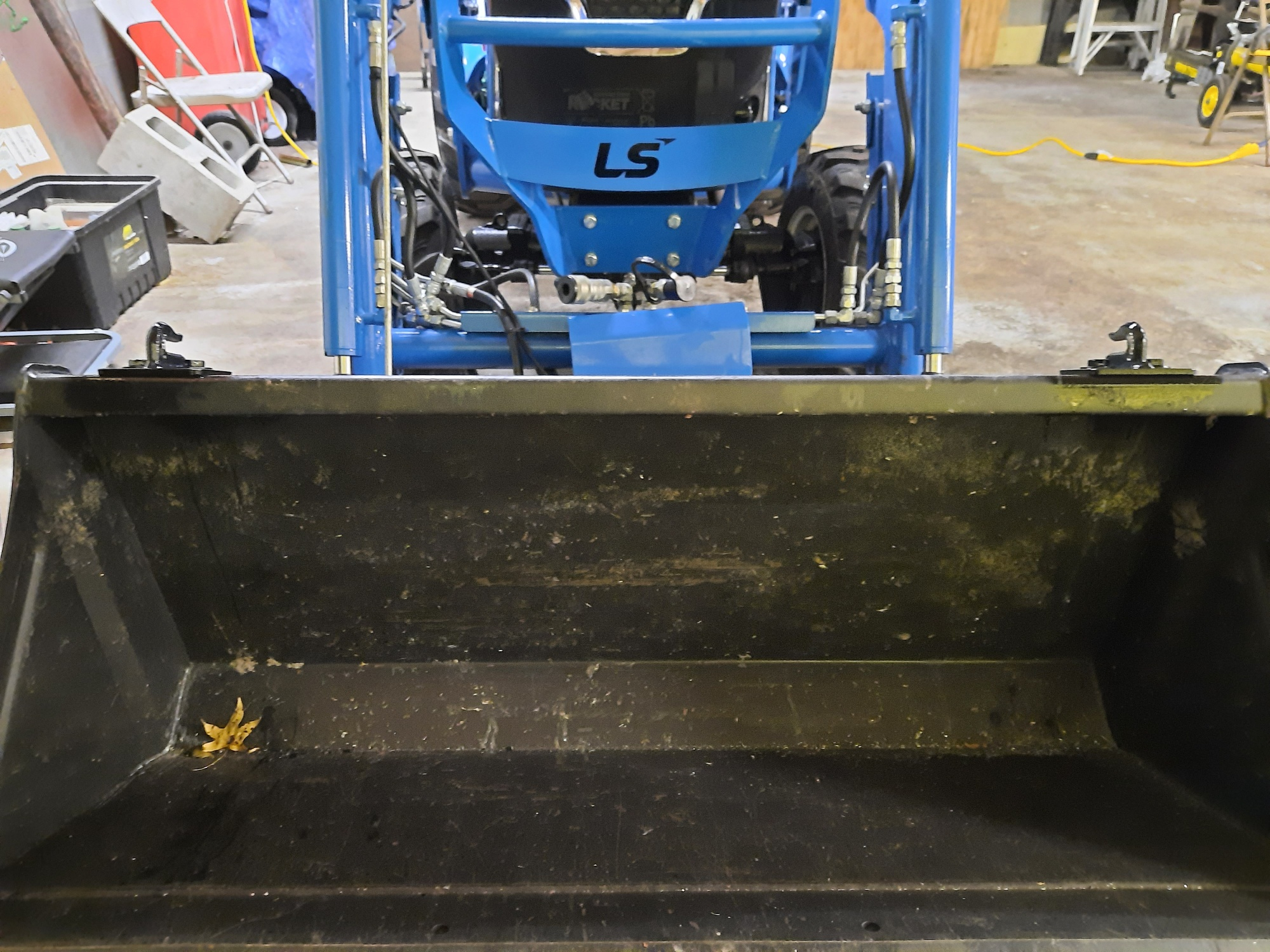

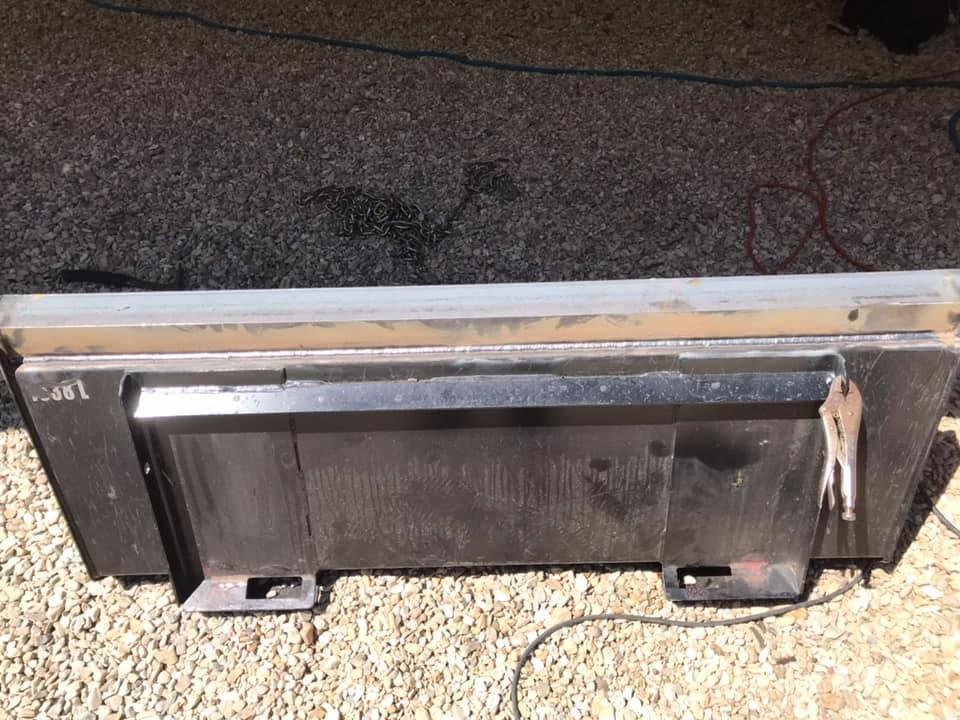

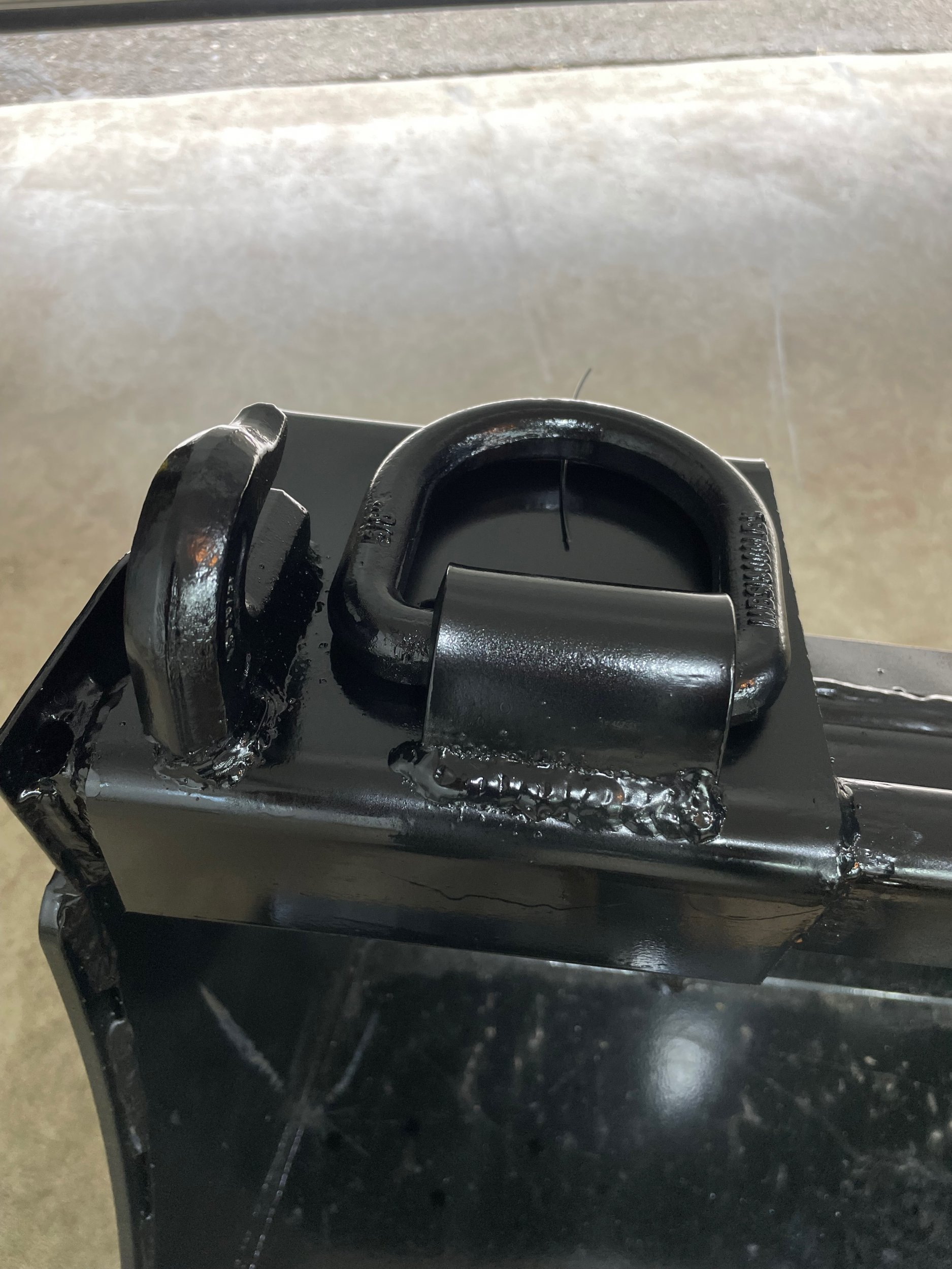

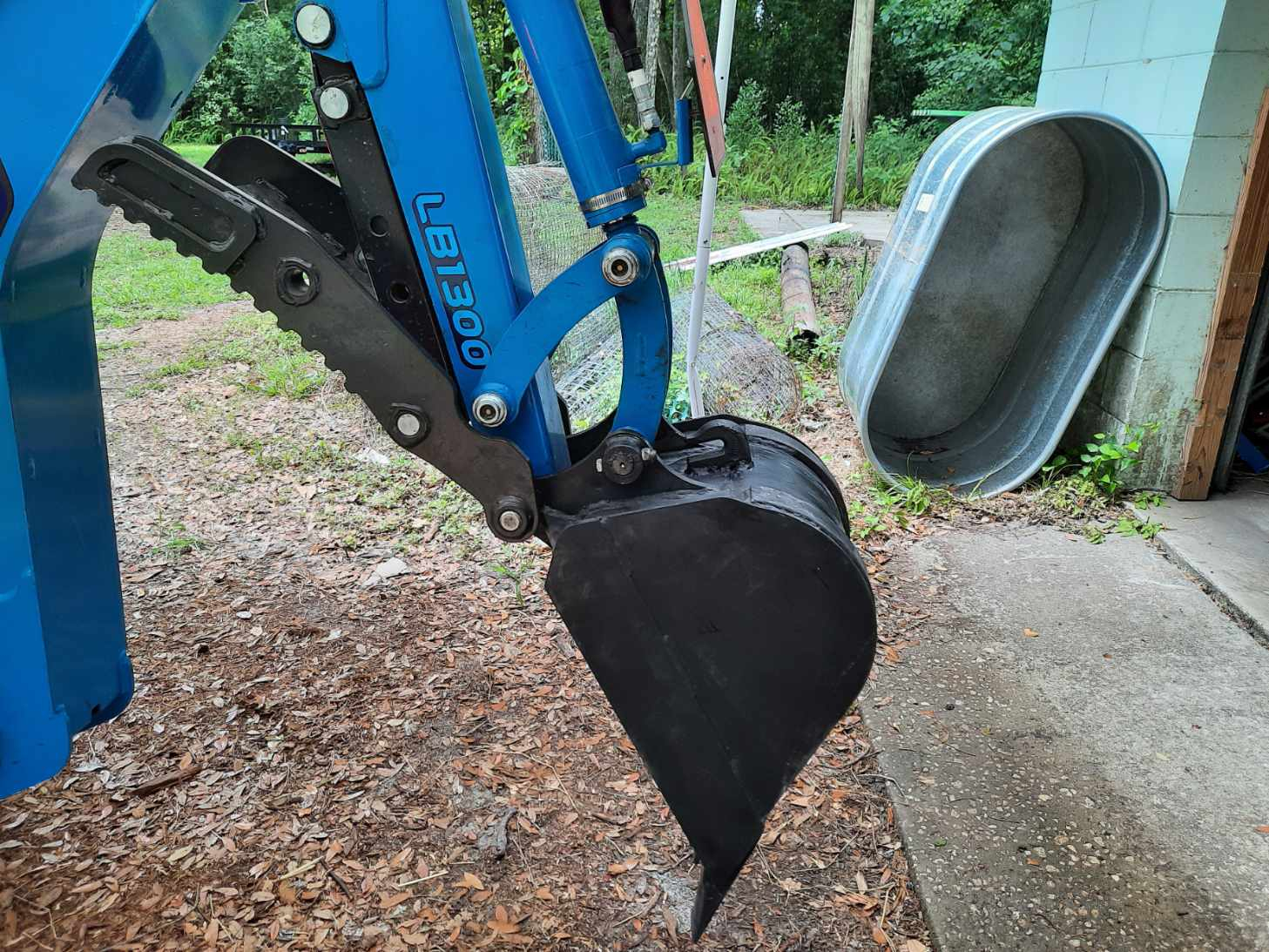

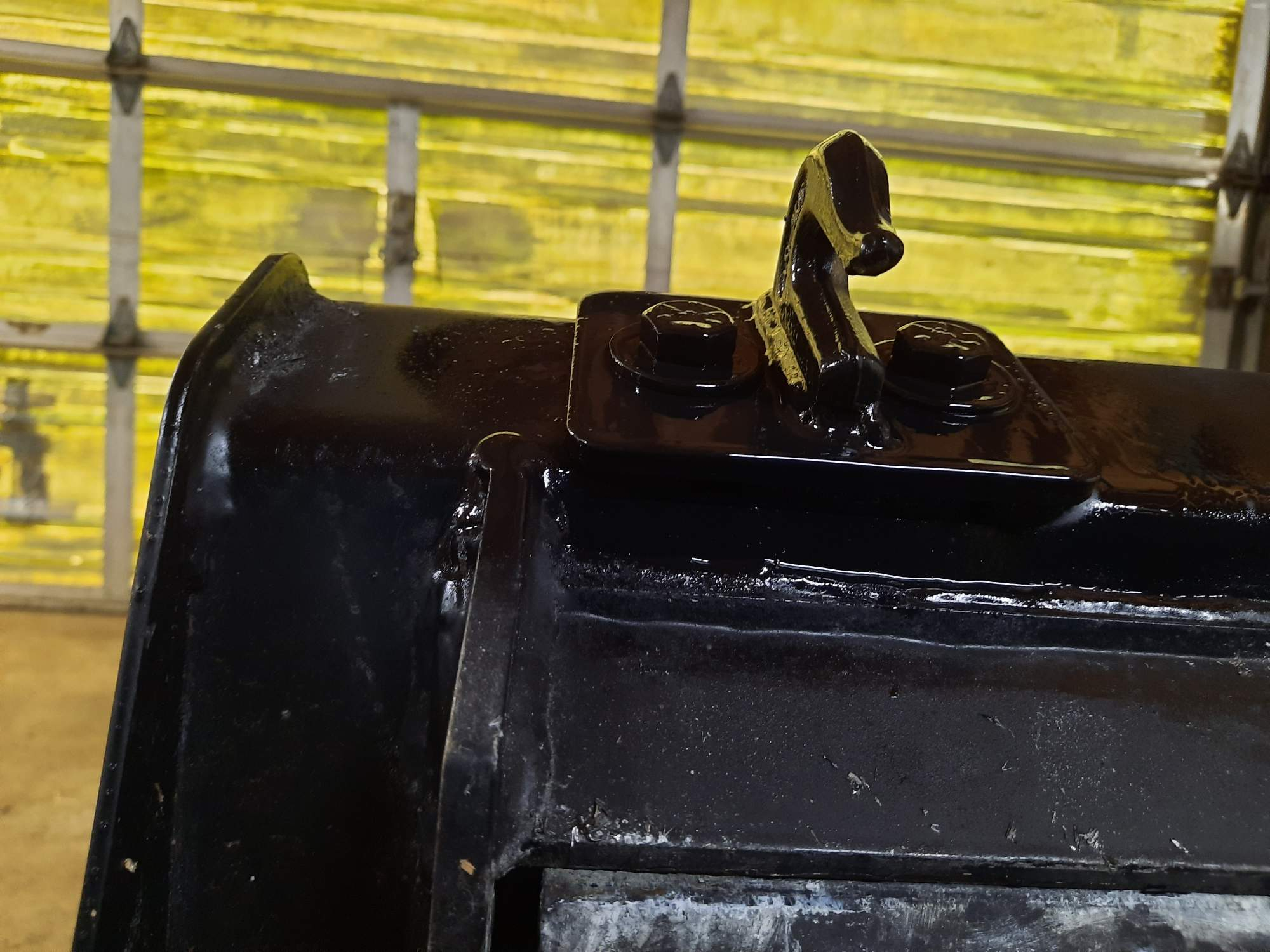

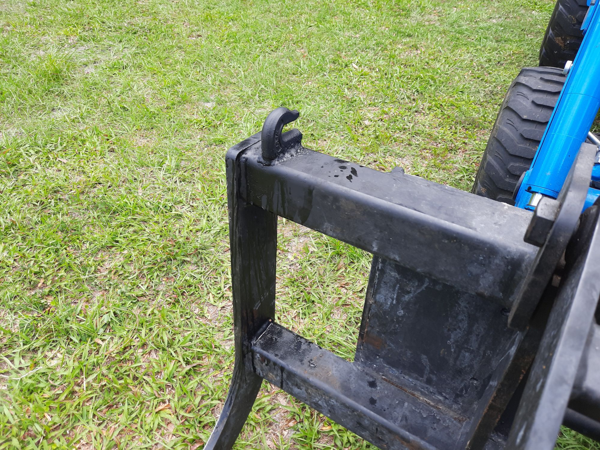

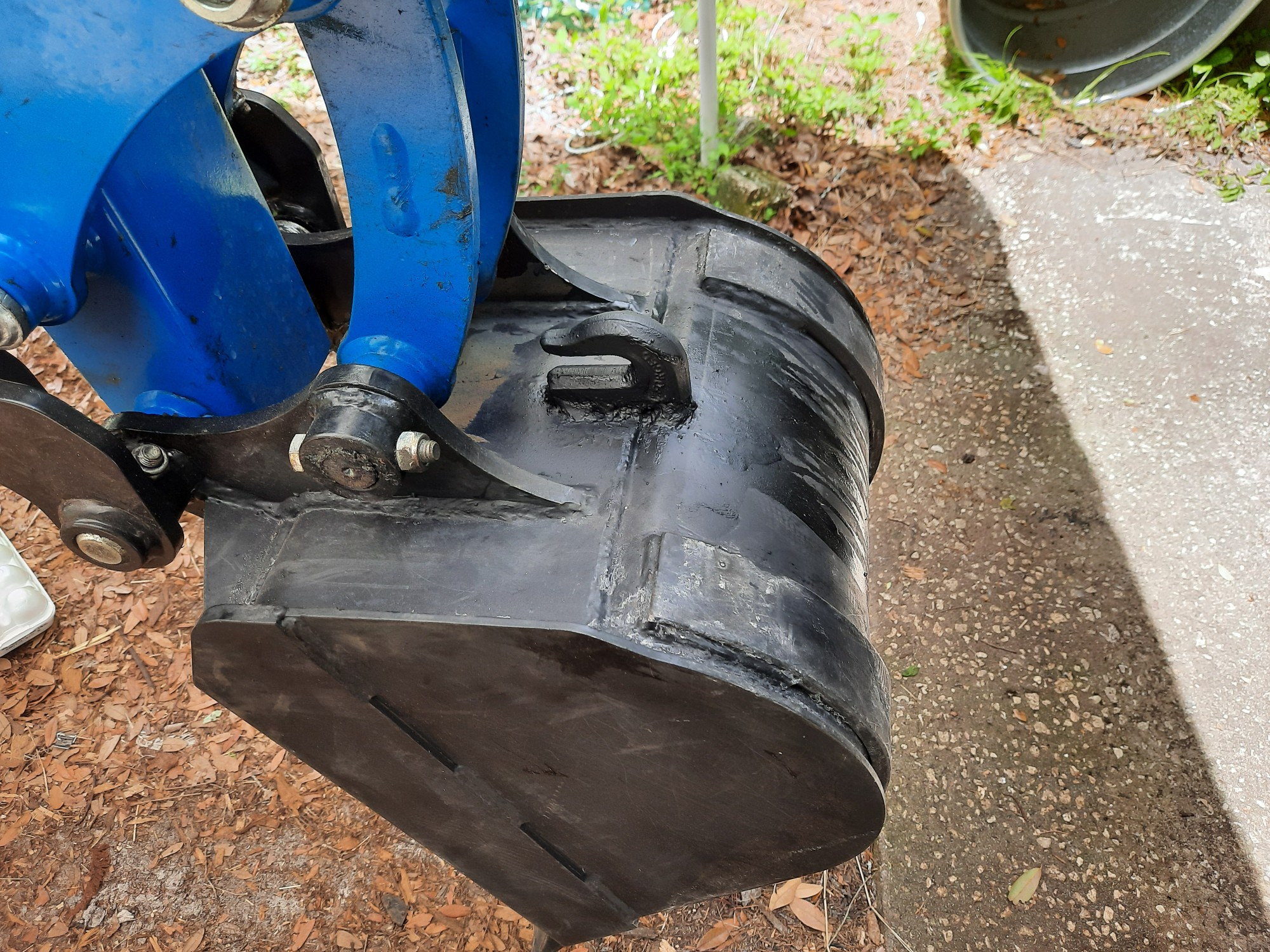

Looking for ideas / user pics of how and where to mount some chain hooks and D-rings...
The bucket doesn't have wide enough material to bolt or weld to...looking for alternative ideas....
Thx!
/ 1635 bucket hooks #2
1/4" angle welded to top. Weld your bucket hooks to the angle.
/ 1635 bucket hooks #4
Can you post pictures of the bucket? We may have a Bolt-On solution, of corse we sell lots of Weld-On stuff too.
/ 1635 bucket hooks

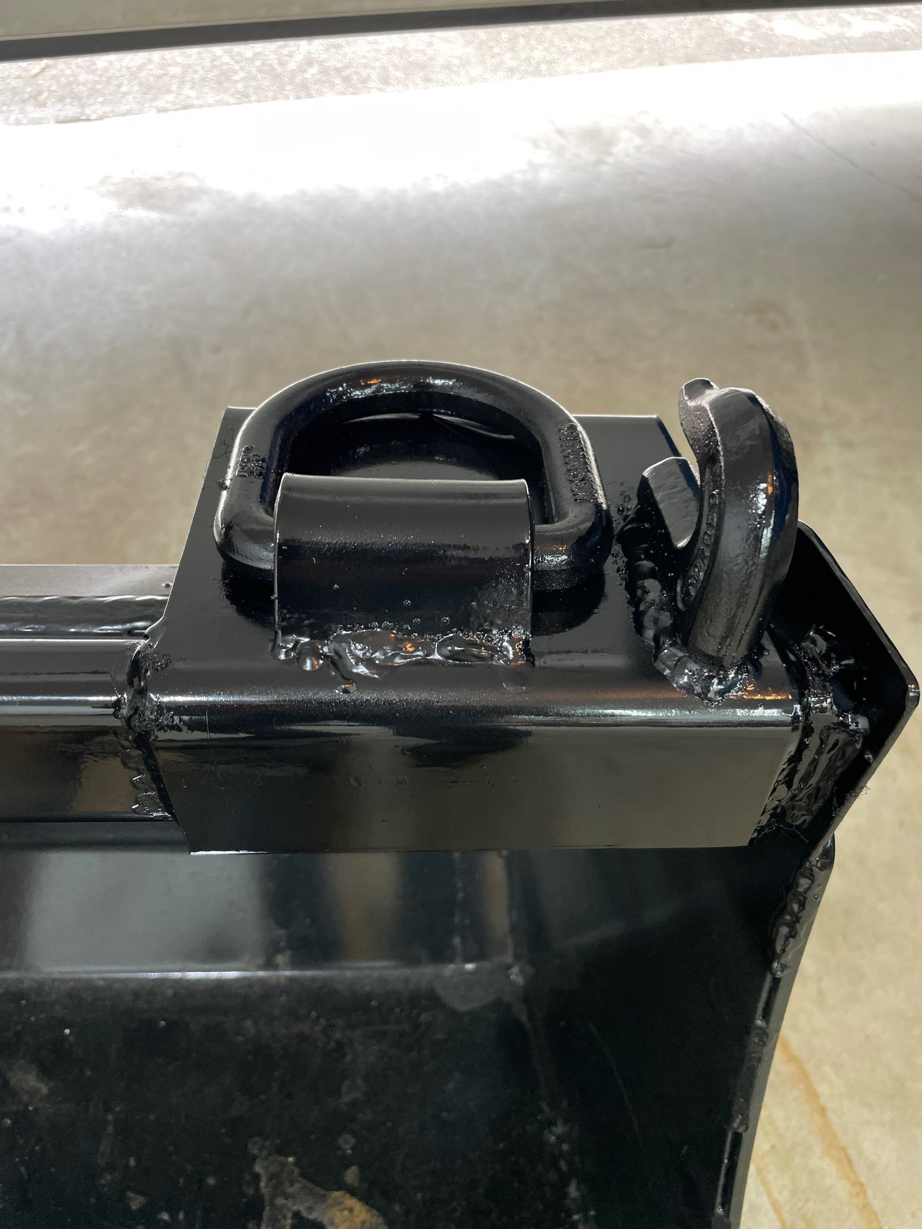

/ 1635 bucket hooks #6

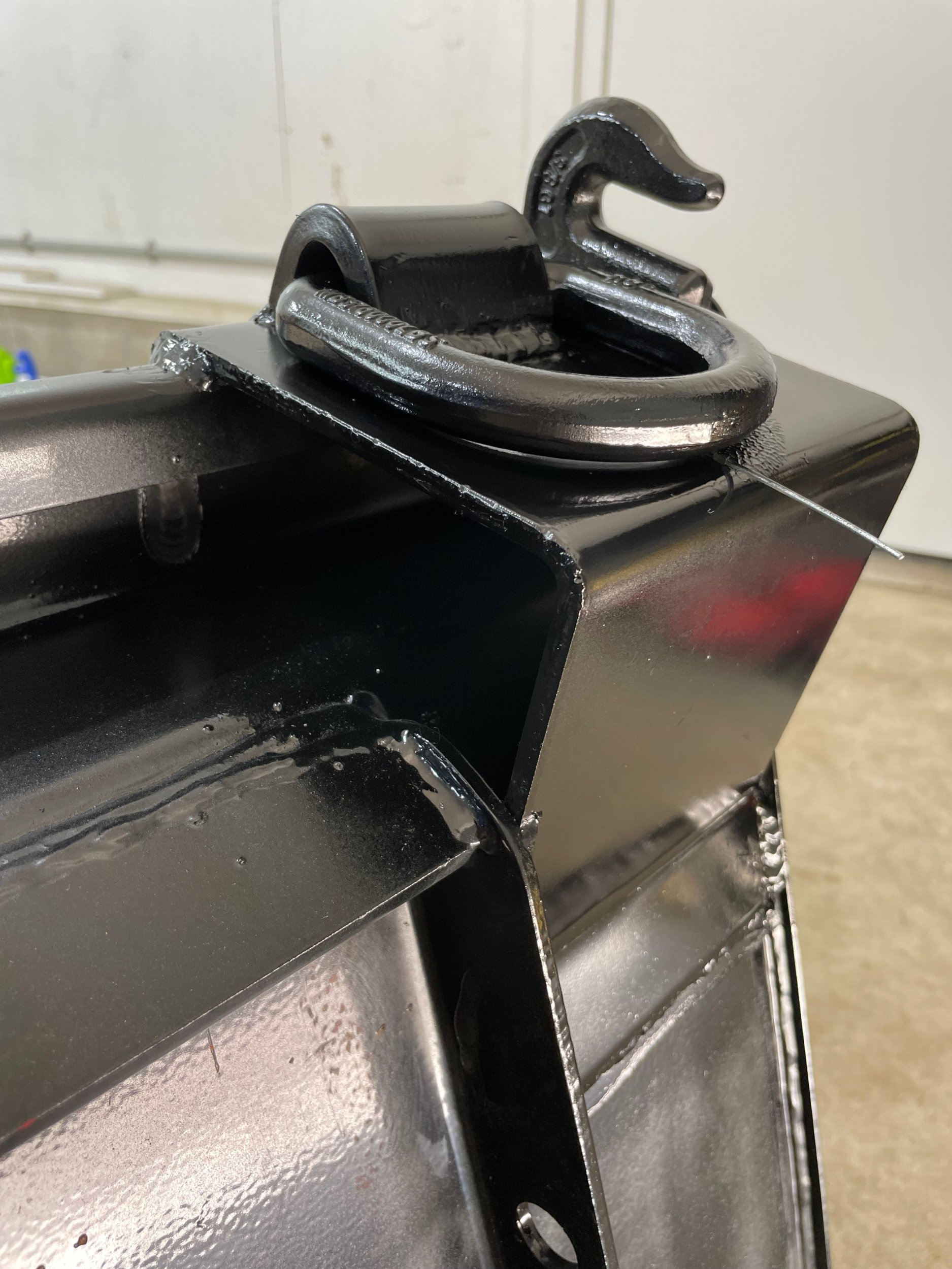

This is what I did. Weld & bolt on.
