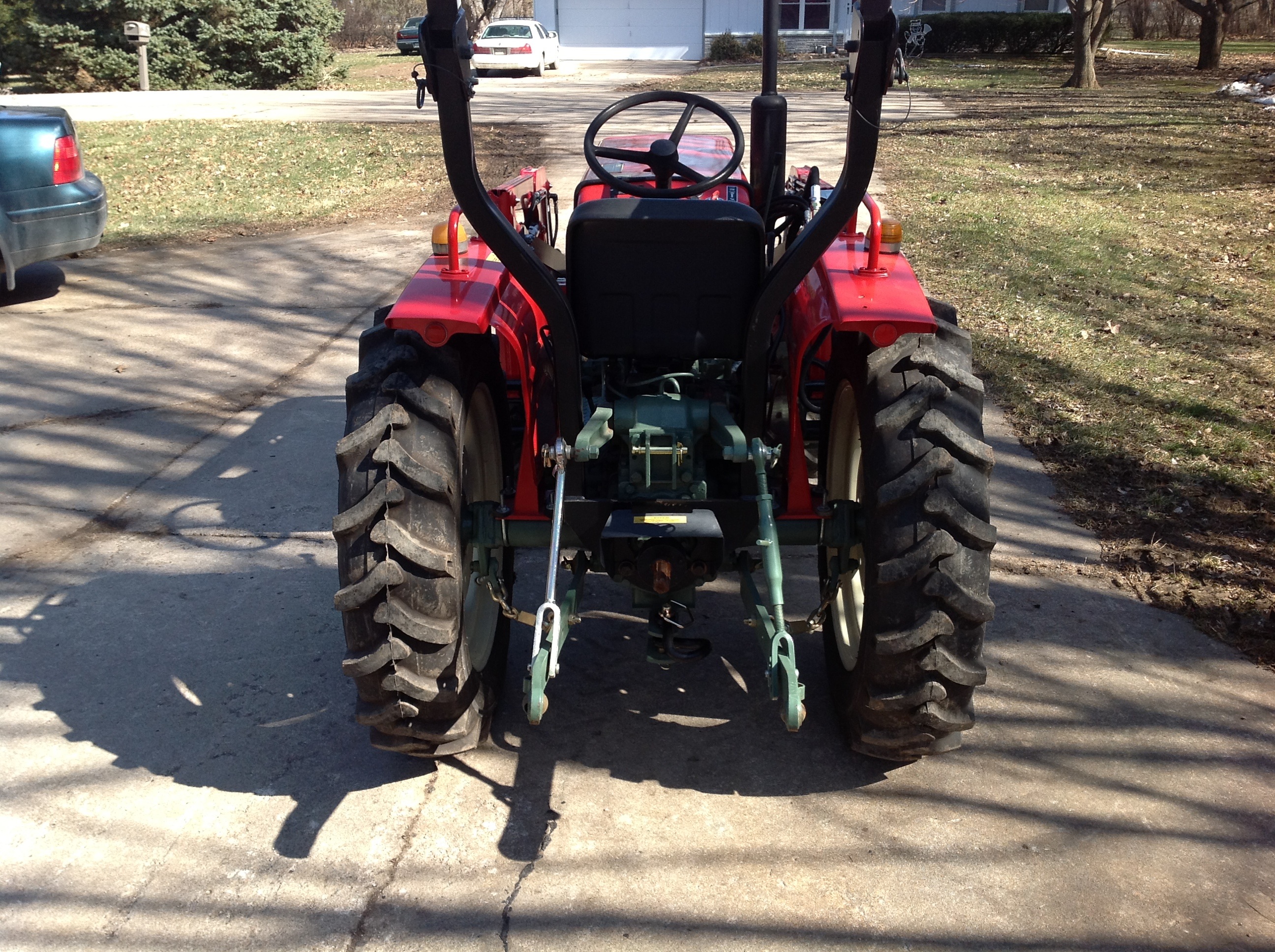

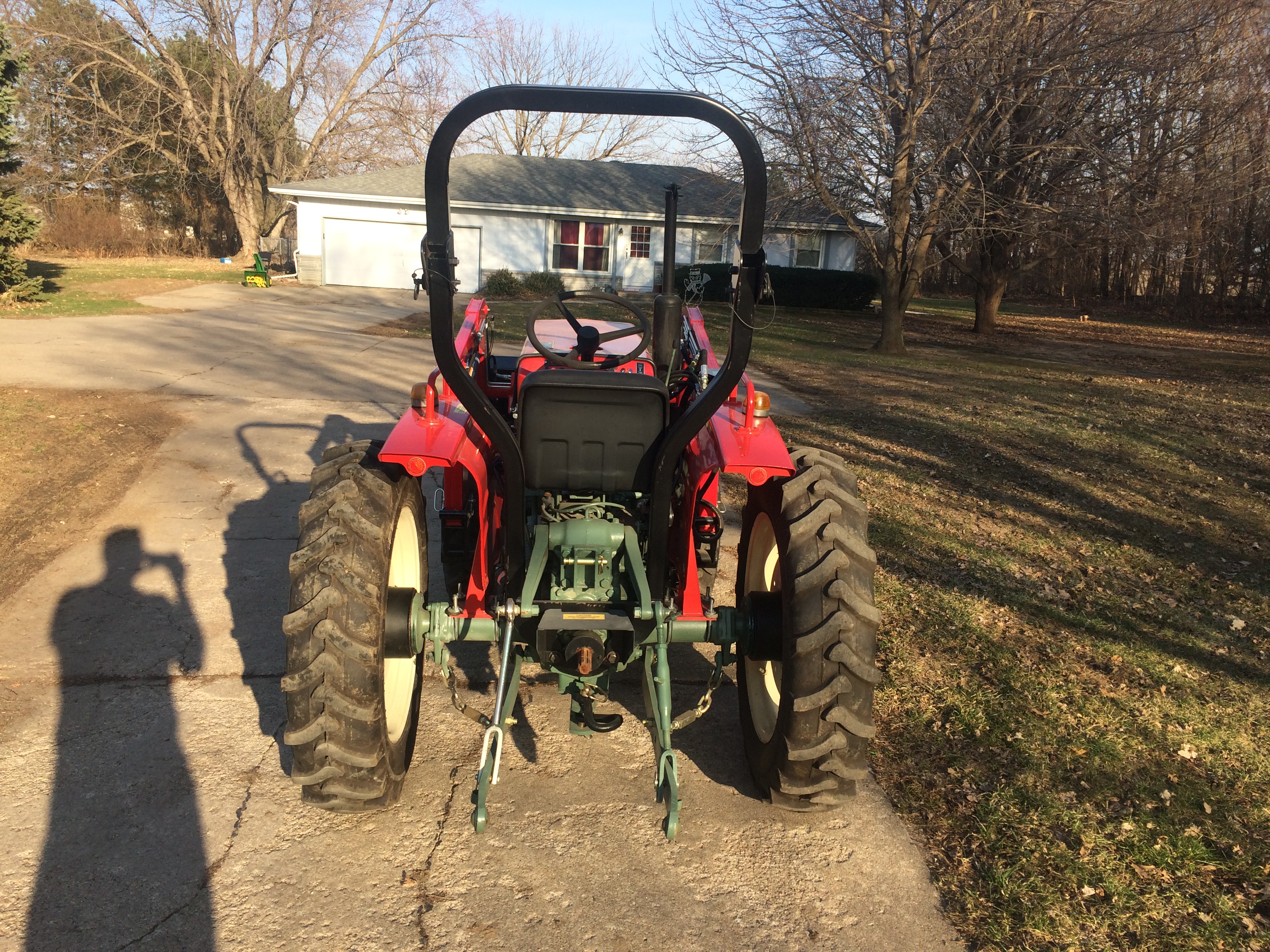

Just a bit of info for folks who may be wondering about dishing out the rears on this model. Before swapping wheels the lug-to-lug was 44", afterwards is 49". Very noticeable improvement just puttering around. The ride is smoother as well, which really contributes to the stable feel - before it wasn't so much the slopes that gave me the jibblies, it was every rut and molehill bucking the thing around on top of that :dance1:. Wider stance definitely calmed down the ride.
   / 1610D rear wheels swapped #2
I remember that feeling of the jibblies that you are referring too when I first got my 2210d. After I put on the wheel spacers it made a huge difference, you can see the before and after pictures here. 2210d no spaceer.JPG 2210d spacer.JPG I never measured the distance before and after though, maybe I should have, but the ride was much better that was for sure. Now I have my turf kit on there which made a big difference too, lower to the ground and more surface contact as well as wider and is a nice ride as well.
