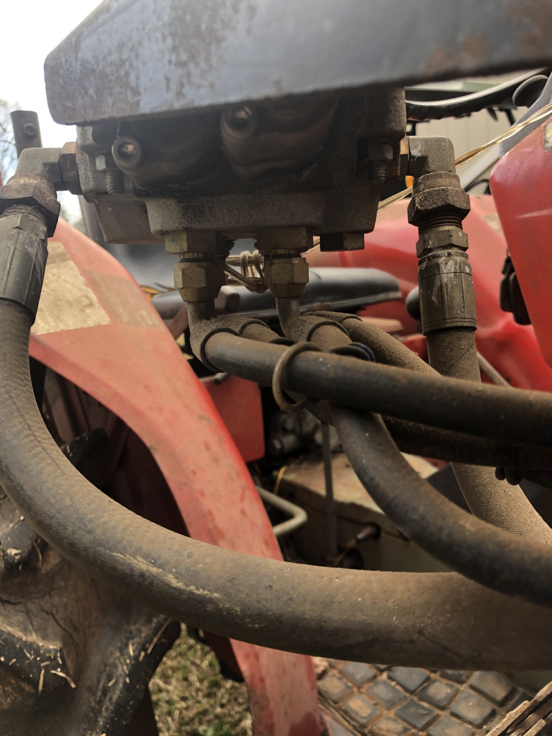

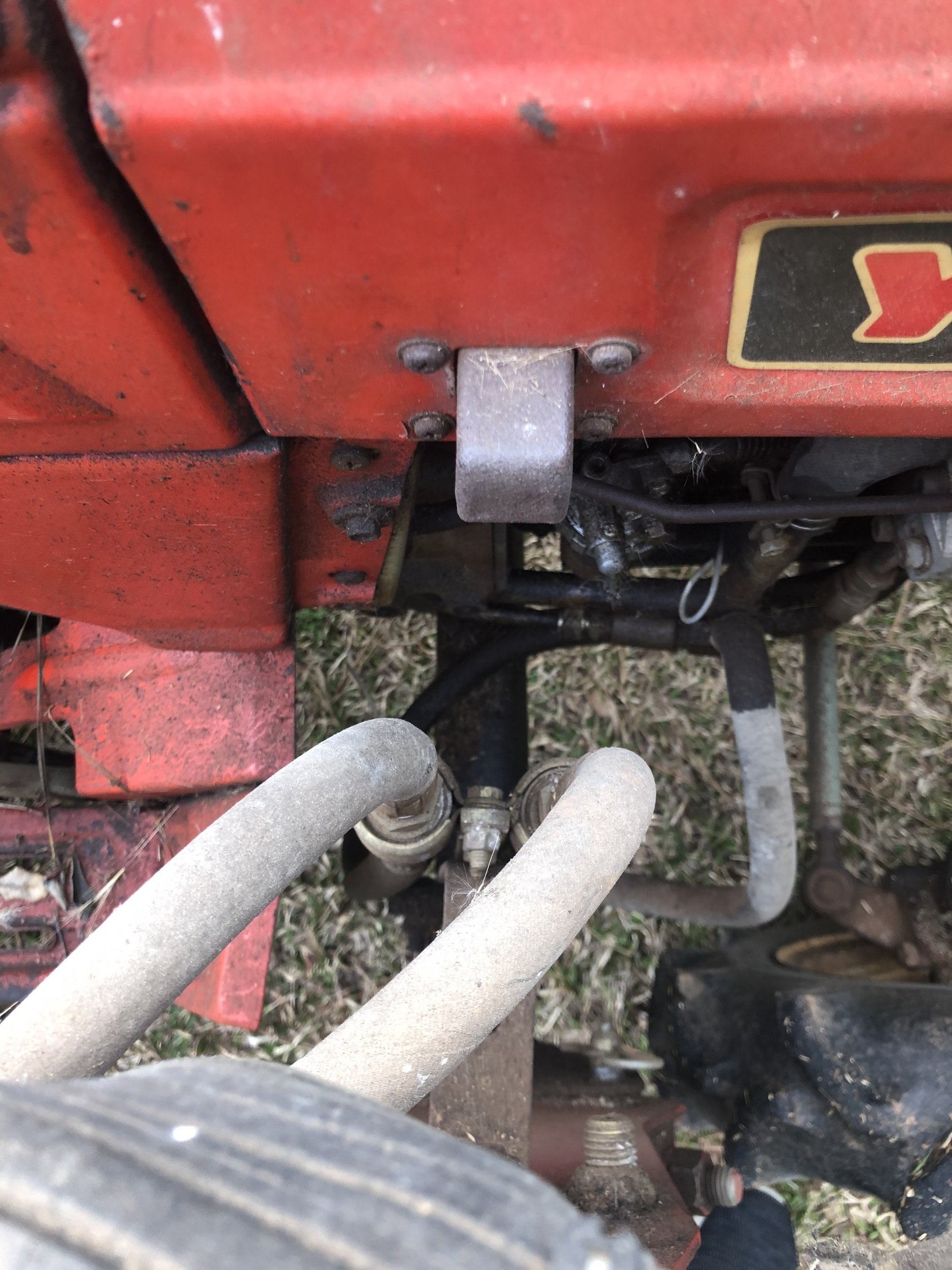

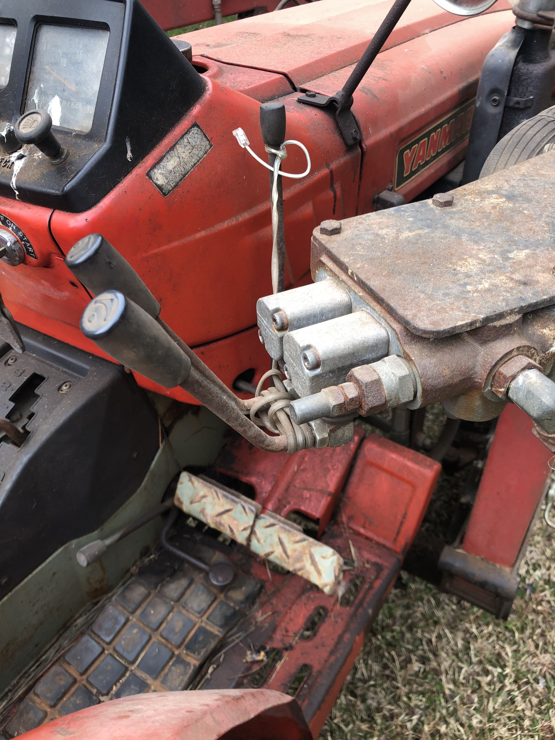

No manual. As I understand power beyond, not installed. Just two hoses from the engine to the FEL control with 2 levers, one for lift and one for curl. And no power steering. Pretty sure this one is a stock rice paddy tractor.

Also, it looks like your loader only has a supply and return. No power beyond. I would assume one hose is coming from the pump....where is the return hose going? If it is going onward to feed your 3ph it really should be a power beyond circuit.
Who installed the original loader? Not having a power beyond can be the problem. Because when raising or lowering the loader....the oil that is expelled out of the cylinder has to return to tank through the tank port. And if you are using that tank port to feed the 3ph that should be fed from a pb....you are trying to force that oil through the 3ph valve also. Which could explain why the 3ph is now having an effect on loader performance
