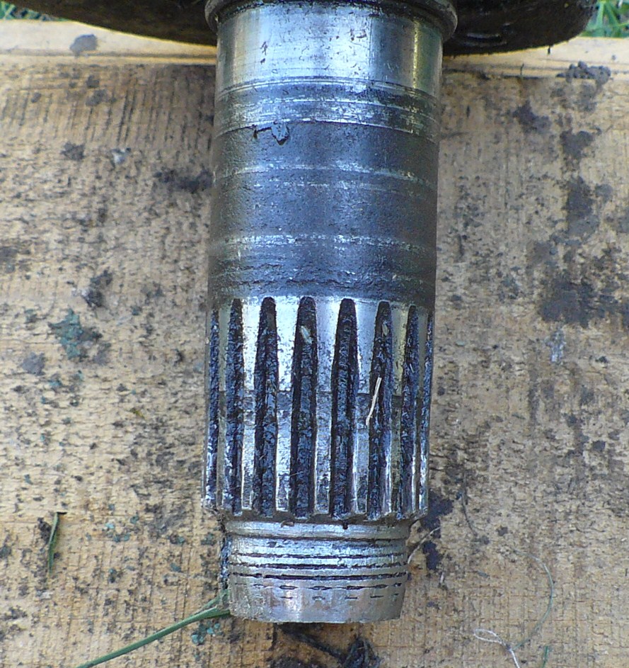

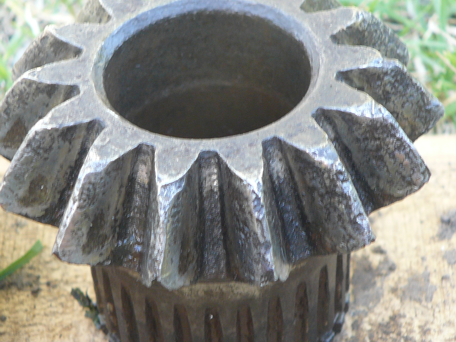

Hi guys,
Here is an update on a prior post I made about obtaining no longer available gears and the rebuilding of the lf stub axle & pinion assembly on a 1610D I just purchased used. (not a "new" refurb) Also, let me say that I am a novice when it comes to all things 'tractor' So some of my assumptions & observations may be flat out wrong or, a--backwards. So please, feel free to educate me.
I'll break this down into 2 parts: the repair; and some questions & observations about same.
First off, I was able to obtain very good quality salvage gears and sleeves from Hoye and an offer of the same from Danny1. The rest of the parts needed including, the spindle and stub axle are availible new & were purchased from Hoye.
Total cost of parts for a rebuild of the left pumpkin/knuckle from the bevel gearcase bevel gear down, = $841.36 + shipping. w/an additional 500.00 + for service & Parts manuals, 2 frt tires, voltage regulator, valve cvr gasket, some decals and shipping. (ouch)!:eek:
The actual repair; if I did it correctly, was pretty easy. As the front drive and related components are in sections, easily accessed & can be removed and repaired one at a time.
I started from the pinion down in case I needed to shim and adjust free play as i went. only gear I found that seemed to need shimming was the final gear on the stub axle. I shimmed it to where there was a slight amount of free play between the teeth of it and those of the gear above. I'm hoping that's all that was needed? if I missed anything let me know as I have no previous experience at this.
I used a hammer, and the old final pinion gear and stub axle sleeve as a driver to install the new bearings onto the stub axle and into the housing. The pinion bearings were not as hard to install and only required light tapping with a punch to seat them onto the ring gear & pinion and into the housing. The knuckle seals also were easy to remove and install. Having a parts diagram made assembling the parts in the proper order easy.
After getting everything installed and reasembled, the hub felt good, had no play in or out, & all gears turned freely. It has been 3 days since the repair & I spent some time mowing on a field with no noise or leaks. I plan on pulling and re-inspecting everything later. Below are some pictures of the drive parts I replaced. It is hard to see how worn these parts really are as they dont look too bad in the pics.

There is normally a slot in the housing that the oil can pass through. If not, you can pop the seals out of the bearings. They just snap in.

Aron:
Thanks for the reply I did not know that. I will go in later and pop those out & look for a possibly plugged up passage in the housing. That will save me from having to go thru all those fill steps.
re-reading my post, it is kind of long & tedious to read lol. But I was worried I may not have done it right and did not want the expense of having to do it again later.
