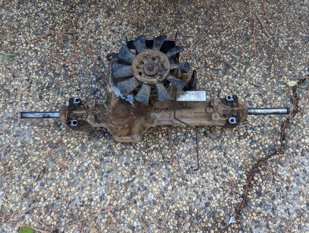

My ~15 year old riding mower/tractor - Sears DYS4500 54" (917.28690) - has been having a harder and harder time getting moving lately. I likely overwhelmed it pulling a dethatcher with too much weight on it, but regardless, it's had a pretty long life so far so I'm not too surprised. Last time I went to mow my lawn, pushing the go pedal made noise but no pull at all at first; after a little while it finally consented to move the tractor around.
I pretty recently replaced the drive belt so I'd be really surprised if it's that, especially as it did eventually drive.
I looked up the transmission part and it's a K46BT.

Your transaxle may be low or out of fluid. There should be a filler cap on top but no place to check the level. You could try adding a pint or so of 85W90 or 85W140 gear oil. I drilled a hole in mine and added a hydraulic jack plug just below the case split line on mine to check fluid level.
   / ~15yo riding mower/tractor tranny likely dying #3
Yep, take the trans axle out and pull the vent plug and dump it into a 5 gallon bucket. Reload it with 5w-50 synthetic and it (might) work again.

Looks like a couple bolts inside each rear wheel is about all that holds it, so I'll pull the wheels, belt, connecting rods and the bolts.
I'm not too hopeful as when I disengaged the drive to move it there's shuddering likely from the gearbox, I'll probably be splitting it to look inside...
It will do that if low on fluid. Get a suction gun, looks like an old timey grease gun, and use it to get old fluid out, instead of removing rear axle. Some had a filter, so get one if yours does. Mine is 22 years old and abused regularly. I hack down briar thickets with it. Yours should be fine, just fluid.

I pulled the tranny and am draining the "oil"... It's dirty rusty milkshake...
I've got some T6 5-40; in the spirit of continued abuse I'll put that in it instead of buying 5-50. I figure if I fill it and it's still crunchy (when trying to spin the axles in the same direction together with the drive disengaged), I'm just taking it apart anyways.

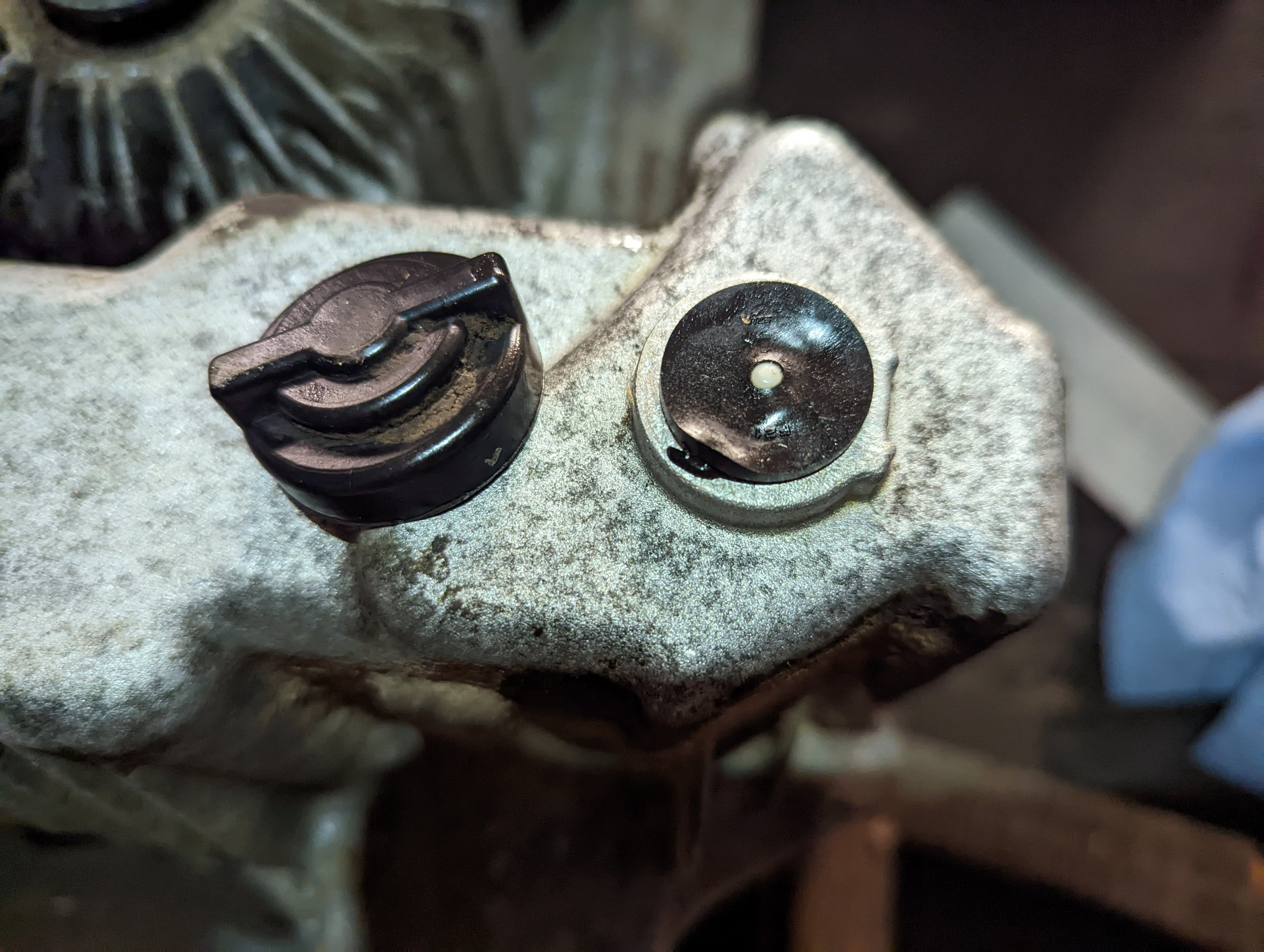

After refill, I used a drill to drive the input shaft and got it purged and then it seems to drive the axles properly without extra sounds (at least not that I can hear over the drill). With the drive disengaged, I can rotate the axles by hand with what sounds like "normal" gear noises.
Last questions:
1 - the filler plug came detached from its cover (first pic; bigger black thing is the cover and isn't attached to anything any more, it used to be attached to the plug). I assume the filler is also a breather, so it's probably important to have a proper cap? Should I get a new plug & cap? If so, where - would a local lawnmower fixer have something like that?
2 - what's the other flat black plastic thing (second pic)? It looks kinda cracked; should it be replaced?
