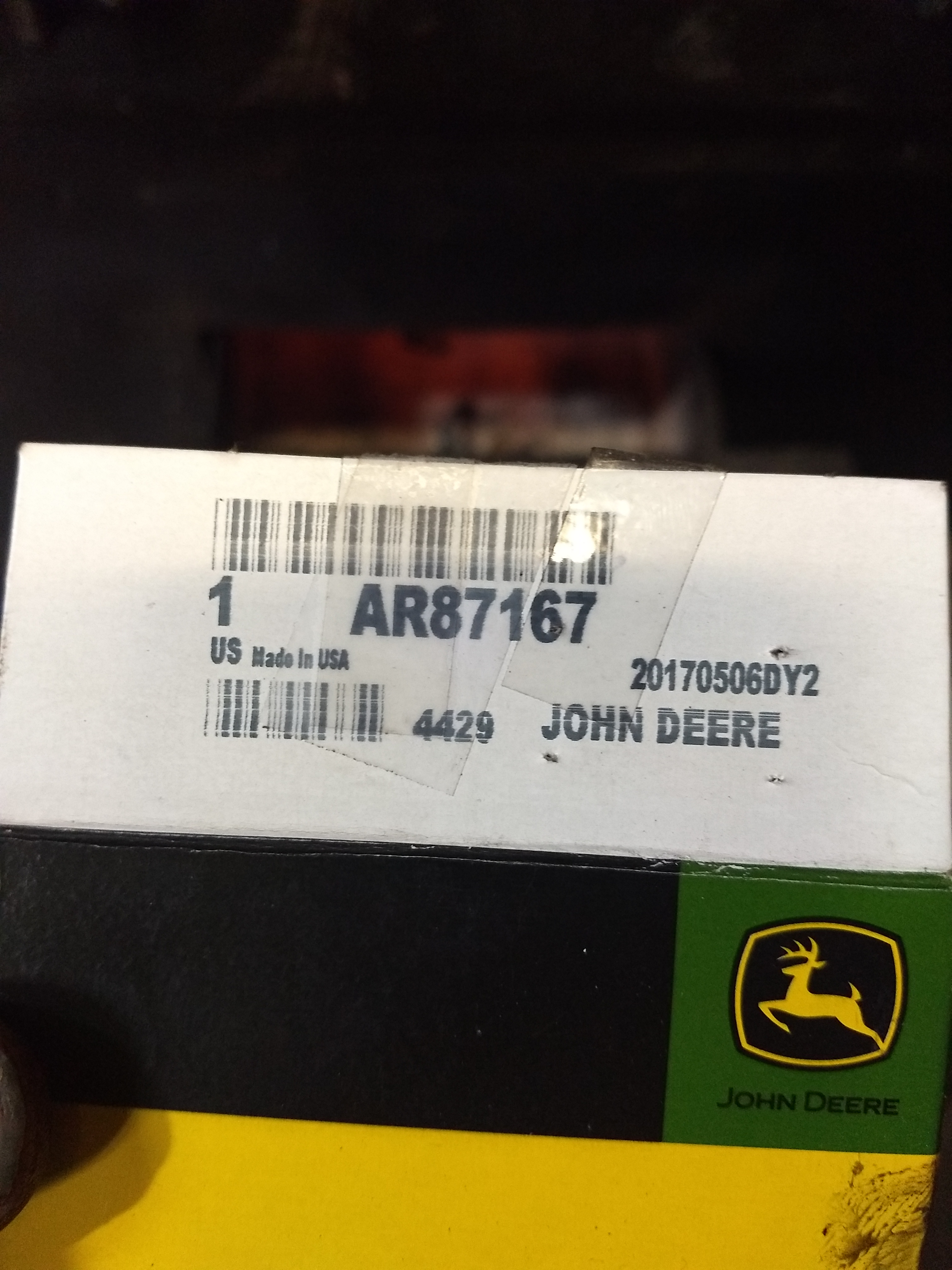

Just wanted to give anyone who cares a bit of help on a block heater install. I work for a Deere construction dealer and the PN AR87167 fits these 2 cyl tractors perfectly.

Where did you install that heater? I don't see any threaded ports on the engine we have here.
Edit: Haha- I found it! Someone has filled in the threaded hole on our block & ground it down. Looked pretty good. I didn't even notice.

Installed it today. Warmed up the lower hose in about 45 minutes.
I emailed you guys^^^^ last week about buying one and never heard back. (No big deal) So I looked up any of the small compact utility tractors I thought had this engine and one for a 650 jd works great.
