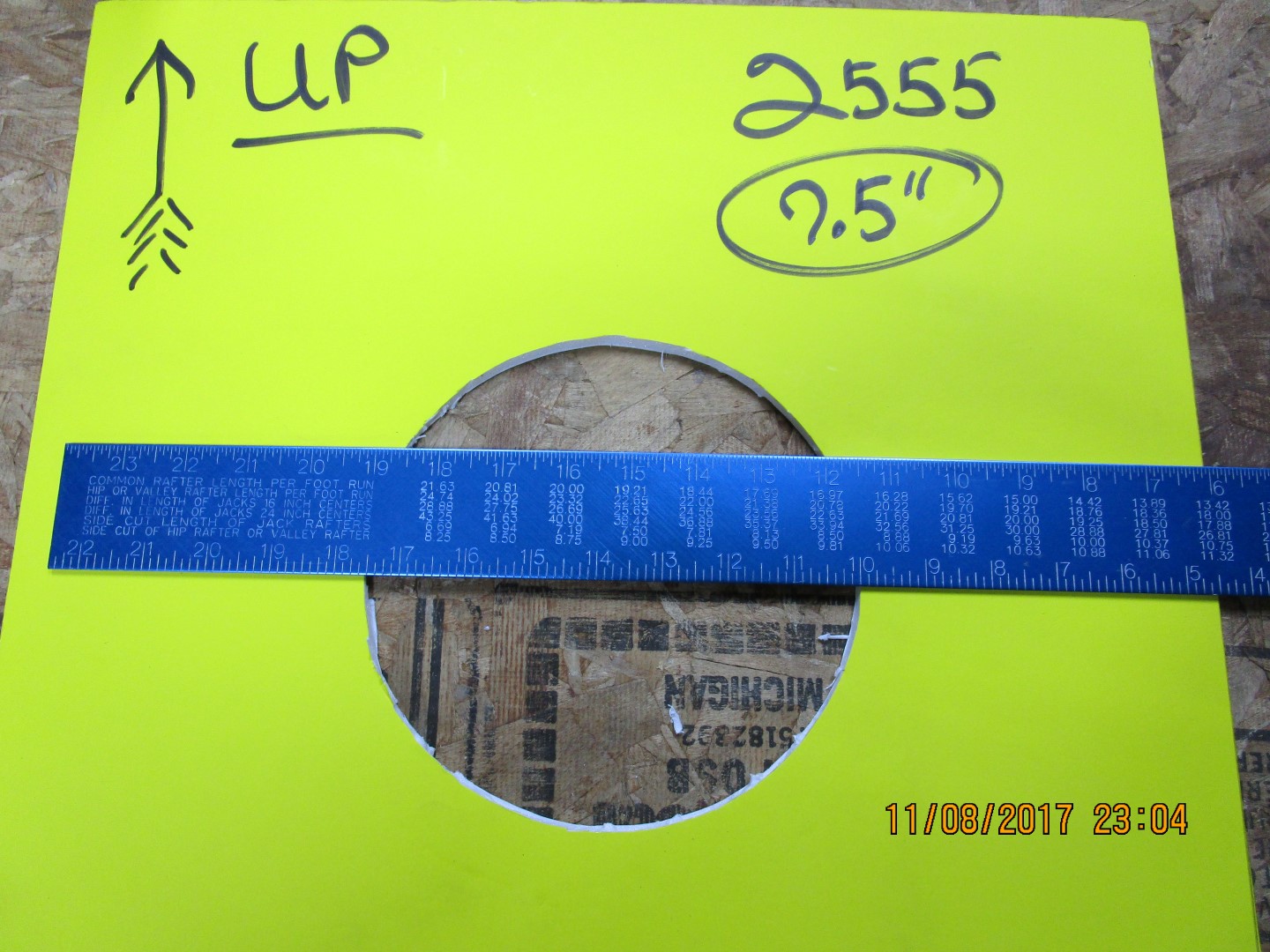

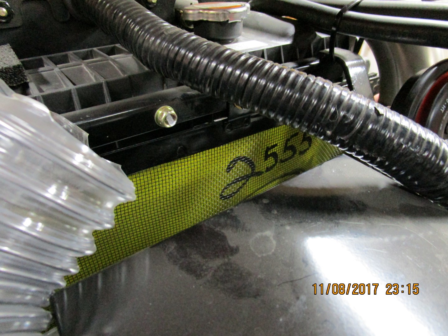

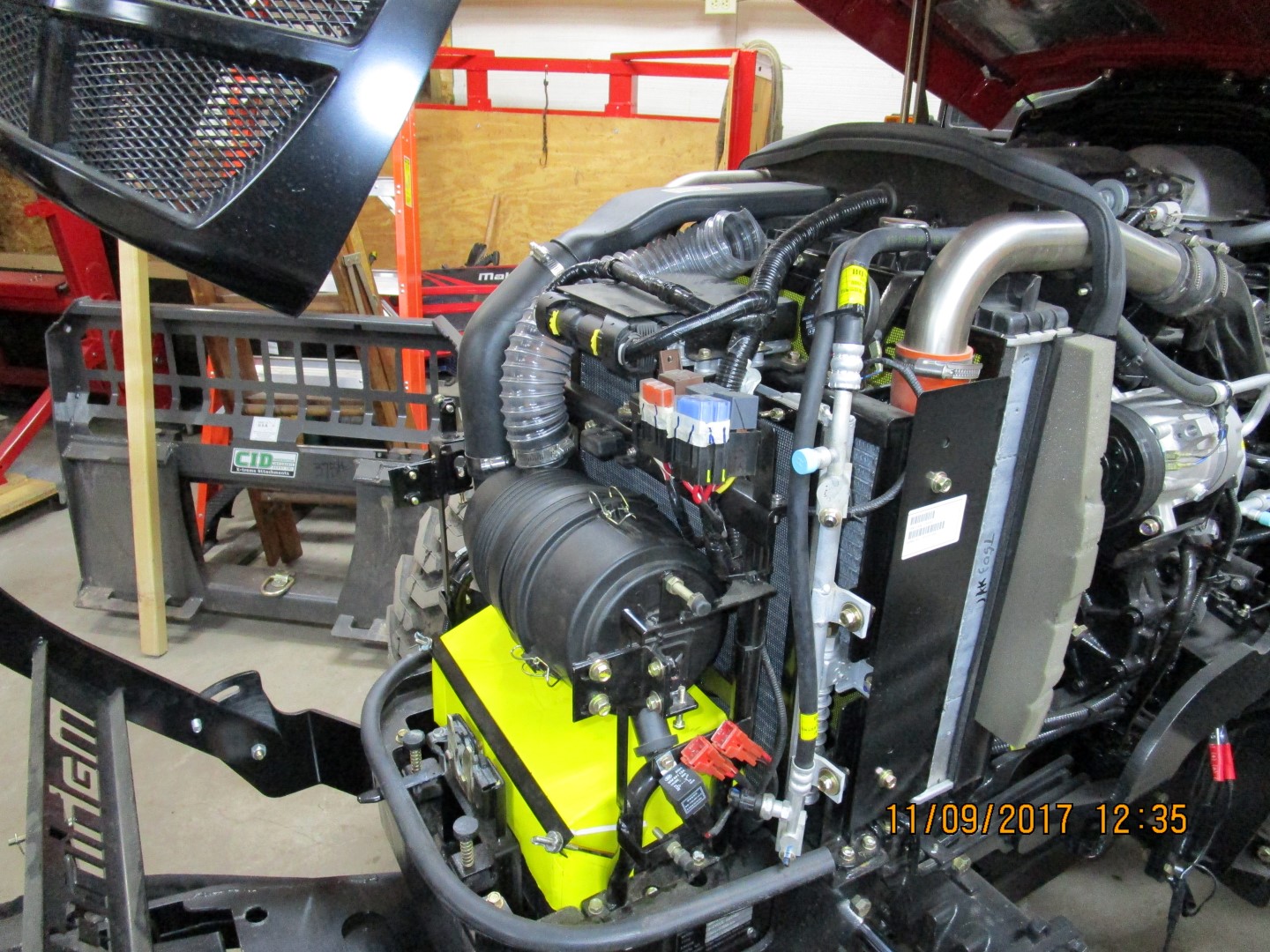

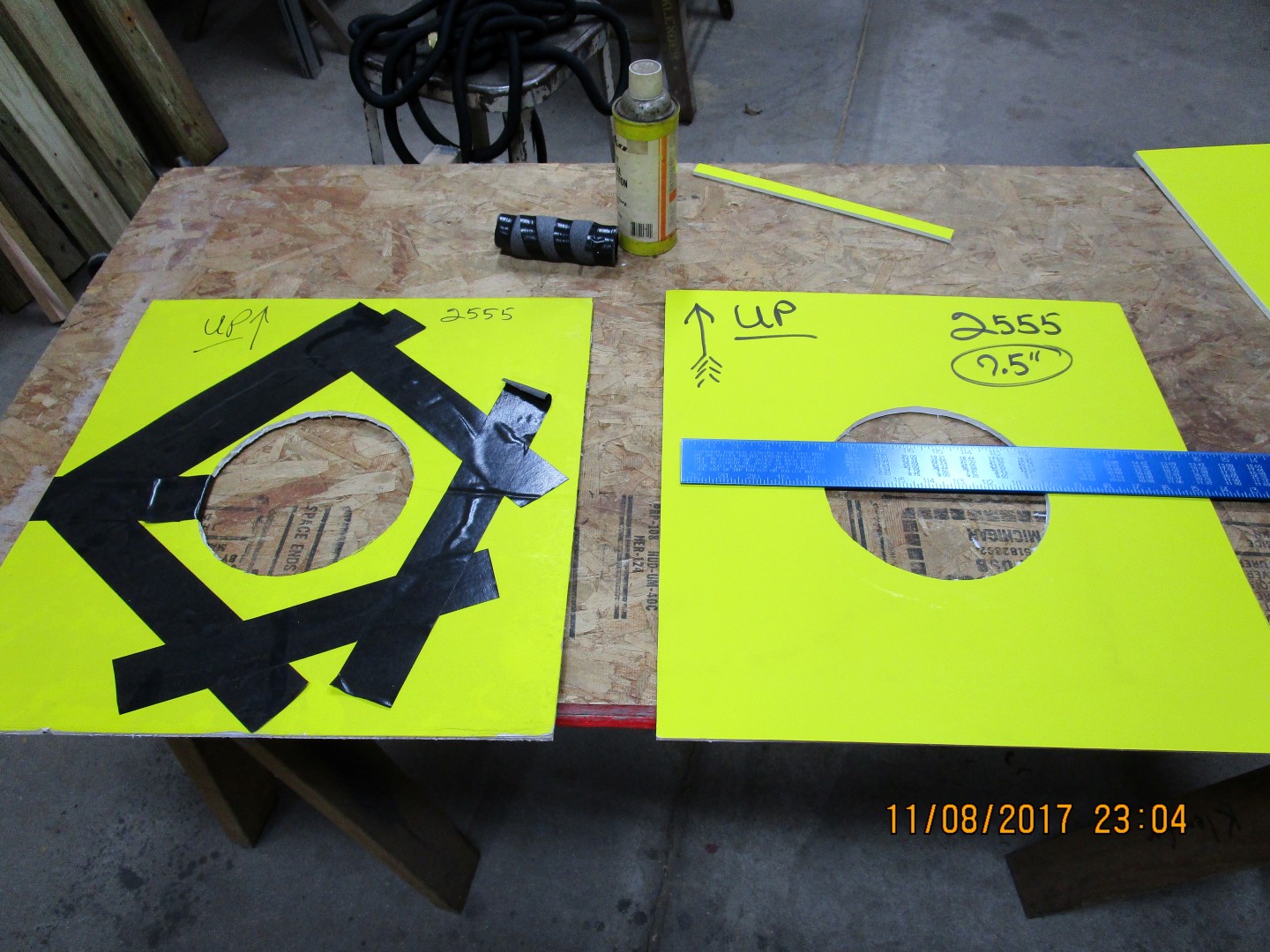

You should check you coolant temp and see if it is coming up to the proper temp. I have to run a sheet of plastic with a 9" hole in it in the winter on my 2555 even at PTO RPM blowing snow. If you get the engine up to normal temp, then your smoking will probably lessen/go away even at lower RPM's. Lot of diesel stuff, especially some of these Mahindra tractors, have coolant systems built to keep the thing from burning up when it is 90 outside and you are working the krap out of them. That same cooling system is hard pressed to work on a tractor you are just putting around [ in tractor ' work ' speak... :) ]
/ 1538 smoking #8
Here is a rebuild of last years 2555 radiator airflow limiter thing.... [ maybe Santa will bring me a heat activated/clutch or electric fan fix... ] Started with a 10.5" hole in the original, then cut that size down to 7.24" to run the rest of the winter. Made a new one this year with a 7.5" hole to replace the cobbled up one I had. [ Wally sign plastic is only $3 a sheet ]. You can block the thing entirely, or even remove the radiator fan blade, but the more you do the more you have to watch your coolant temp so you do not overheat the motor. Until your motor coolant temp gets up to where it is designed to operate the thing can smoke, and actually is bad for the motor, too. The 10.5" would hardly let it come up to thermostat opening temp unless under load. The 7.25" got it up to temp like in the summer, and was not too much that the thermostat could not regulate the temp like in the summer. This is on a 55 hp turbo running a 78" snow blower, and still needs the help getting up to temp. Note that the hole is centered on the fan, and not exactly in the center of the radiator... 1st picture of the two together, 2nd the new one, and 3rd it installed in the 2555.... 4th one... winter battery shield made with left over plastic, keep battery from being packed with snow... Note also, air intake hose added to get clean air from up under the hood instead of packing the prefilter/filter case with the huge amounts of snow sucked into this area by the aggressive radiator fan they put in these things.. [ used 2-1/2" I.D. sawdust duct ] Getting ready for another snow war here in Upper/Lower Michigan .....
