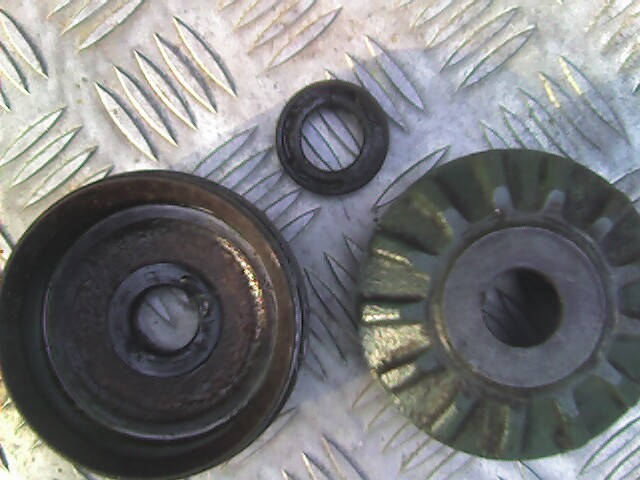

Hi guys,
My tractor had a 6 month warrenty when I bought it. I have been trying to use it as much as possible for these months so that if something is going to break it will. Not abusing it mind you and not working the tractor commercially.
Any way shortly after I got the tractor home it started leaking oil from the front knuckles. I contacted the dealer and he said that he would send me the parts when I knew what I needed. It was not from the big seal between the knuckle halves, but rather the little seal that is in the "Nut" cap that is at the top of the knuckle (#14, 15). I finally took the time to tear it down today and found the center pins (#1), top needle bearings (#), and top seal in pretty bad shape. That is all well and good and the dealer will send me the parts. (I do not mean to imply that Hoye was the dealer--the picture of the parts manual is for reference only. I bought manuals from Hoye, but not the tractor. The tractor I bought in Germany.)
merchant.mvc
My question is this: That small seal in the "nut" was installed, to my way of thinking, backwards. It was installed with the open side (with the little spring) towards the top--that is toward the exterior. I have see a few seals placed in this manner, but only when used as a wiper seal like on a hyd cylinder shaft. The open side should go toward the oil source. Am I wrong and this installation was correct? That the closed side of the seal should be toward the oil source? See attached pic. The "nut" on the left still has the seal. The seal came from the right "nut" and both are facing up as they were installed.
Dzieki,
Mike

Mike,
I've done more than a few seals...and plenty of knuckle repairs. I have yet to see a seal intentionally designed to be installed away from the internal gears, bearings and machined surfaces on the Yanmar tractor. And that particular seals I.D. is designed to statically fit the king pin to retain lubrication inside...and of course, dirt, debris and water from the outside.
You may even want to tear down the other side to see if (IMO) they're both wrong.
Mark

Mark,
Thankis for confirming what I already knew, but wanted confirmation. At least they were consistent--both sides were the same. :D
Mike

My Mits was leaking out the pto so I replaced the seals on it. Same type seals but the inside seal had the open facing in and the outside seal had the open facing out to keep dust etc. out.
