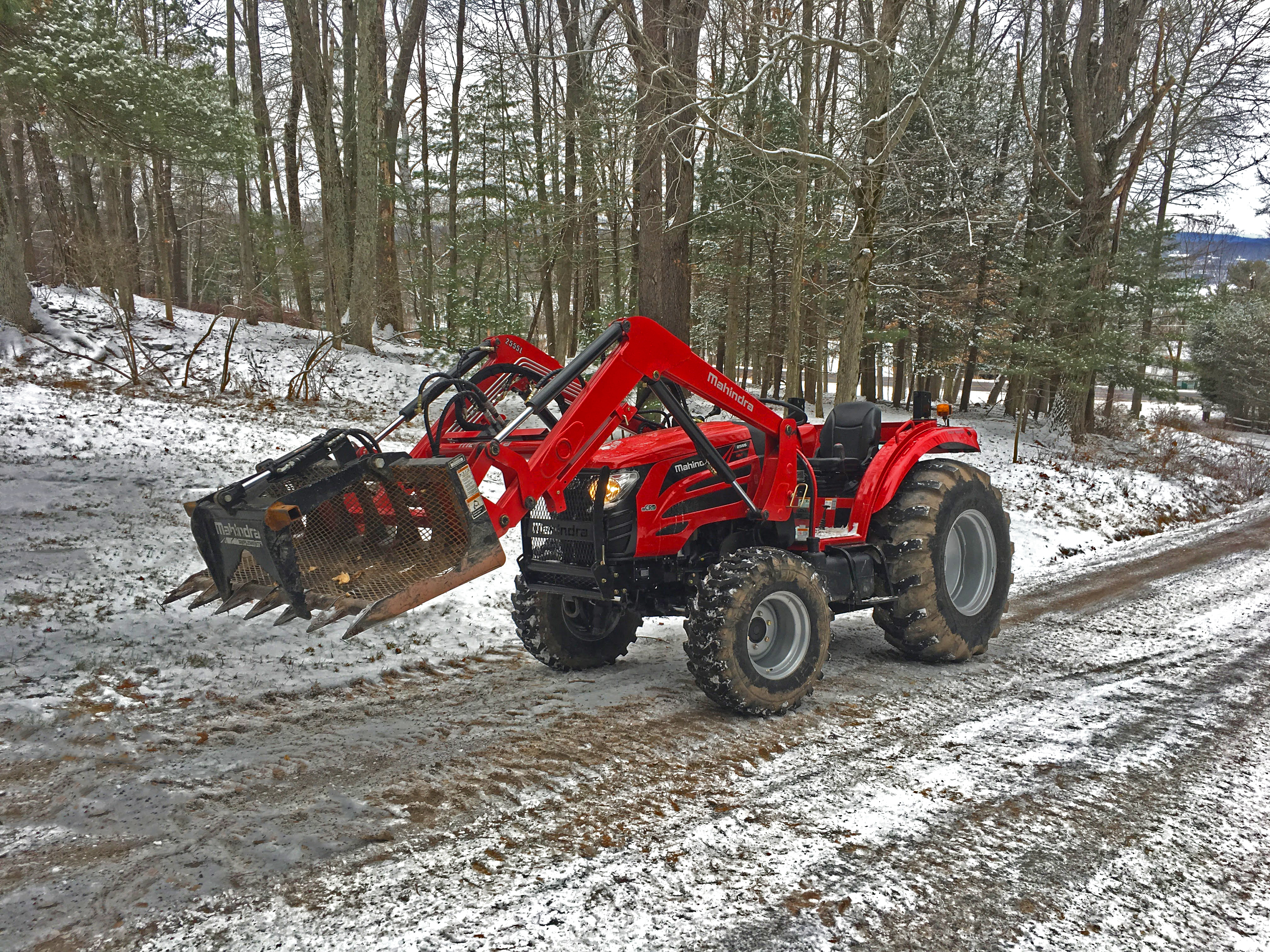

Ok..... I went and did it...... I bought the 2538. Grapple, box blade, finish mower and rotary cutter.........
Thank you to everyone for the suggestions and ideas!
Now..... do I get them to load the rear tires with rim guard? Its my choice, no charge. When I test drove the 2538, I hit the dirt pile with the loader in 2wd and it spun a little bit. But when you put it in 4wd it went right into the pile. My max 24 does not have the tires loaded and it would spin but dig in (two totally different machines).
I do a lot of mowing and I am not sure if the loaded tires would hamper me with leaving ruts.
Throw some input my way please...... they are prepping the new tractor now.
pics soon too follow!

My tires are not loaded on my 2538 and I have not had any issues digging hard soil and piles of dirt. However, when I dump the backhoe off the back a full bucket of dirt or rock is a little much for the machine. I would highly recommend building or buying a rear counterweight if to get maximum efficiency.

That backhoe was your counterweight, I am thinking I should get the rim guard, only because I don't want to be charlie browning around when using the loader..... even with a box scraper on the back I think I could use the added weight. Maybe just don't mow when the ground is soft, I have read on here that people do ok when the ground is dry.

The backhoe is a 1200 lb counterweight. I don't think a box scraper wouldn't be enough weight to maximize the loader. The machine does great on wet and muddy ground due to the tires being a little wider than a typical tractor its size.
/ 1500, 2500,3500 series #18
You want the rim guard. With or without the backhoe you will appreciate the extra weight- especially since it's low to the ground.
/ 1500, 2500,3500 series #19
My tractor ended up over 6000lbs after filling the rear tires. I keep my tire pressures low so I have a nice big contact patch with the ground. I mow with it fine and doesn't leave noticeable tracks. If you inspect the paths, it does leave a little compaction at the lugs of the tread. But you have to get down on the ground and feel around under the grass to find it. Before it is ready to mow again, you cannot find the tracks from the previous mowing, especially if it has rained. Knowing I have a heavy beast, I also alternate my mowing patterns to help prevent any major sod damage.
