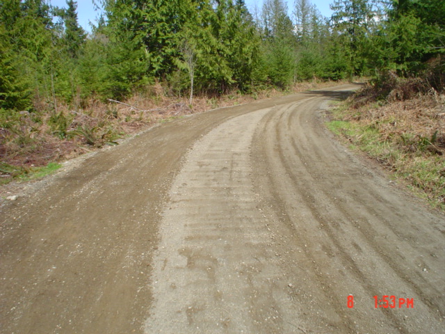

I too have a mile gravel road. I don't have a land plane, but I swear by my box blade, with a little help from a regular blade I picked up for junk value and had a friendly farmer weld for me - and a Ratchet Rake. My drive crosses and turns over two steep hills - but I add gravel only rarely. And it looks pretty good.

I too have 3/4 mile gravel road which I maintain. I have used a Kioti DK45S and a Kubota MX5000. Either tractor works great. To shape the road I use a 8' York Rake. It works great. I have found the key to keeping the road in great shape is to perform the preventive maintenance as required. I use crushed asphalt which I get from a local contractor and rake the crushed asphalt over the road as needed. The crushed asphalt is fantastic.

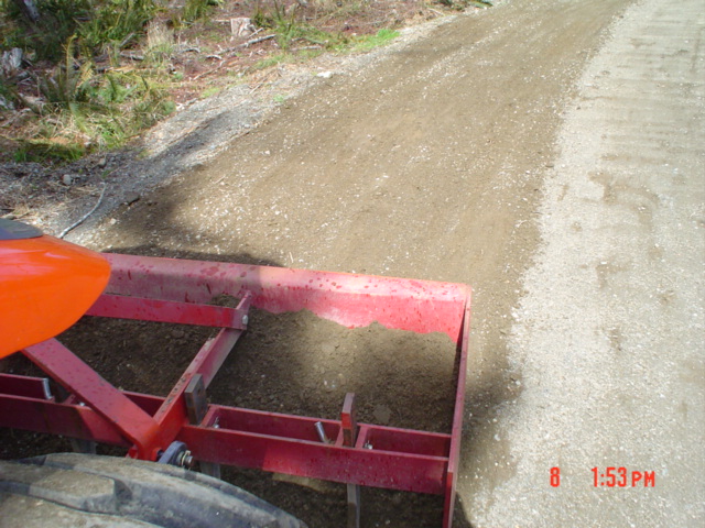

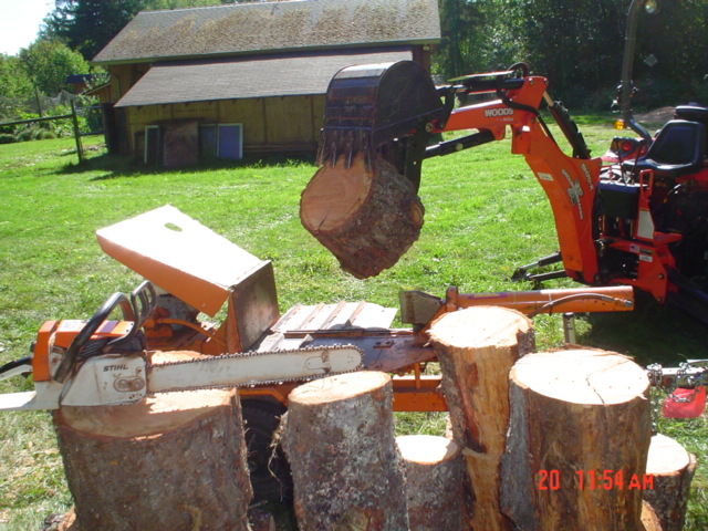

I am on 14 mostly wooded acres and grade a gravel road that's about 3/4 mile long. I have a Kioti CK35 HST with R4 tires. I use the backhoe to lift the larger rounds onto my log splitter and also to lift logs a couple of feet off the ground for cutting into rounds, much easier on the back.
For grading the road I use a 6 foot box blade. :)
