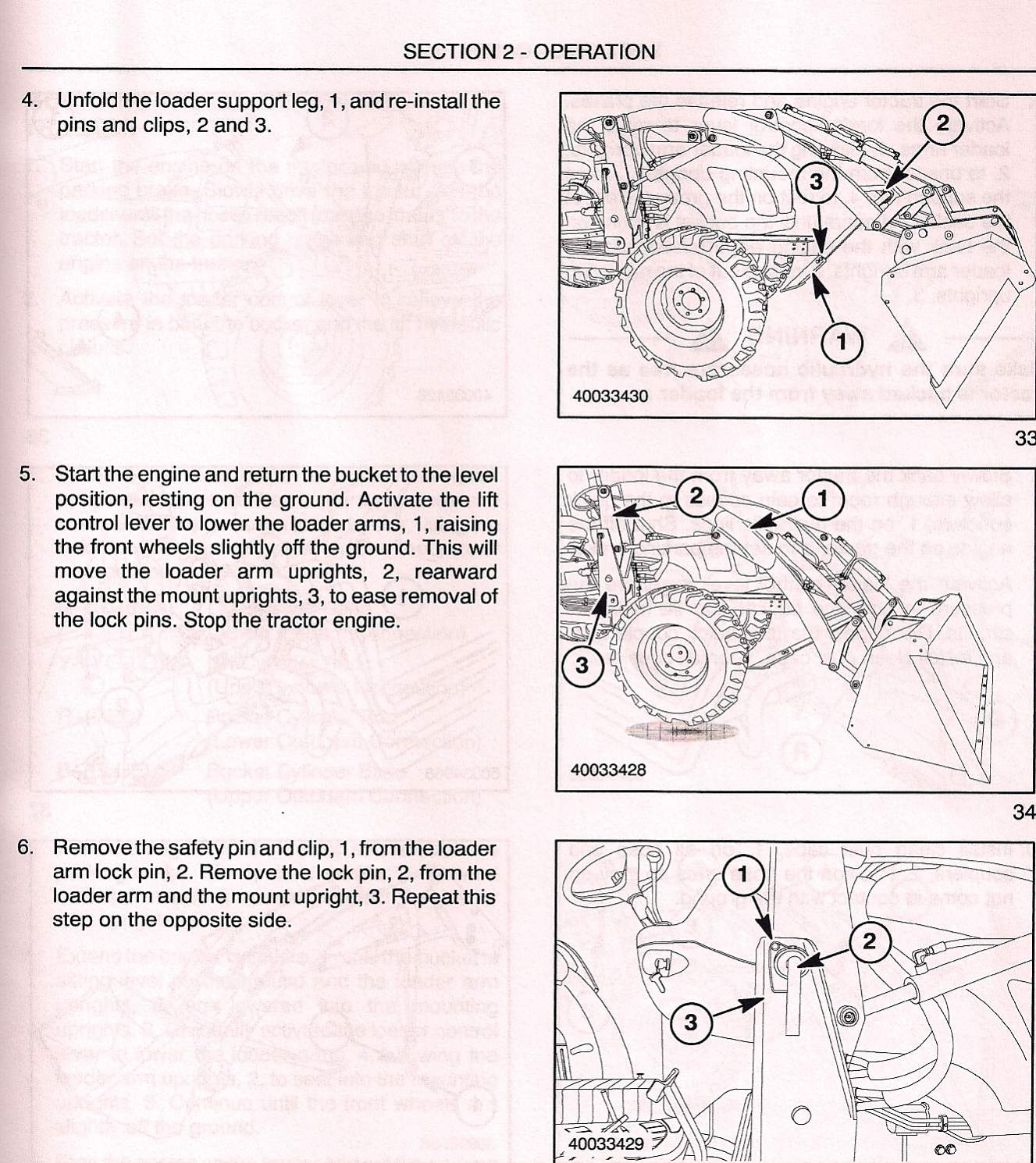

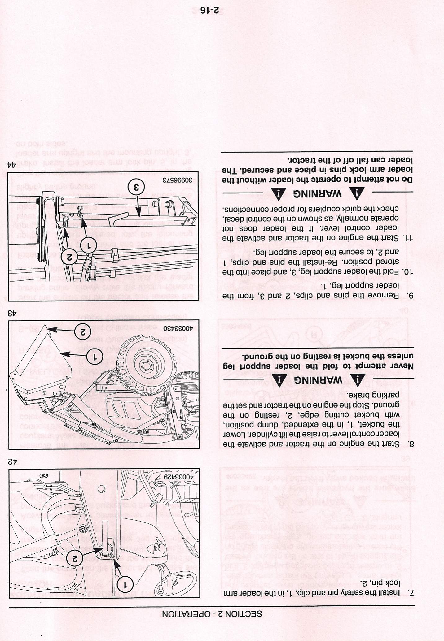

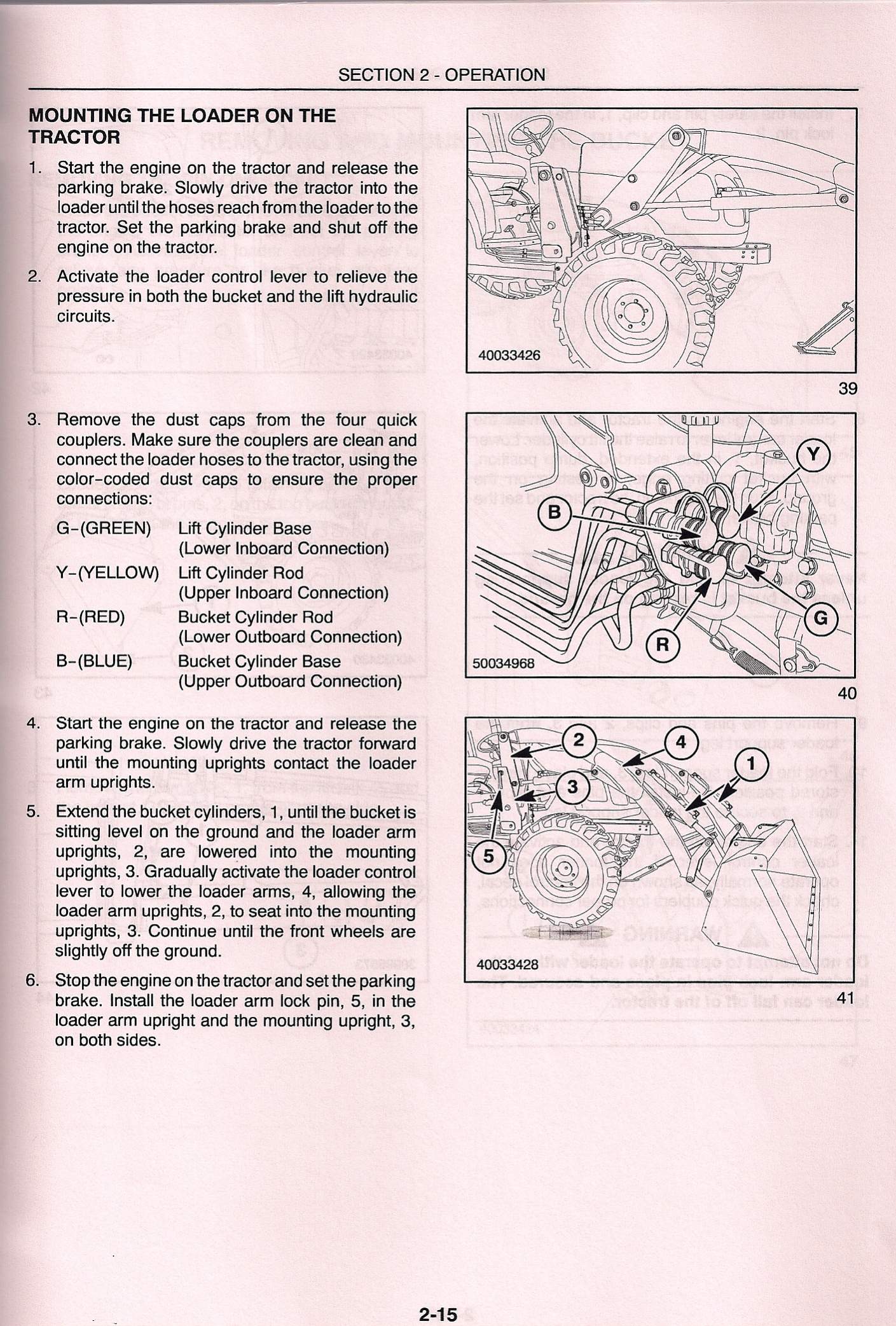

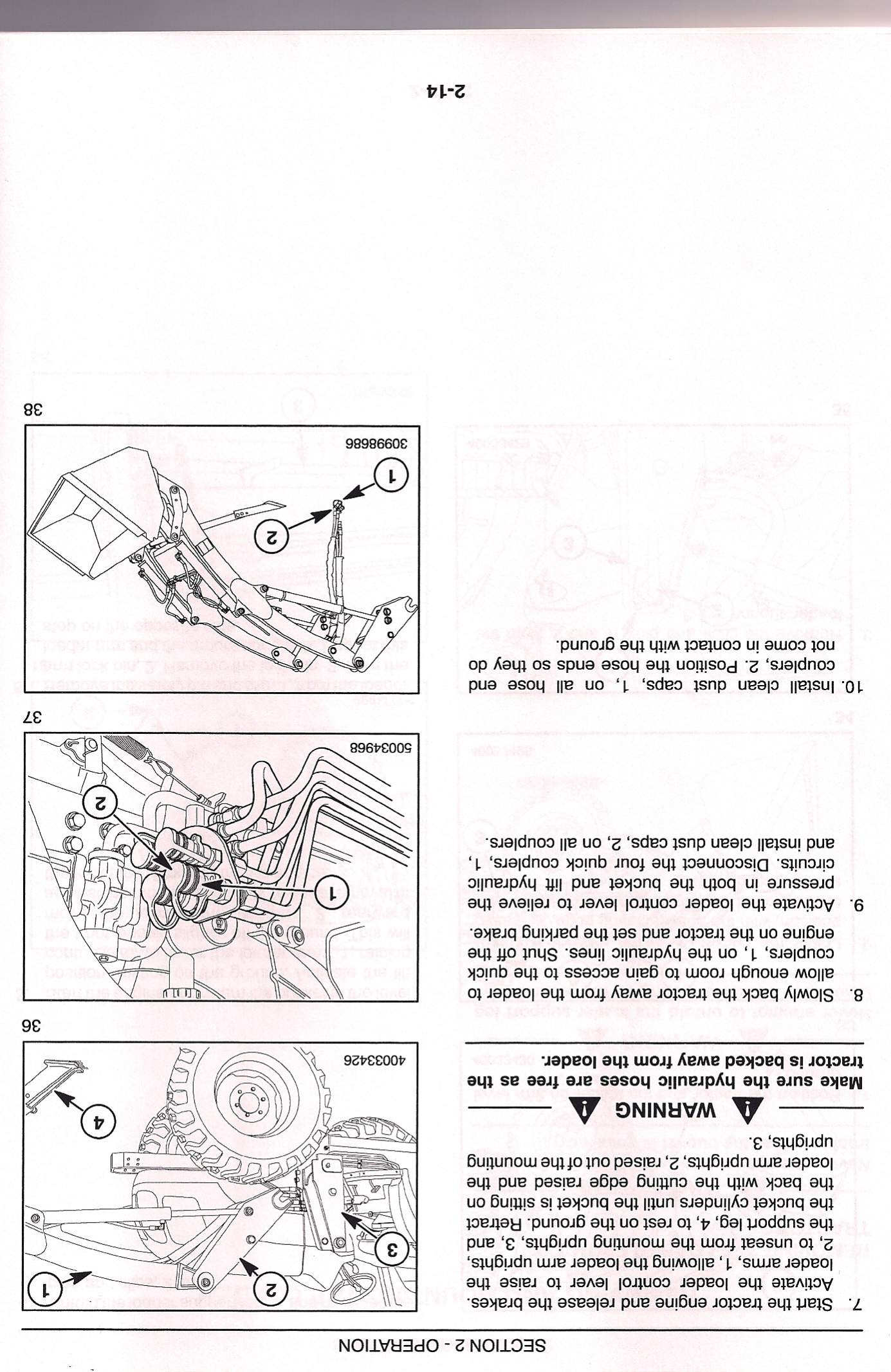

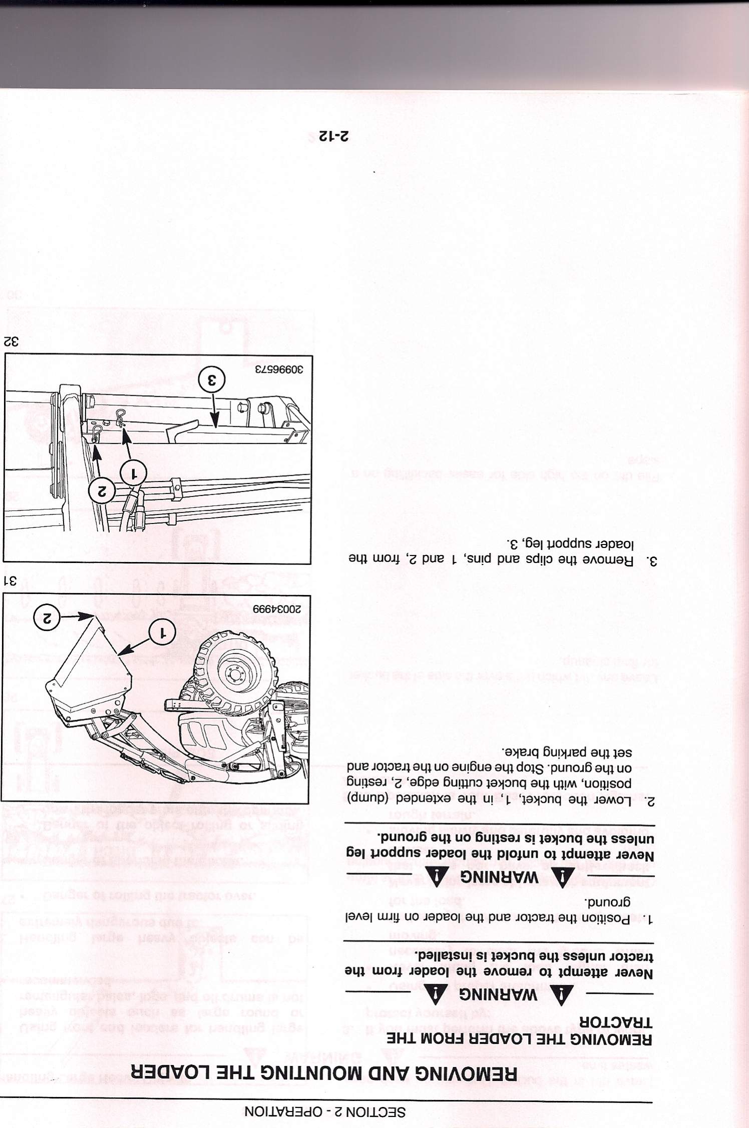

I bought my TC31 used, and the owner couldn't find the manual for the 14LA loader. Is there a place on-line I can download this?
Can anyone explain the process of removing and reattaching the loader?

Here you go:
  • LOADER 14LA.pdf
