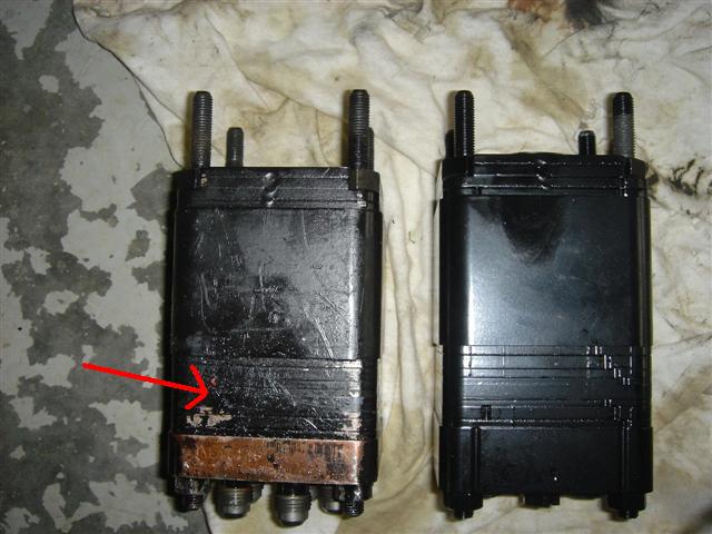

<font color="red"> Uh oh, bad news while playing around with it some more today, I noticed it was leaking from teh bottom of the valve, instead of the top like last time. I gave Terry a call and he said they can't repair the bottom of the valves so having no other choice, I bought a new one for $500. </font>

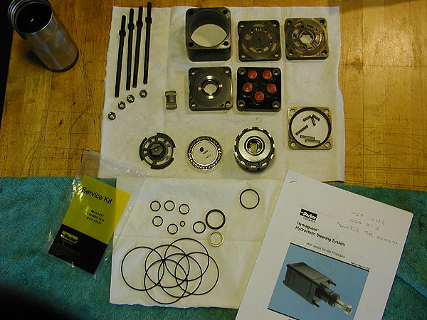

Uh oh. Aside from the complicated guts, the valve is basically a stack of square washers with big skinny o-rings between them, held together with four bolts. Attached is a picture of my disassembled unit. My guess is the tech misaligned an o-ring when he rebuilt the unit, or he didn't torque the tie bolts correctly, or one of your hose fittings is leaking. Before spending $500, you might see if you can spot exactly where the oil is seeping out. Try cleaing everything really well and sprinkling talcum powder on the whole thing. Then when you turn the wheel, the leaky spot will wet and discolor first. If it's between the washers, the PT tech messed up. If it's at one of the hoses, well...:p
Good luck,
Sedgewood

I got the new valve yesterday and it seems like a new design. The only markings on it are HGF 16226. I'll let everyone know how the install goes today. Of course I have to go get some hose adapters so I can hook it up.
I attached a pic of the new and old units together. The red arrow shows were it was leaking.

Finally some good news! /forums/images/graemlins/laugh.gif
I installed the new unit and all is well for the time being. This concludes my $620 journey through the land of hydraulic steering valves. Time to go dig some trenches! /forums/images/graemlins/grin.gif

Not to make you feel bad or anything (yeah, right!) but I also think PT dropped the ball on this one. My guess is one of the thin o-rings dislodged as PT was putting the valve together. May I suggest you get a copy of the service manual? The manual is quite well written and will be helpful in pointing out some quirks in the assembly you or your hydraulic shop need to watch for. I took mine to a shop and they had never seen one before. I managed to get it out of there before they botched it completely and rebuilt it myself, with a seal kit from PT.
Go to Parker's site and click on "Service Maintenance" to download a PDF copy.
Here's my web page on the rebuild. I've been working on my site and while it's not finished, I think it's viewable in most browsers now. I hope /forums/images/graemlins/tongue.gif
