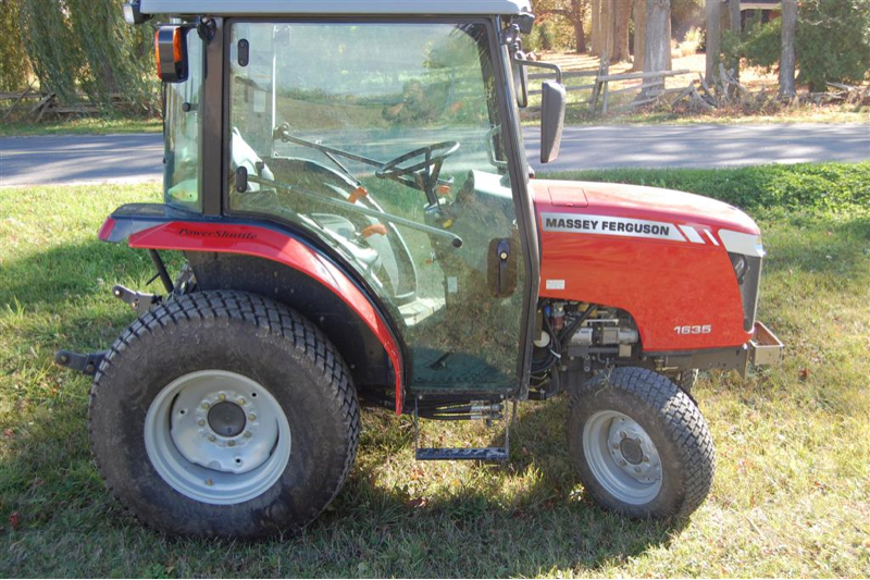

I now have loaded 13.6X16 turfs on my NH T1510. They are the Titan Multitrac C&S. Opinions on how they will be in snow with chains on blacktop? I live in the snowbelt of WNY, so a 2 or 3 footer a few times a year is common. I do have a rear blower..... One drive is stone, but a neighbor I take care of has a NICE blacktop drive....... Do link space chains chew pavement? Thanks to all

Nice looking Massey..... My T1510 weighs about 2400. Probably close to 3000 with the rears loaded?
You should be fine. Ours weighs 3527 with the same tires. Never needed chains, and rears are not loaded.
They are the same tires, 41 14 20.
Thanks for the compliment by the way. :)
