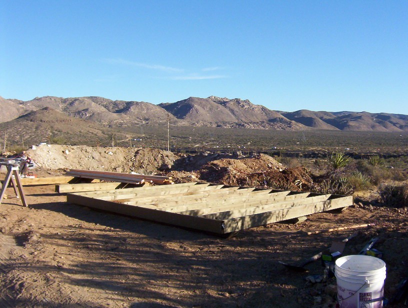

   / 12x16 Garden Shed Base #6
I built two sheds in the past two years. One on slab and one with a skid foundation. If you like cement work and have the money then I guess I would go with the slab. I don't have much money nor do I like cement work so I would go with your method but use 2x6 pressure treated wood sitting on 6x8 or 4x6 spaced a few feet apart. It sounds like you already have the area ready and know the drainigng issues. My shed/ cabin settled just a little but I didn't prep as well as you have.
