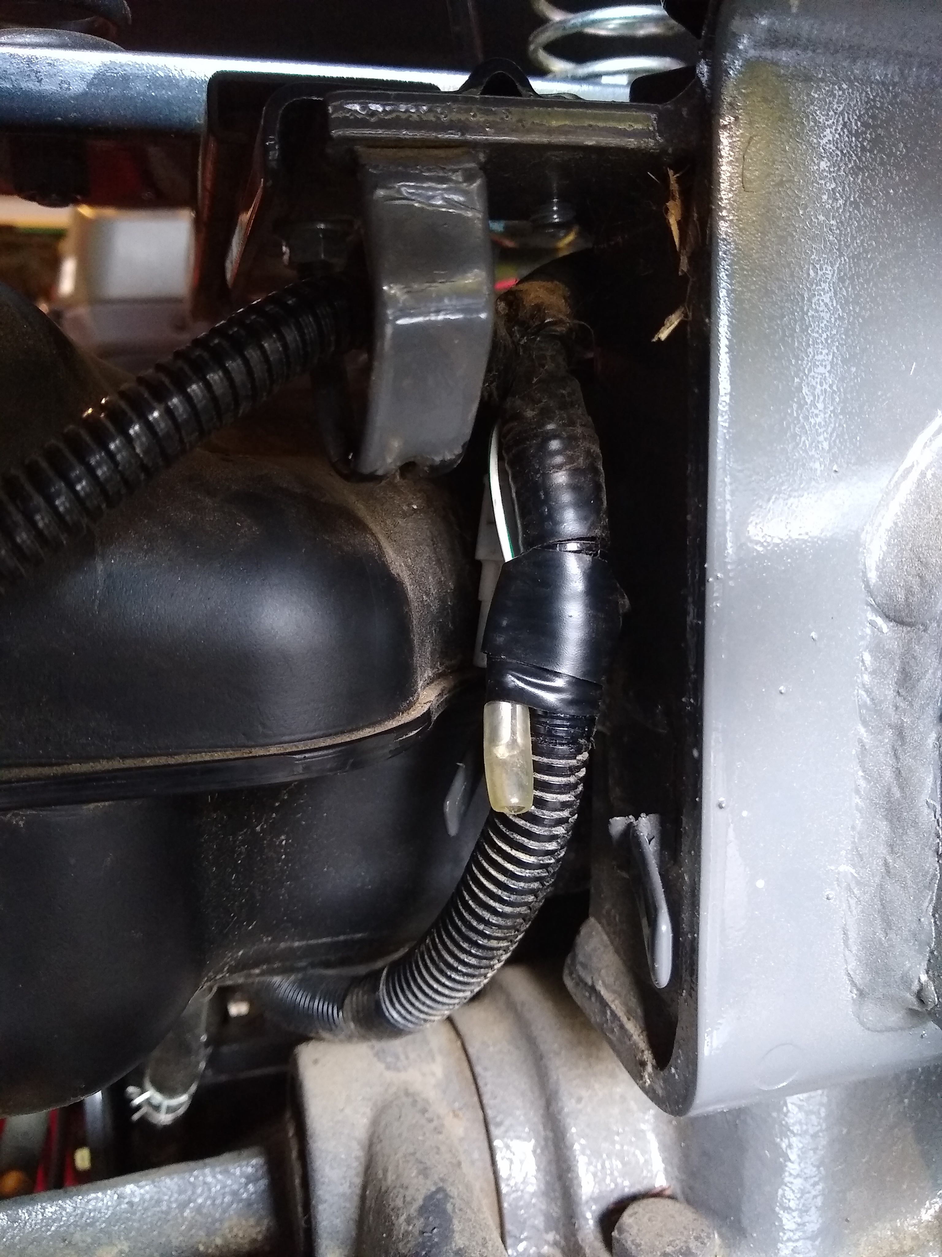

Ugh... Does anyone have any experience dealing with this 12v power supply located by the left of the toplink on a GC series? It is reliable? Can it power LEDs?

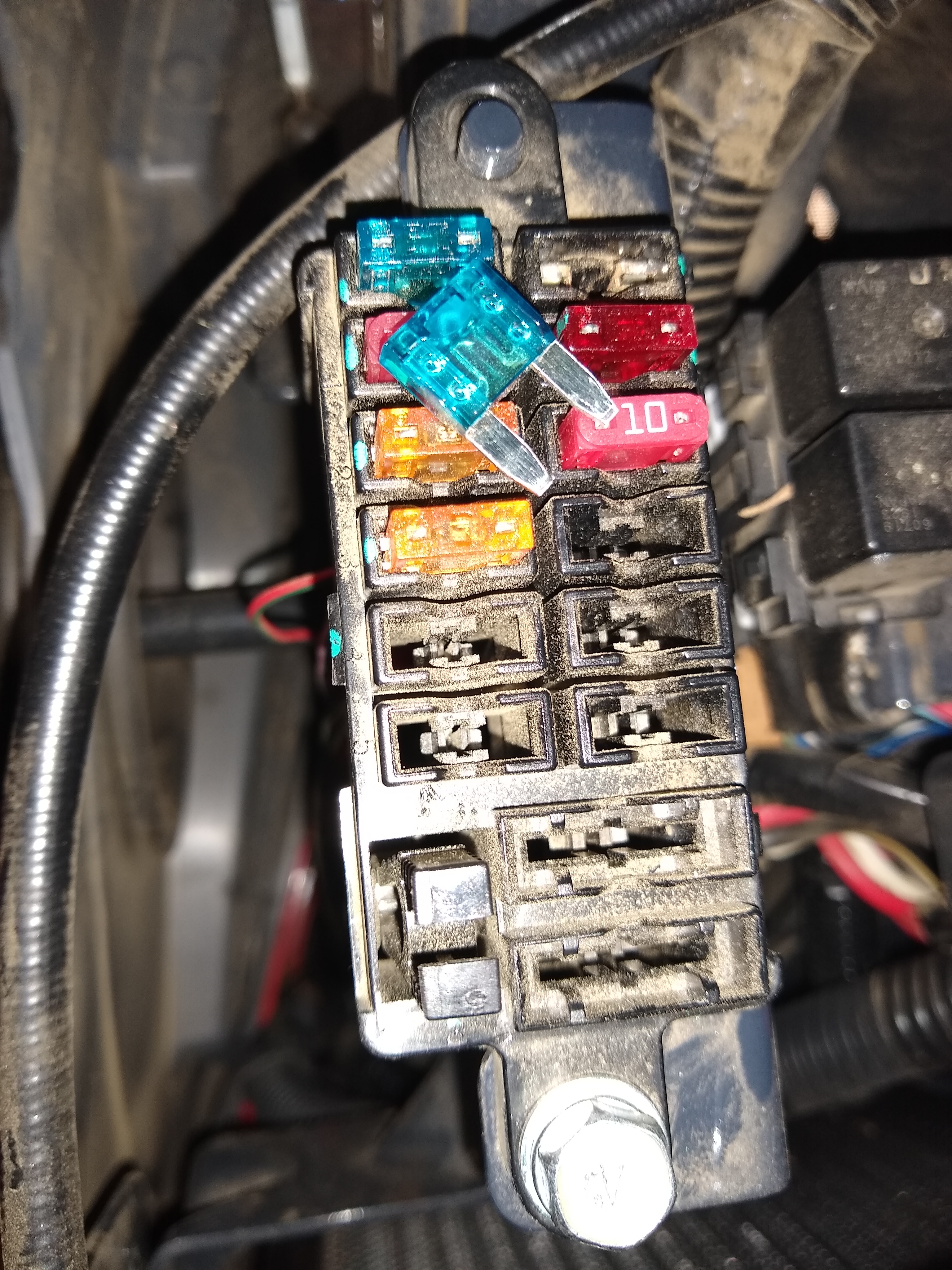

Here's the situation. I tested this circuit with a set of worklights and a nilight wiring harness and it worked fine. Went ahead and installed everything and did a final check before concealing wires, and now it does not work! I have checked fuses in the box and they are fine. The inline fuse is okay too on the wire harness. There is no power to this supply now. Thoughts? IMG_20181010_081402724.jpgIMG_20181010_081402724.jpg

I have mine powering a 24-inch LED bar. It is fused in the fuse box and it is a switched 12v lead. You must supply a local ground to your accessory. Did you short it and pop the fuse?
   / 12v rear power supply... reliable?
I found it! Someone suggested check all fuses, turns out the upper right blue 15a fuse on the block had tripped. That's the fuse for the rear 12v auxillary. Thanks everyoneIMG_20181010_123130994.jpg

Clarification please - you said "left of the top link"
Can you provide a little more details on where you are referencing, please?
I have a 24" LED bar mounted to the ROPS for FEL work. I would like to add spots for BH work. Having it fed from ignition action along with a switch is fine for me. The LED bar is direct off the battery.

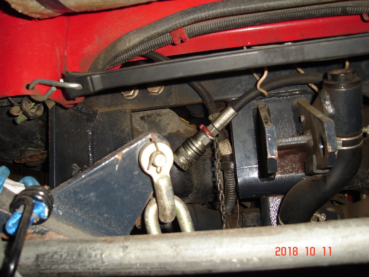

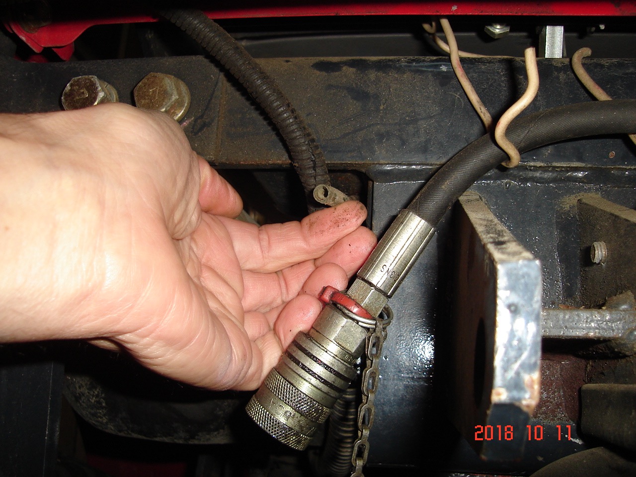

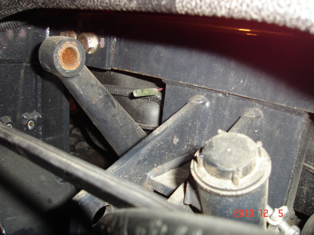

Find the hydraulic fluid fill tube in the back; it passes by/is attached to the 3PH top link connection point. To the left of that 3PH connection, there's a wire harness that passes up by it and over (to the left) into the ROPs; it's about 5/8" in diameter.
On my 2310, that 12V wire pops out of the wire harness on a very short stub right there, with a female 1/8" round connector. (In the third pic, it's just visible laying on my BH hydraulic line.)
