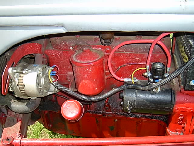

<font color="blue"> Another thing to so is get a 3 wire alternator.. not a 1 wire alternator. The 1 wire jobs ar ethe ones that need to be run up to a higher rpm to start to charge.. the 3 wire jobs can be externally excited, and will start charging as soon as excited. For instance.. the gm delco 10-SI alternator comes in both 1 wire and 3 wire versions.. bnoth have internal regulation. The one wire is as i described.. 1 wire to the battery.. lotsa rpm and you are ready to go untill the rpm drops down past 500 or so. The 3 wire jobs have the wire to the battery, and then the p2 terminal tied to the battery stud.. this is a 'sense' line for the VR. P1 is then hooked up to a toggle switch. After you start the tractor and idle it up to a point the alternator can charge.. hit the momentary switch and the alternator kicks to life. There are other ways to do it other than a switch. A diode will work, or even a marker lamp from the ignition switch to the p1.. this gives it some excite power.. but doesn't let the alternator backfeed the ignition. The diode version is elegant.. but some don't like to get into electronics that much.
The extra switch is fool proof and easy. </font>
I went with the three wire alternator on the 8N.
I have it wired up like this... (see attached picture)
You can avoid the separate switch, or diode, or marker light, simply by installing a key switch with an "accessory" position.
The red wire that runs to the alternator is hooked up to the key switch on the "accessory" terminal on the key switch. The yellow wire coming from the starter solinoid is hooked to the "battery" terminal on the key switch, and the wire coming from the distributor is attached to the "ignition" terminal on the key switch.
I'm certainly not an electronics expert by any means, but I'm good at following directions, even if I don't quite understand them. Someone here on TBN told me to hook it up this way last year, but I can't find the post now. It seems nice and simple, and easy to hook up, and I haven't had a problem with it since I hooked it up that way. Maybe someone else can explain WHY it works that way! /forums/images/graemlins/smirk.gif
