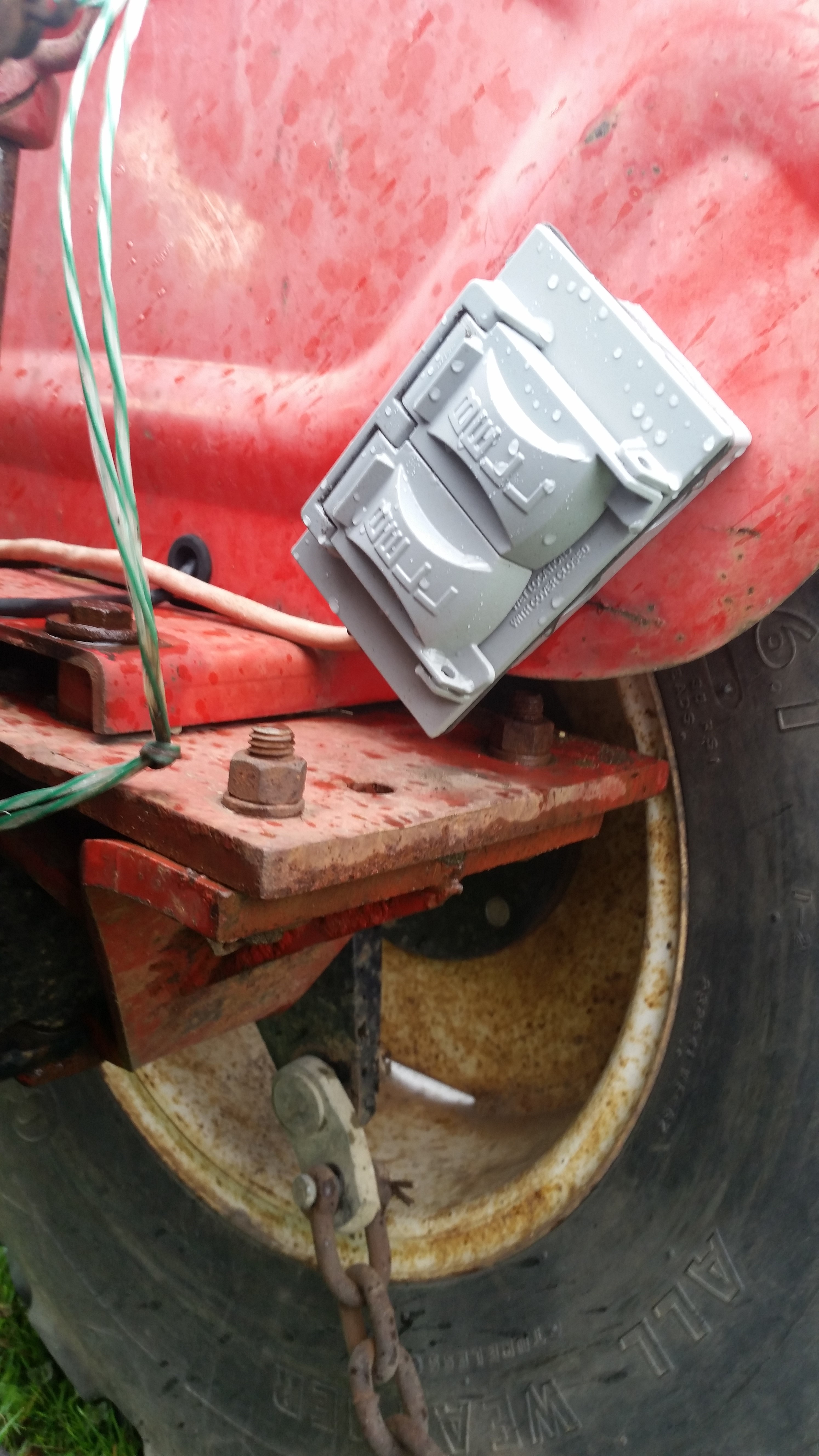

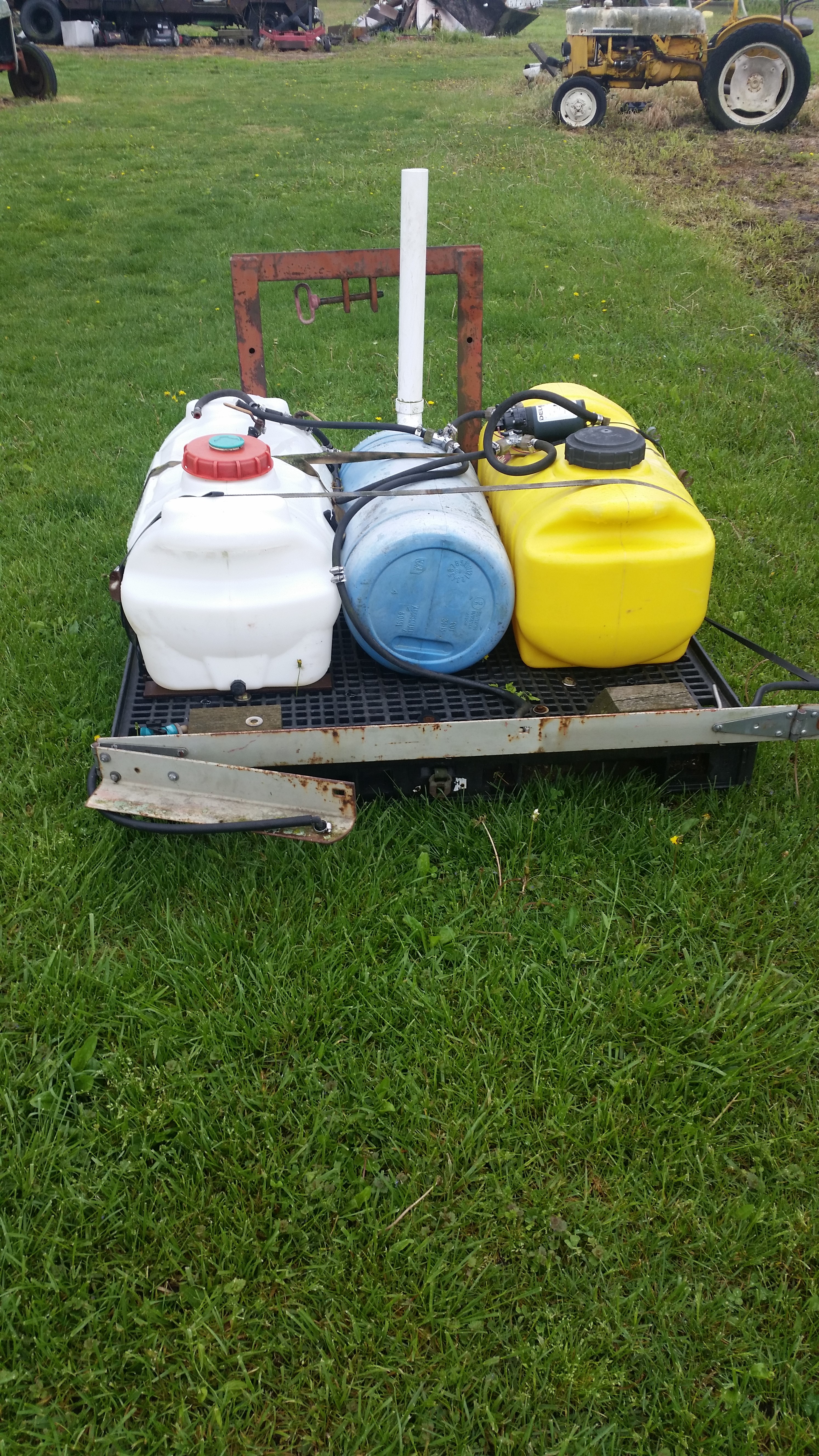

Old post, but for late readers, who want to know. I hooked a 110 volt drop cord (ends cut off) to the Battery. Ran it to a 110 volt, covered light switch, mounted under the Dash. And continued down the frame to my back fender and ended it in a 110 volt house outlet. Put a 110 plug, on my 12v wire, hooked to my 12v sprayer, then plug it into the outlet box.
Now, I can turn the sprayer on and off, from my tractor seat.
Smokin'

UUMMMM....It's on a Tractor.......not the House....I've been using this for close to 20 yrs now......it all started on a garden tractor.....Darnedest thing tho....it wont power, my power drill....I don't know....lol
I just cut the plug end off the drop cord, strip the wires back and hook it to the 12v wiring to the sprayer.....Ya know Bob....I get sick and tired of the "Childrens Home", eerrrr Government.....telling what I can and can not do.....OOOOOOhhhh someone might try plugging a 110v drill into it...go ahead...it wont work...HOWEVER....if you plug that 12v sprayer into a drop cord...Then you might get a free Fireworks Display...
The only problem I've had with using 110 volt stuff on a 12 volt system, was when I screwed a screw into a box and it hit the positive wire on the switch. YEP...durn near burned my ole cub lowboy down. It's Bad enough REWIRING a tractor the 1st time, but to have to do it Again....I understand "The Children" are just trying to protect me from myself, BUT, I didn't fall off the turnip truck this morning....
You can call me Red Neck, just Don't call me late for Dinner.....lol
