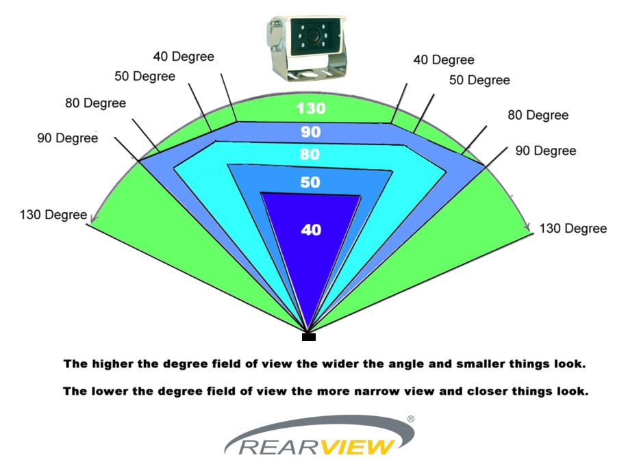

For the camera, for your application, you need a low angle field of view.
The Website: Rearview Systems: Backup Camera Safety Kits & Accessories
