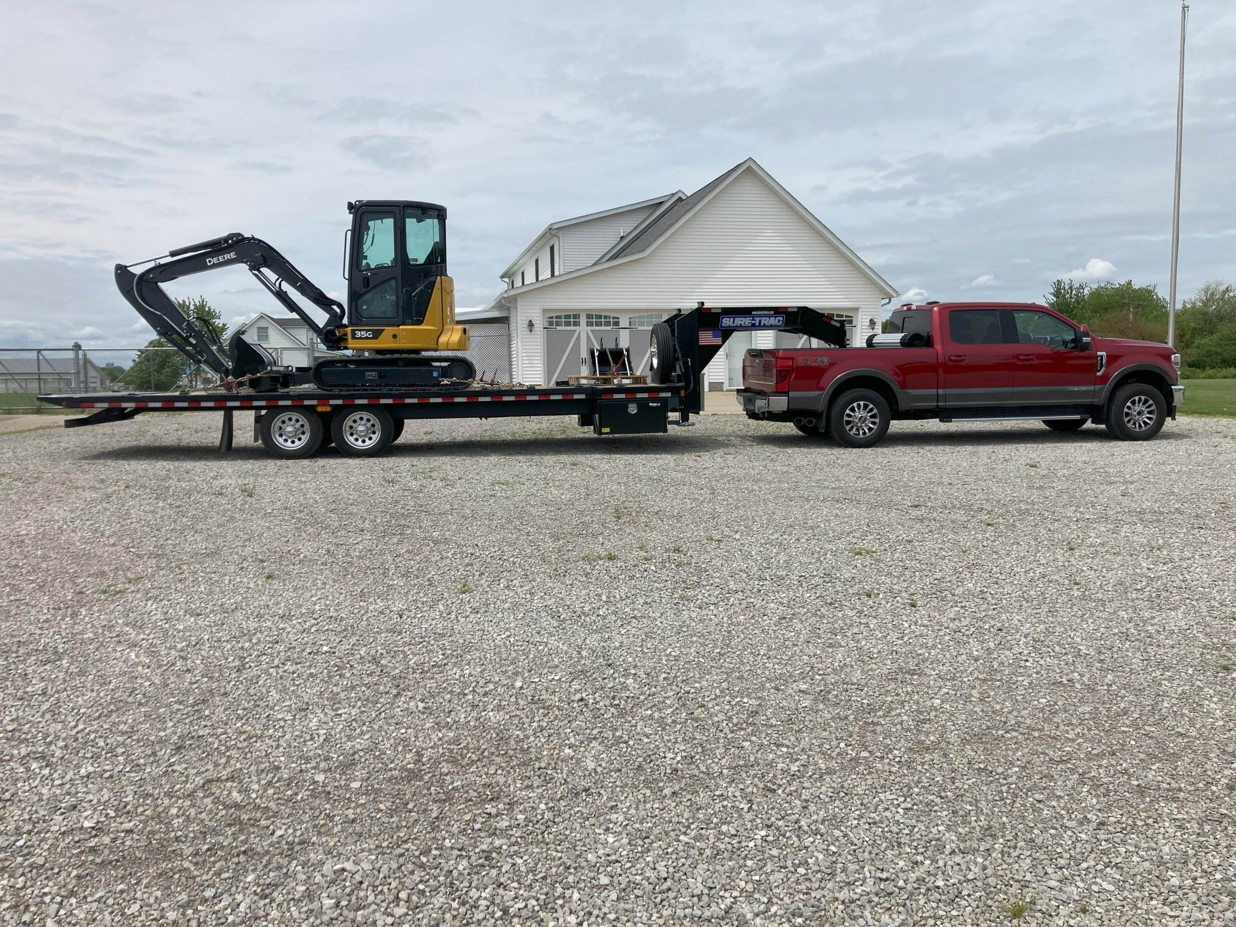

You need to determine how much tongue weight your truck can carry. Given the 10K GVWR and diesel engine, it will likely not be able to haul you and the 2400lbs of tongue weight for a 16K gooseneck. Take a look at the tire and loading information label on the trucks door jamb, subtract the weight of you and any passengers plus any tools or other stuff you carry including aftermarket equipment you may have installed to determine your maximum allowable tongue weight. If you think you are going to be on the edge, take it to a CAT scale in the condition your intend to tow with and subtract the weight of the truck from the GVWR to determine your max tongue load. That should help you determine if a gooseneck or bumper pull is a better fit. My F350 with a 17k GN is maxed out with my 10K mini. Only 150 lbs below the 11,500 GVWR
