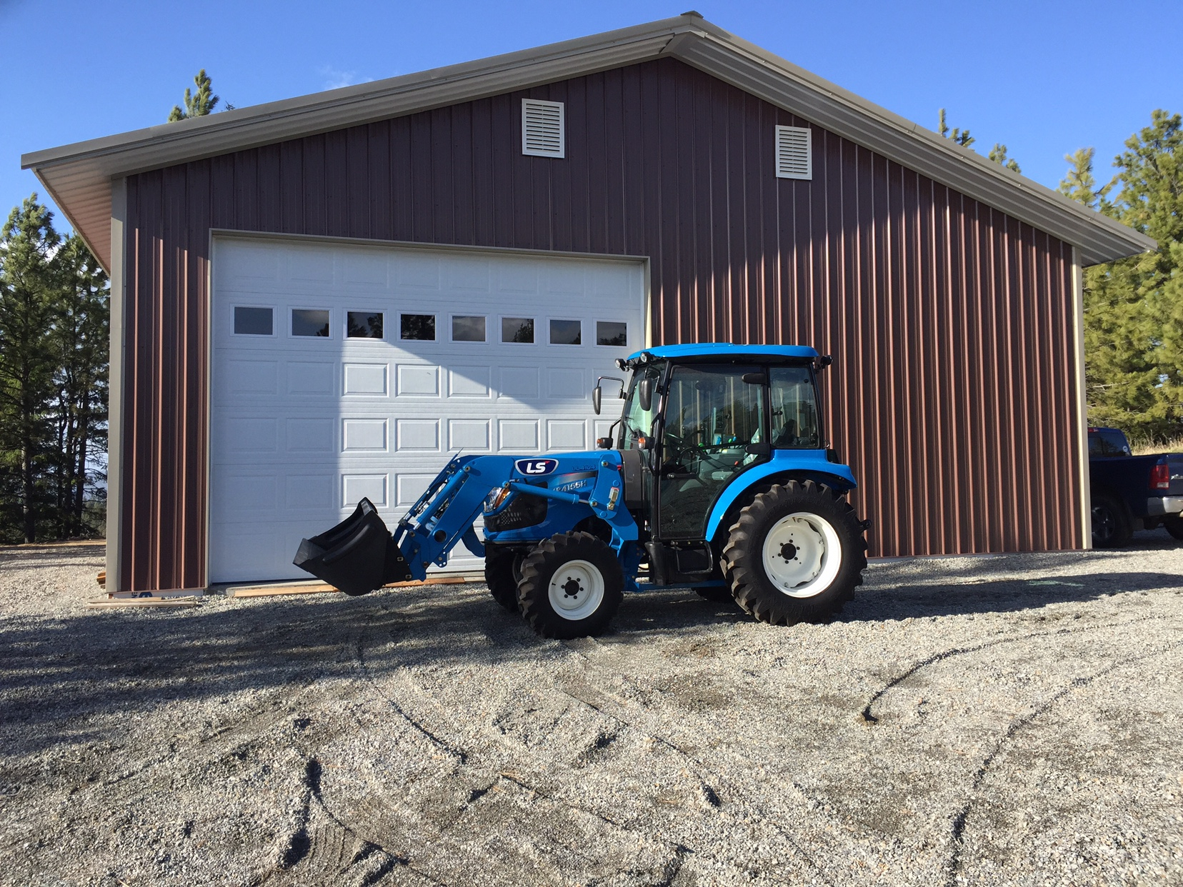

I have a 12’x16’ steel panel door for my shop. Didn’t really even consider a roll up door of the same size as it would have been cost prohibitive. I have a Liftmaster jack shaft drive garage door opener on it as well-couldn’t be happier
Btw-I’m at 3200’ in NE WA. Plenty of wind and snow. Door has sealed fine and is sufficiently insulating.
   / 12'h x 16' w Roll up door vs panel door
Very nice, I'd like the window panes also. Did you buy locally or online.
Also, did you do the install?
   / 12'h x 16' w Roll up door vs panel door #4
This was sourced from a local garage door company that also did the install-I’m not a fan of installing torsion spring door counterbalances ( and the springs on this door are pretty impressive).
Door is a Wayne-Dalton.

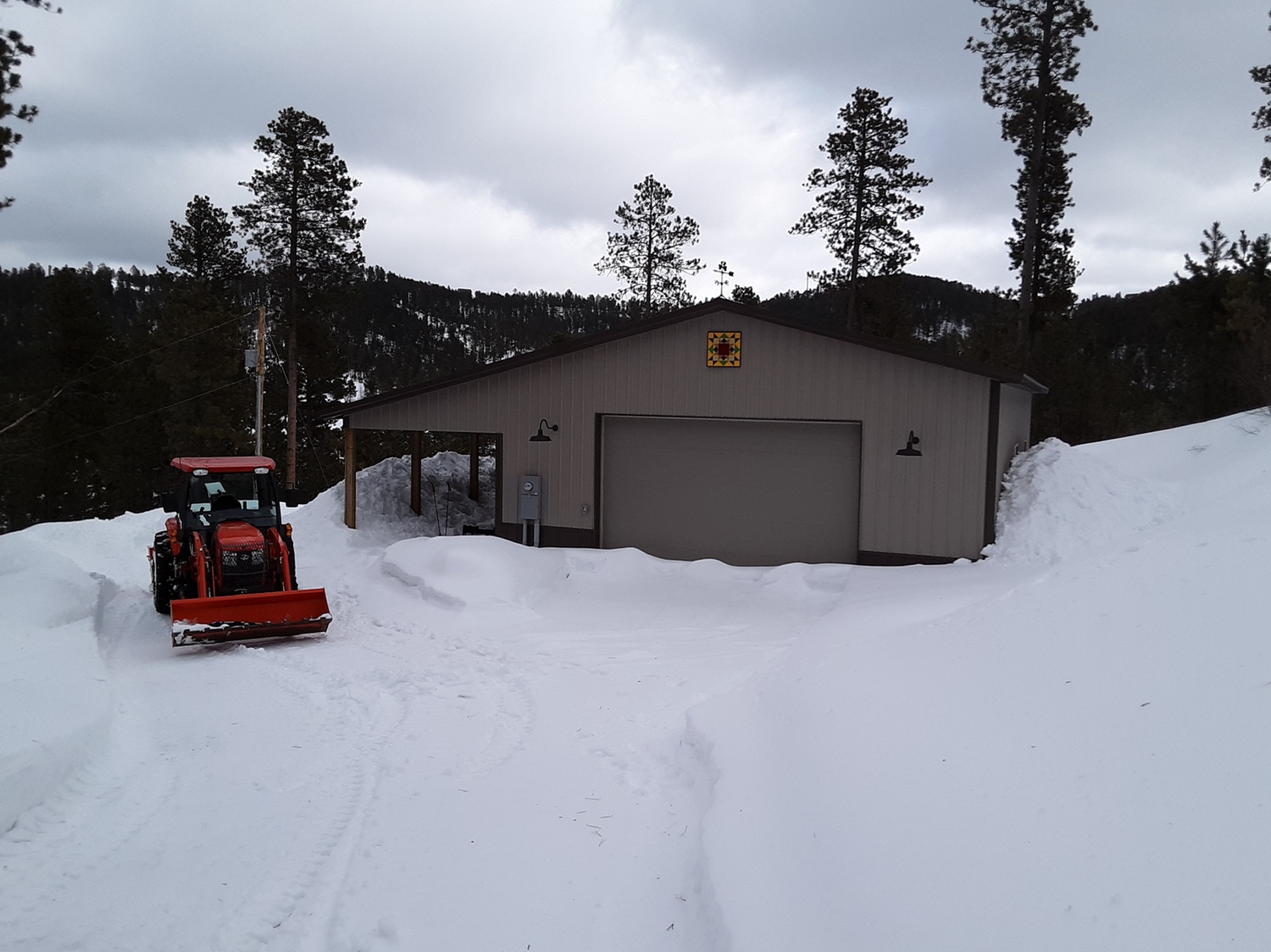

I have a 10x16 clopay panel door with a jackshaft opener as well.
