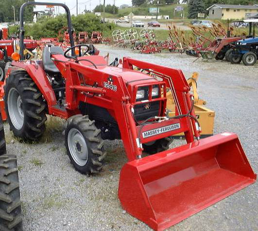

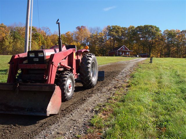

rackoholic said:
I have turf tires on my 1250 and would rather have the r4 but I can't find a comparable size to the metric Bridgestones I have. I use my tractor for mostly yard work but in the winter when the snow falls the little guy is all over the driveway.
Anybody know what the correct sizes would be for a 4x4 1250 to put R4's on it. pics would be great also.

I have the R4 tires on my 1250 4x4. I will look at the tire size tomorrow and let you know. Tim

Tim this is from my book.
MF 1240
2W0
AG Fronl—5.OO-15 F2 Rear—i1.2-24R1
PSI (KPA) 41(283) 17(118)
Turf Front—24 x 8.50-12 R3 Rear—355/800-20R3
PSI (KPA) 23(159) 14 (97)
MF 1240 4WD
AG
Front—7-14 Ri Rear—11.2-24R1
PSI (KPA) 26 (179) 17(118)
Turf
Front—27 x 8.50-15 Rear—355/800-20 R3
PSI (KPA) 23(159) 14(97)
MF 1250
2 WD
AG
Front—5.50-16 F2 Rear—12.4-24 Ri
PSI (KPA) 41(283) 14(97)
Turf
Front—24 x 8.50-12 R3 Rear—355/BOD-20R3
PSI (KPA) 23 (159) 14 (97)
MF 1250
4W0
AG
Front—7-16 Ri Rear—12.4-24 RI
PSI (KPA) 26(179) 14(97)
Turf
Front—212/80D-15 R3 Rear—355/80D-20 R3
PSI (KPA)23(159) 14(97)
MF 1260
4 WD
AG
Front—8-16 Ri Rear—13.6-24 Ri
Turf
Front—212/BOD-15 R3 Rear—355/800-20R3
Hope it helps
