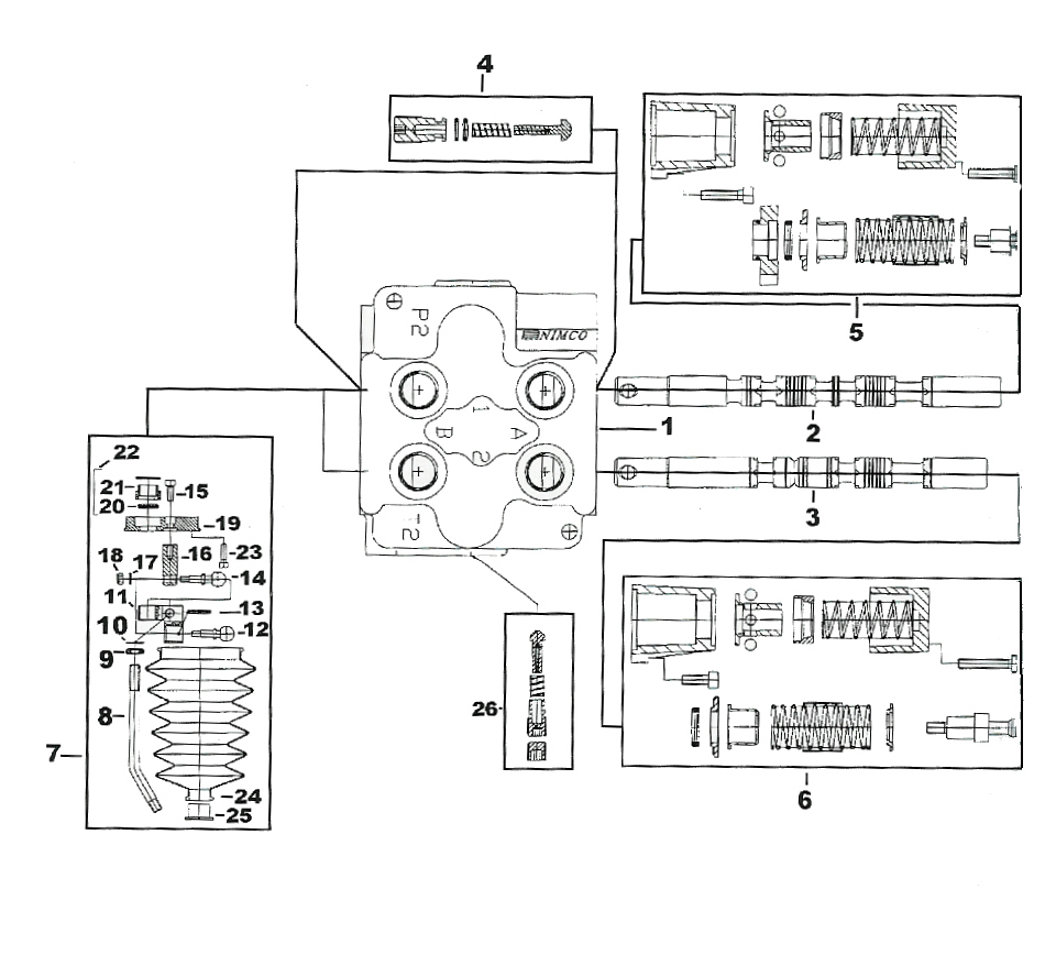

Ok guys need some help please. I have a 1246 loader leaking around the joy stick. I have a repair kit. This unit has been worked on before and the correct seal wasnt installed. Does any one have a good diagram on replacing the seal on this Nimco (black) valve. I dont have anything to go back with. I also heard there was some type of add on bypass valve to keep form blowing out these seal. Mf sent out a notice these loader need this valve? Can anyone help? I need some really good details on seal replacements. Thanks
I have email and or fax Thanks

Tim. I repaired my Nimco with help from Jerry G, a contributor to this site. He sent me a print of the valve which I can try to send to you. I never overhauled a hydraulic valve before, so I kind of surprised myself. It wasn't difficult at all.
/ 1246 Loader for MF #3
See if this diagram helps.
