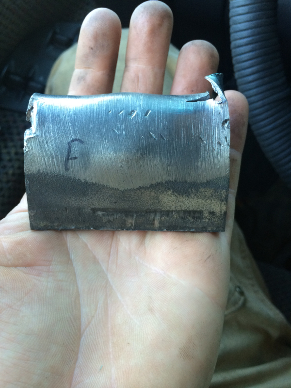

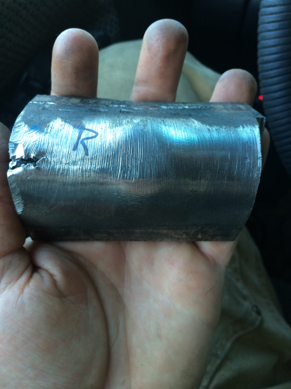

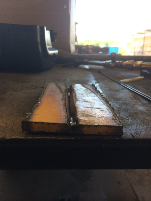

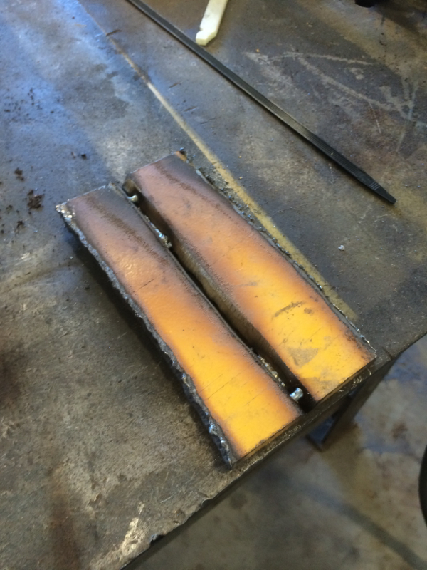

Did this quick today at work
3/8 with 45* bevel
Tacked and welded two passes then ground the root and welded one pass to bring it flush
Root bent, can see crack developing in area of start, rest of weld looks good
No cracks at all in welded area but can see base metal actually starting to rip approx 1/4" above weld

I just got tired if all the bickering and nonsense on here so I just decided to stay late at the shop and bang a coupon out quick because I don't have a 110 mig at home. The machine I used was a millermatic 140 with .030 wire and c25 gas
