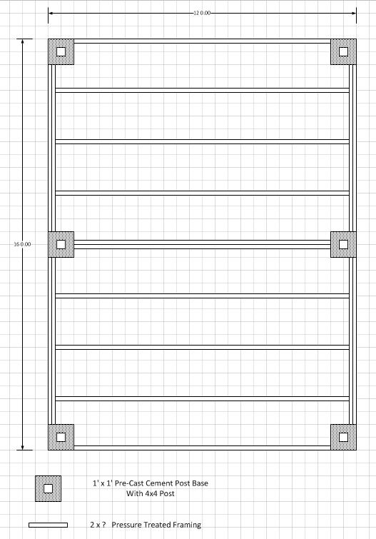

Hi,
I'm going to build a 12 x 16 shed this summer and would like some opinions on the foundation. What I would LIKE to do is pour a concrete pad... Unfortunately, the town does not allow a permanent foundation under a "shed".
So, what I'm GOING to do is build a pressure treated stick framed floor and support it (the ground is slightly uneven) with pre-cast concrete post bases and 4x4 posts.
One concern I have is that the ground under the shed may settle over the years and I may need to re-level it by jacking up parts and adding some shim material under the pre-cast bases.
Because of that, I really don't want to have to crawl under the shed. I'd like all of the supports to be around the perimeter.
Questions:
How many support posts should I use?
What pressure treated framing lumber is best to make the 12' span?
Is 2' on center the right spacing?
I have attached a quick drawing that shows the basic framing with my proposed post locations.
Feedback please...

You can look at span tables for decks to get an idea what spans, spacing and sizes of joists are in general use. A 12' span and 24" would not break but it would be bouncy even with 2x12s. Myself, I would do it KennyG way with three parallel 16 ft 4x6s in ground contact on compacted trenches of crushed rock. This gives a 6ft span and use 2x6s or 2x8s for the joists 16" oc. Treated lumber is generally eastern yellow pine which is quite stiff.
   / 12 x 16 Shed - Foundation Questions #10
I looked at your plan, you need to use 2*10 joists 2' O/C. The edge beam carrying roof and floor loads (30psf snow load) should be 3 ply 2*10. Skip the double joist in the middle and add blocking between the joists at mid-span. This will yield a strong floor that will have less deflection than span/360 (L/360) which could support ceramic tile without cracking. As for the foundation, all foundations that do not extend below the frost line are floating foundations. Settleage or frost heave could change the elevation of the footing, this can be minimized by digging out underneath the footing and installing clean crushed stone at least 12"deep and 2' square. Place landscape fabric on the inside of the hole to prevent soil contamination of the crushed stone. Set your deck blocks with 6*6 posts supporting the edge beam. Joist hangers connecting the joists to the beam and post to beam connectors will add considerable strength to the assembly. Don't skimp of the decking use 3/4" tongue and groove plywood at minimum. Use pressure treated lumber if the bottom of the floor is within 12" of the ground. Installing a 6 mil poly vapour barrier underneath the shed wouldn't hurt either! Sorry for being so long winded
