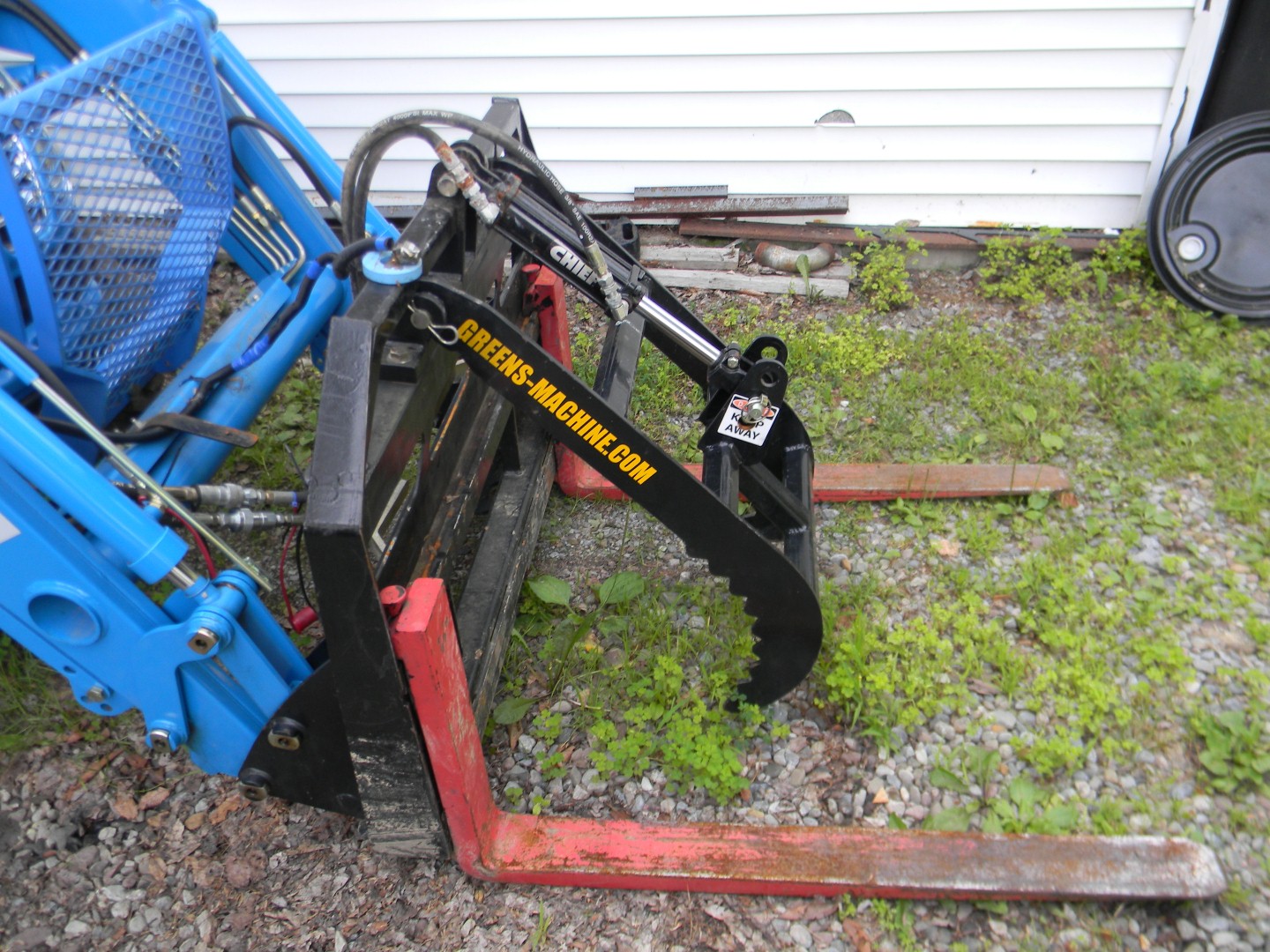

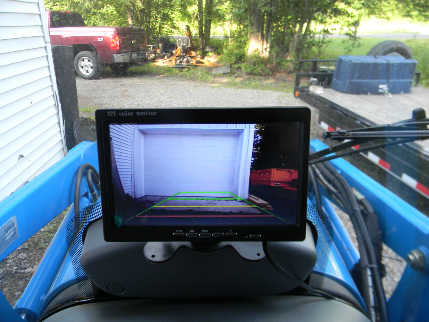

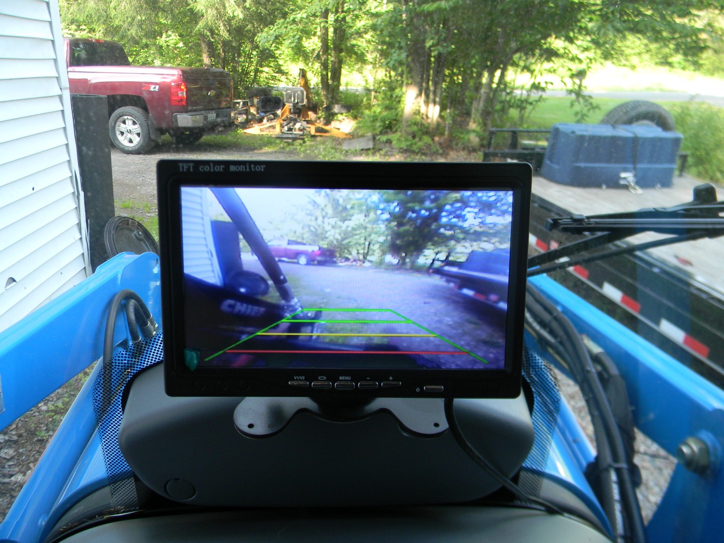

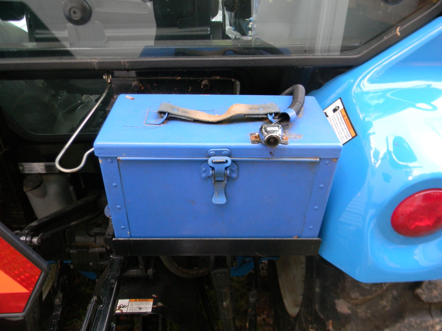

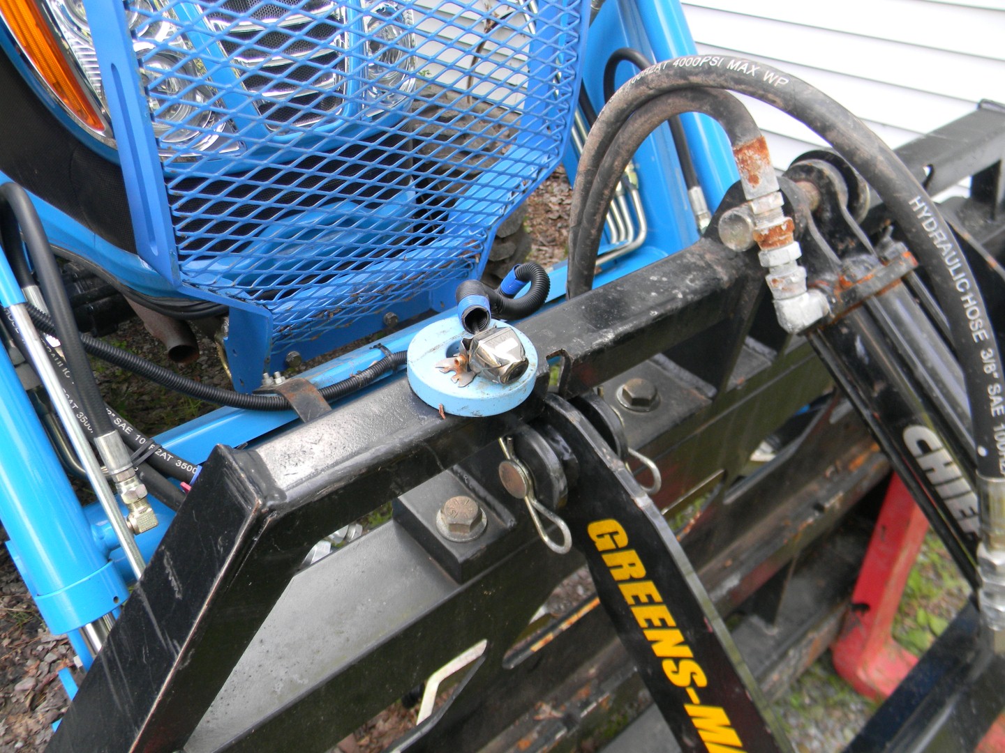

   / 12 volt #8
My front camera is held on by a round magnet because I need to move it depending on what attachment I have on the front (forks, or bucket). Rear camera is attached to a tool box I mounted on the back. Monitor has a switch to change between cameras. Monitor attached to dash with 2 screws. Routed front cam wires along loader hoses w/ zip ties. Rear cam wires also zip tied to hoses to under cab then up.
