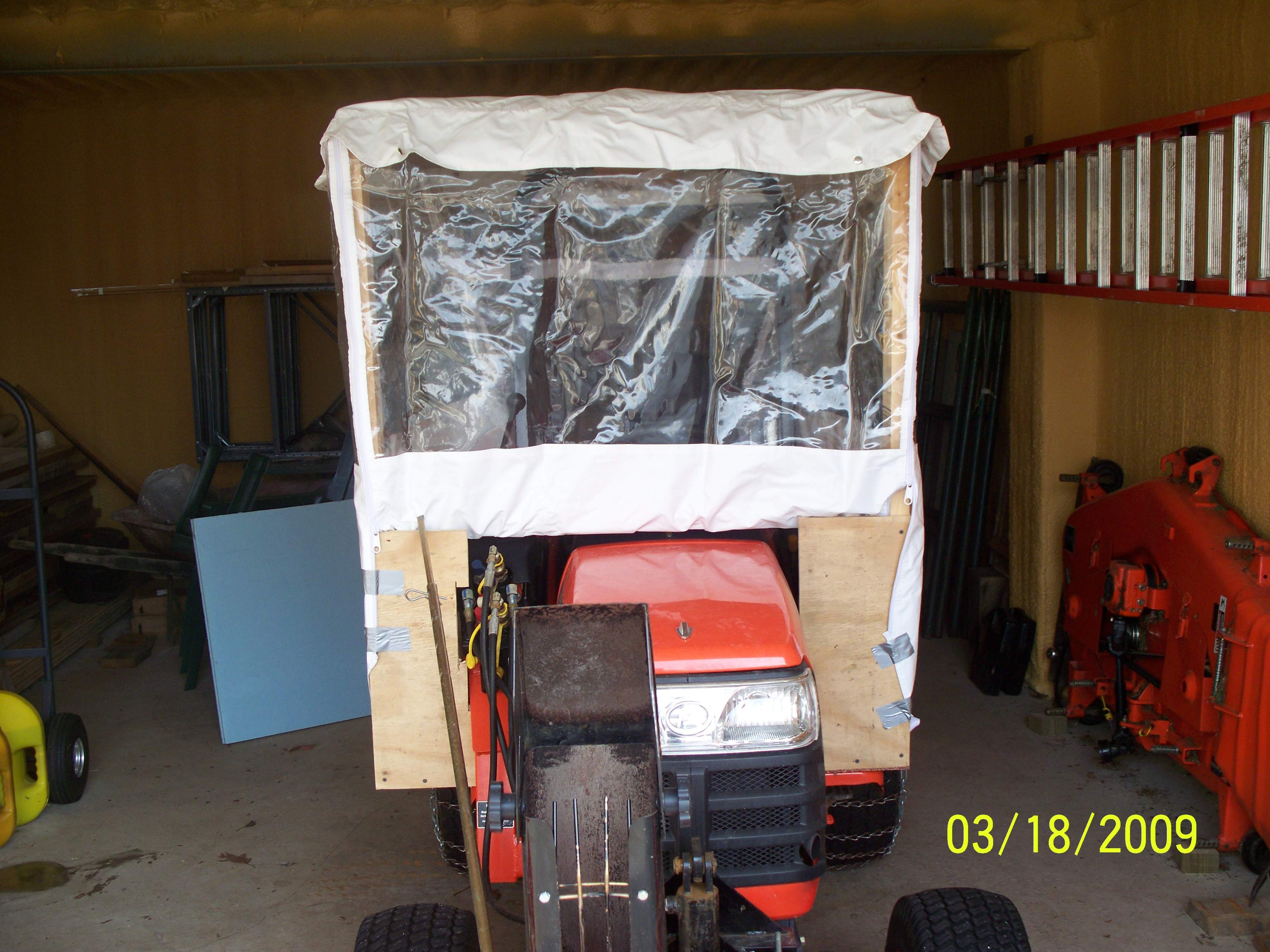

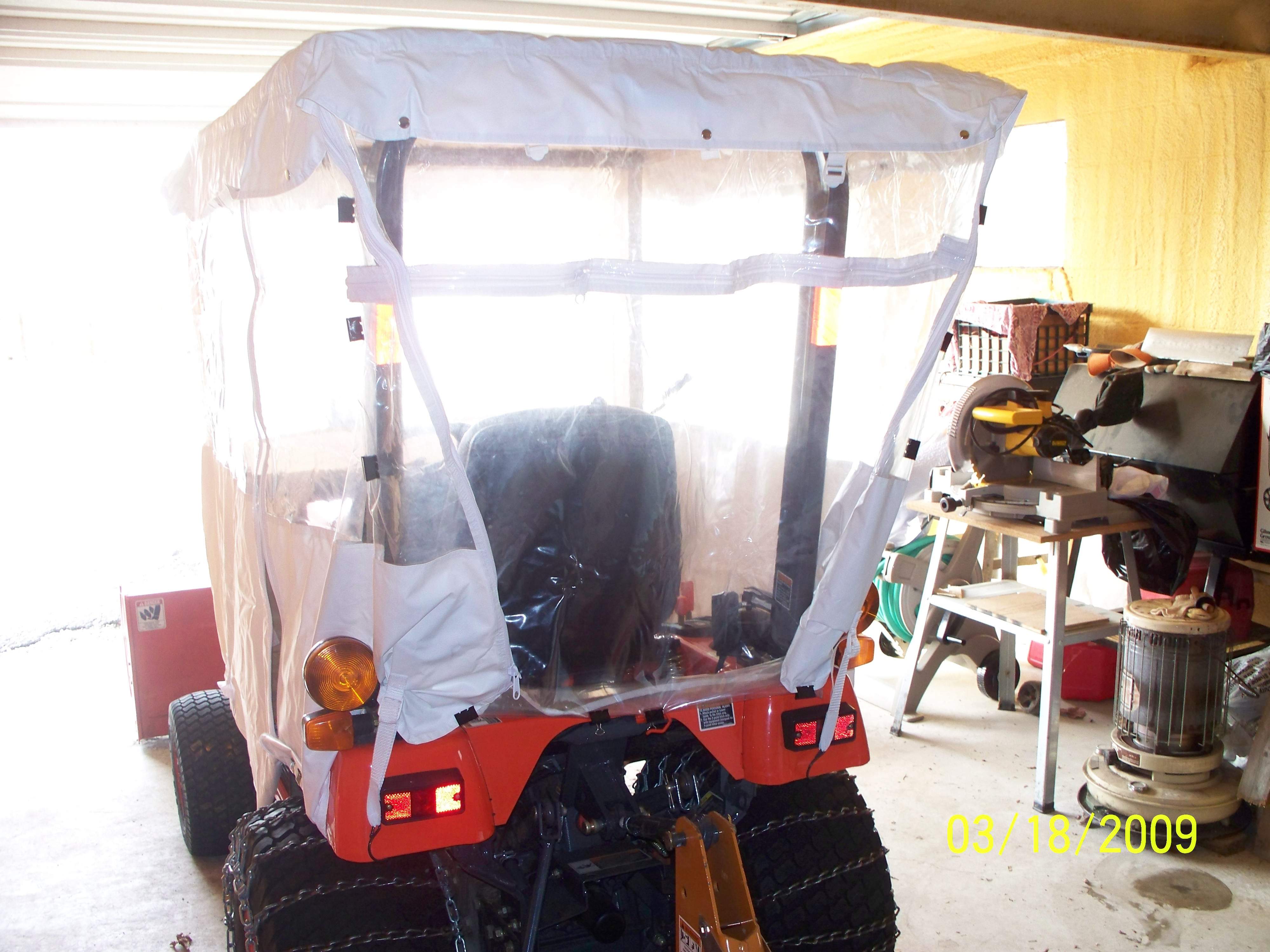

I made my cab with 2x4's, plywood and a golf cart cover. I got the idea here.
I have about $75 invested & it's easy to remove in the spring. It doesn't look the best, but it keeps my warm.
/ 12 volt heater #18
Sorry. I forgot to attach photos.
