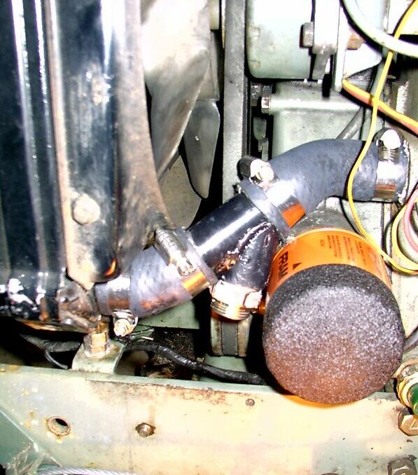

When I got my YM1110D, I took the thermostart plug out and soaked it for a couple of days in diesel fuel. Then I rinsed it with clean fuel and let it dry. This seemed to clean it out pretty good.
Do you have the original air filter element (cleanable) or a paper replacement? The reason I ask is that the thermostart plug is very close to the air filter element. When the thermostart works, it creates a fire inside that tiny intake manifold. That fire is way too close to the air filter for me to be comfortable with a paper element filter.
After messing with mine (including replacing the bowl and hoses so that it is self filling from the injector return lines) I don't even use it because I have a paper filter. I put a lower radiator hose heater on mine. That was a pain, but in the end it worked out great. The tractor starts very easily after plugging in the heater for about 30 minutes. I attached a photo of the heater. I actually used a 3/4" NPT nipple, cut it at an angle, and had a buddy of mine weld it to some 1" thin wall pipe. Then I bought a 3/4" NPT freeze plug heater and installed it. From the photo, you can see that it is a very tight fit. If you get a chance, take a look at other photos of my Yanmars at my web page.
