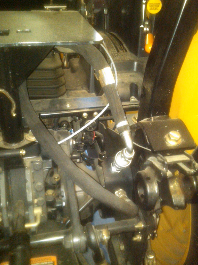

I just removed the backhoe from my 110 tlb and I am not real happy with the hose that must be reconnected. It sticks out behind the tractor and is in the way of the three point hitch movement. I assume it must return hydraulic fliud to create a continuious loop for the power beyond? I was thinking of removing the QD from backhoe and install on tractor with the other QD and just have a short hose made to complete the power beyond loop. Any suggestions?

Take a pic, I believe you talking about the power beyond loop that needs to be reconnected to supply a return to the sump. There are a few options but a pic or two would help.

Here are the hose photo's. :)

You can definatly shorten that up. Take a garden hose and fit it up the shortest you can with out crimping it. Measure it then go get a hose made. Problem solved.

I will look at mine tomorrow to compare, certainly don't remember mine being in the way as yours is pictured.
I wouldn't shorten the hose yet, I suspect it wouldn't help with the problem but could make it difficult to hook up the backhoe.
   / 110 TLB power beyond/backhoe hose? #8
Mine's a 2008 model and it's identical to yours.
The male end will fit through the gap between the fender and the ROPS. Square up the flat surface of the male end with the flat side of the fender and slide it thru - bend it around the ROPS tube and connect.
DON'T shorten the hose!!!! As Steve mentioned - it'll make it much harder to disconnect and reconnect the hoe to the tractor.

I would like to take the hose pictured and put it on the backhoe. Then take the QD that's on backhoe and install on tractor. Now I will have two QD's on tractor and the two long hoses on backhoe. Then I will have a much shorter hose made to complete the Power beyond loop. Any opinions or suggestions?

The hoses are identical - the one on the tractor and the other hose on the backhoe - presently. They are carbon copies of one other! Same length - same male and female couplers. So, you don't really have to "move" any of the hoses.
Nonetheless, if I understand correctly... basically, you're planning to add a "quick disconnect" into the middle of a "newer-shorter" tractor loop that you could then connect the longer hose into from the backhoe. Is that correct?
That would give you a short hose on the tractor and a longer loop of hose on the backhoe. I don't imagine that would be a problem, at all. Just another couple of connectors.
Biggest issue would be to ensure that the total length of the loop would be sufficient to allow for easy disconnect and re-connect of the hoe.

Mechatgsk,
I'm attaching a picture of mine for you to see how the hose lays. Maybe you can loosen the end without the QD fitting, and swivel it so the hose lays in a different position?
I agree, I don't think you should shorten it.

Why not just make one loop in that hose and connect it to the QD's. They make hoses with a smaller bend radius, and that would be ideal.

Good picture and this demonstrates the hose can be out of the way without modifications. I have my hoe on mine right now but haven't had any issues with this hose being in the way when using the 3PH. Setting your hose up as Ray has in this picture should solve your problems.

I changed my fittings out to do just exactly that. I have Qds on both tractor ports. I have a short hose that I use for mowing and have just reconfigured the hoe hoses to work when attached. I can take pictures if you like and send you a material list. The bulkhead fitting that the hose is currently attached to needs to be swapped to use the qds like you want. No big deal though. If you want pics, let me know and I'll go out and thake them.
