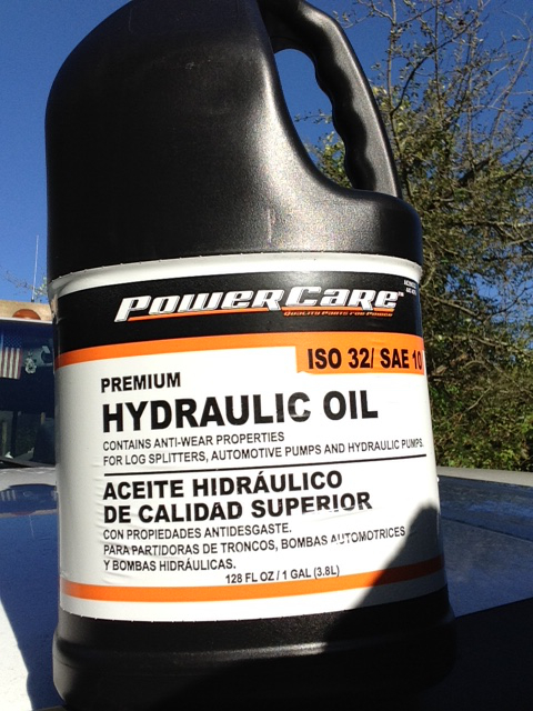

Troy Bilt 27 ton log splitter, label on tank calls for 10W AW Hydraulic fluid or Dexron III. I have tons of Dexron III and UDT, unit is about 10oz or so low, would like to add make up fluid using what was installed originally. Fluid is clean and clear, smells like hydraulic fluid. Anybody have any recommendations? Advance Auto Parts Zone was useless as was my local Kubota dealer. Haven't checked TSC yet.
Should change filter after this round of splitting, Troy Bilt wants $30.00 + tax + shipping for said filter, only spec on splitter is 10 micron. Seems a bit excessive, MTD/Troy Bilt part number 723-0405, anyone have a WIX, NAPA, Donaldson or Baldwin cross reference.

Filter should be a 3/4 inch standard 10 micron hydro filter. $10 at TSC, ect. In hydro section.
10W hydro fluid is AW32
20W is AW 46
30W is AW 68
Chris

Went to my local TSC, no luck on the hydro fluid, all they had were 5 gallon pails of AW/ISO 46. One choice of Fram hydro filter with no micron rating on the box or the filter. No one there with a clue. Headed to Home Depot, was able to purchase a gallon of store brand AW/ISO 32 hydraulic fluid, no luck with the filter. Fluid will be enough to continue splitting tomorrow, will have to find a filter online.

Turns out it was closer to 20oz low, it was at the bottom of the add line, now just slightly over full. No leaks, not sure where it went, first makeup fluid since assembly several years ago.
Approx. $15. Pic FYI,
