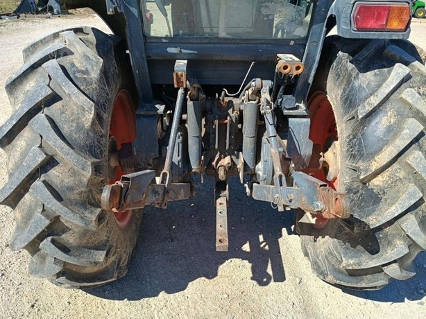

I just got this one last week!
I didn't want all the computer emissions stuff either!
Seems very sound from my inspection, other than faded paint and missing a rear turn signal and a broken little sliding rear window, driving it around my place I noticed the rear upper big window would come unlatched on bumpy ground, and the throttle set at 2600 RPM would slowly drop to 2400 RPM, it just needs an adjustment, new tires on the back too! About 50% more than your number ...
I think it will clean up nice!

Looks pretty good!
