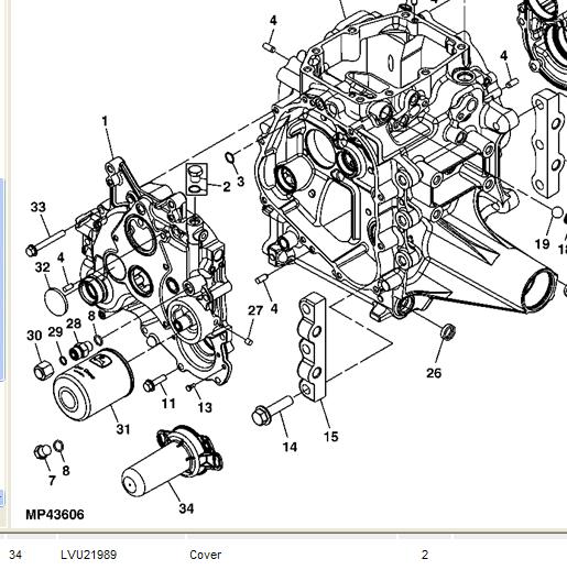

Just getting familiar with the new SCUT, so a few questions:
1. The mid-PTO came without any kind of cover, and dealer wasn't aware of one. But I don't like to leave it bare while doing loader work on rough ground. There are two screws that look like they might be made to mount a hard cover. Can someone please advise?

Regards 1.
The cover shows as a part number LVU21989

Regards 1.
Appreciate that, beenthere. Didn't find it in the on-line parts diagram; now I know where to look.
Tried to buy the spline cover from JD on-line parts counter; it wouldn't accept the number. Called dealer, who says he can't get it either. Guess it's not actually in production yet.
I am curious. Not everyone buys a mower, and a lot of us have mid-PTO attachments on only part of the time. Isn't spline damage when doing loader or brush hog work in rough terrain an issue with such a low ground clearance?
Guess I'll look for a simple plastic/rubber cover at local dealers until the real thing is available.

   / 1026R: ballast, PTO cover, break-in time? #5
Hiya,
If you want a PTO shaft cover, go talk to the mechanics around back. New tractors with factory mid PTO's come with a cover over the stub shaft. They are the same size as the cover for the rear PTO.
One mechanic I asked said he must have thrown hundreds of them away over the years.
BTW, the screws stay in, the covers have slots for the screws to slip in and spring tabs to provide tension so the cover stays on.
Tom
