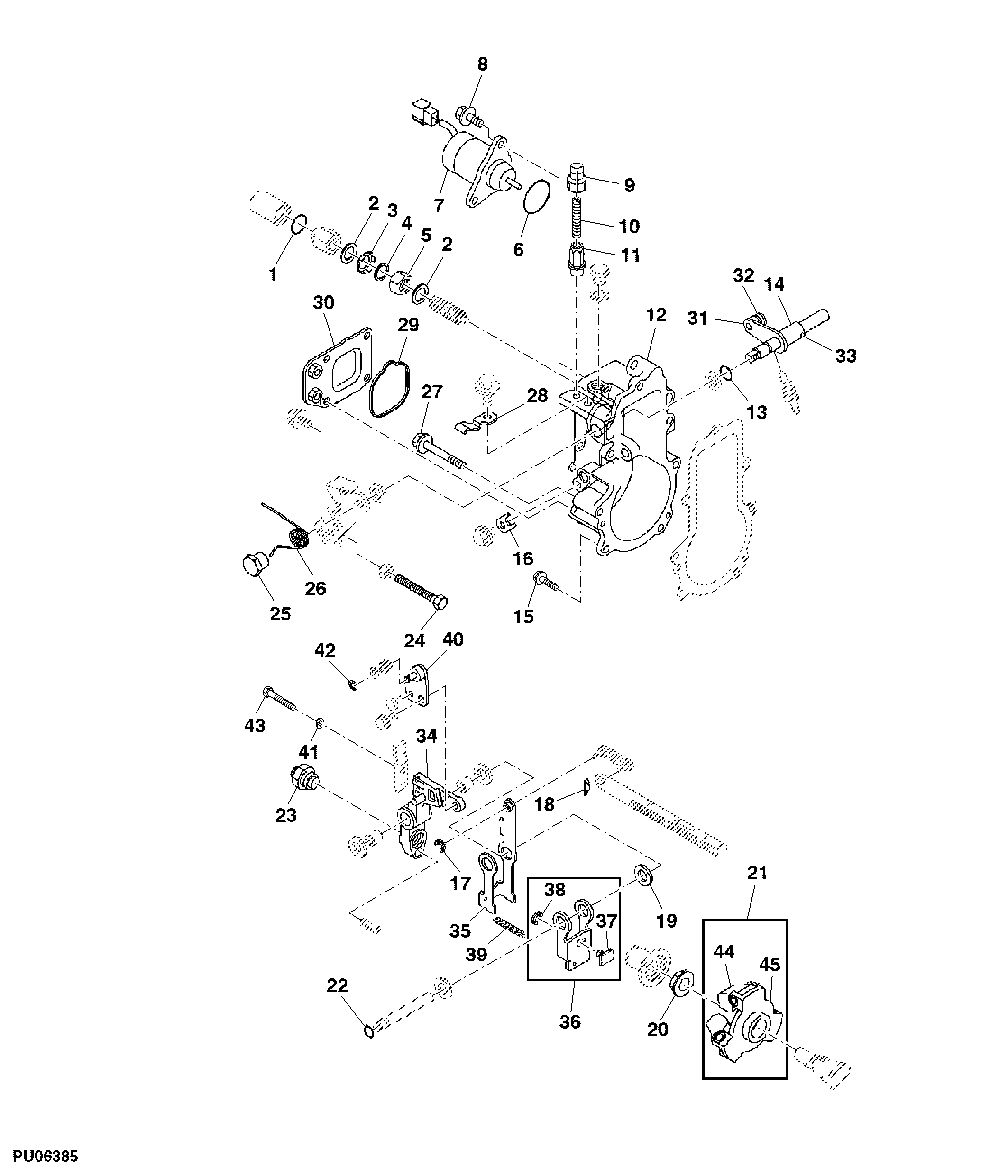

In case he comes while I'm bowling, can anyone tell me where the fuel solenoid is on the 1025R? Guess there's a relay as well?
Mechanic says I should hear a click of the relay opening when the key is turned. Don't think I heard it.
Ralph
   / 1025R quit #3
The shut-off solenoid is #7 in diagram. Right side of engine on the rear of the injection pump.

   / 1025R quit
On the injector mechanism then.
I 38 years of running diesels, I've never had one go bad.
Looks as though it'll be a nothing job to replace.
Ralph
   / 1025R quit
Service guy came. Replaced the fuel solenoid. Everything fine.
