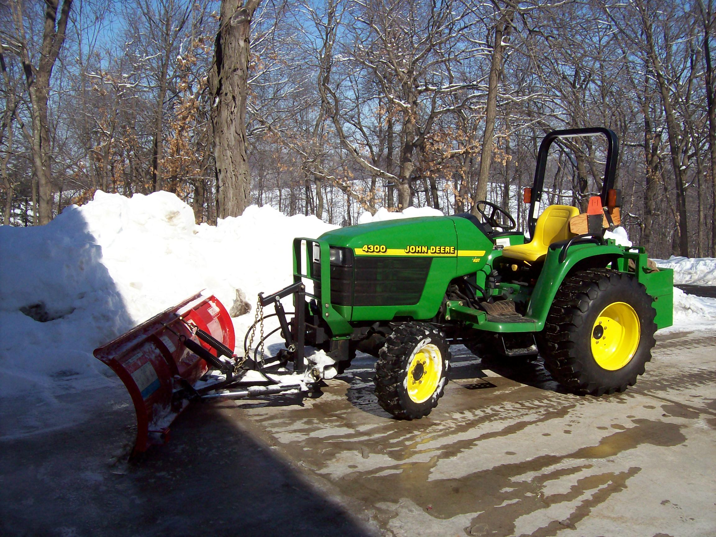

I made a plow attachment to go directly to the front of my 4300. The FEL is so quick to take off, and I felt much better rig for plowing to not incorporate the FEL.
But, there are many, many posts of people mounting blades on their loaders, and if any are finding that it doesn't work well for them, I've not read about it. ;)
