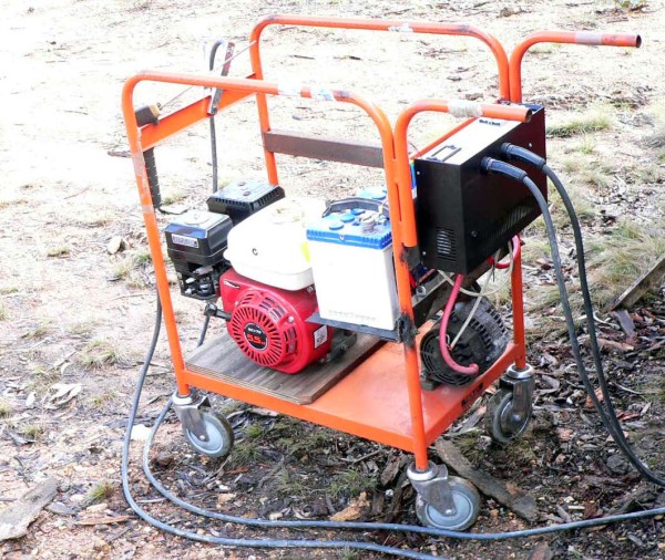

G'Day all. Hope there are some experts on this forum who can tell me what I'm doing wrong and how to fix my newly built DC welder. I followed the "Chrysler 120A" details found on the Internet and only added a shunt and 100mA meter to measure amps because I could't find a serious enough analog amp meter.
The motor is 5.5 Hp 4 stroke and a car battery is used to excite the alternator. The leads are industrial quality. The switch between the alternator field and the battery is double throw with a 1 Ohm resistor on one side and no resistor on the other. The latter switch position does produce a spark at the electrode but it is pathetically weak and the voltmeter reads on around 6V. I have obviously screwed up somewhere. Please refer to the schematic attached.
Any help appreciated
Alan

It looks like you did not modify the alternator by removing the voltage regulator... got to do that.
Check this link... On-Board Welder
KennyV.
BTW you do not need to use the switching relay shown at this link if you are using a switch with enough amp cap...

Yes Kenny
I fear you are right. The Bosch alternator was modified by an elderly mate who used to be a very capable marine electrician, but has sadly gone a bit ga-ga. I'll take it apart and try to see what he did wrong. It surely should be putting out something close to its 100 Amp rating
Cheers
Alan
