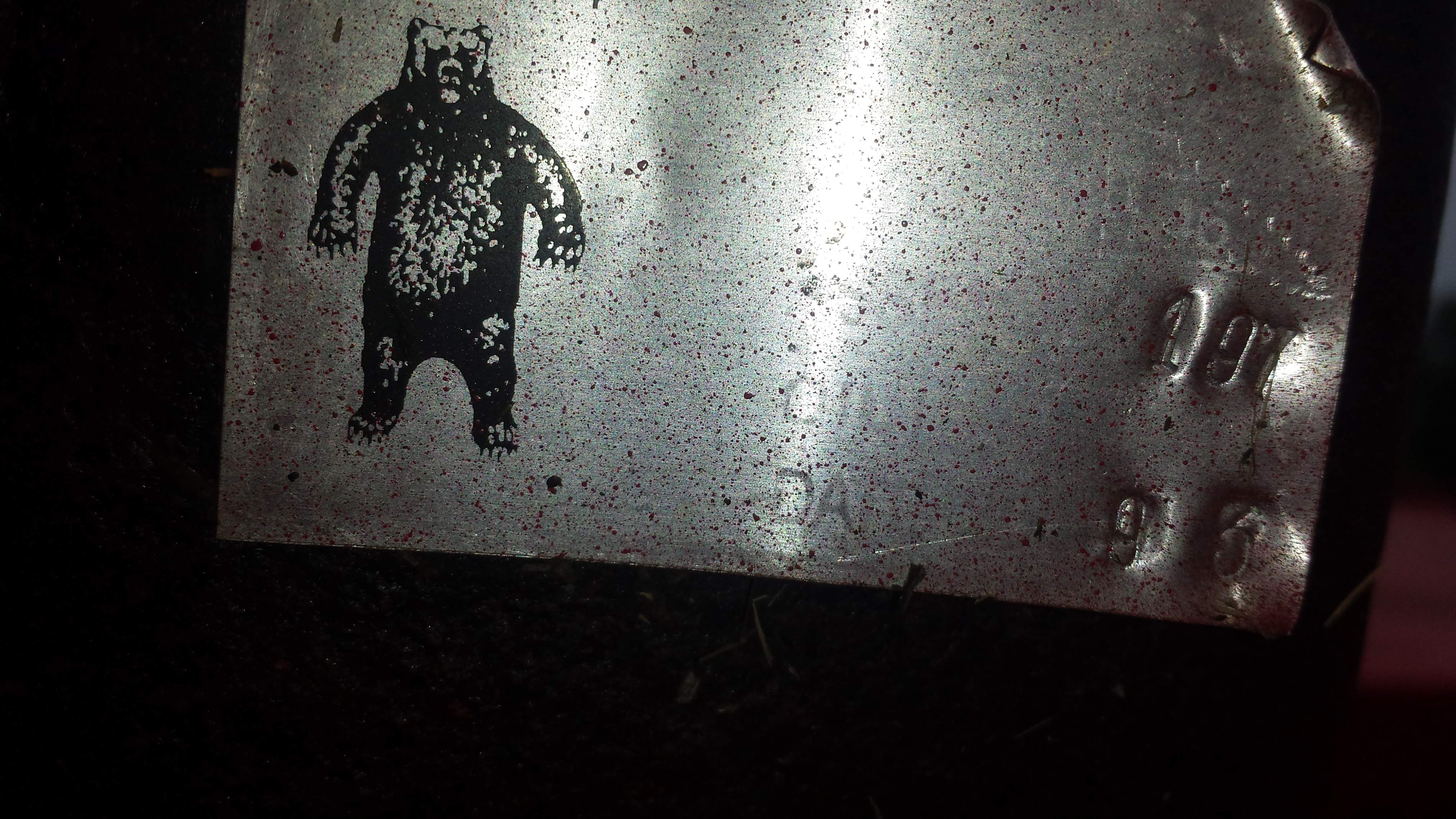

I'm new here, so I hope I can get some help. I have a couple of questions:
Q1: I bought a used 10 foot bush hog and I think it is a Kodiak??....I can't make out the name but there is a picture of a standing bear on both cutter gear boxes. Can anyone tell me if that is the symbol for Kodiak or something else? 20140817_160629.jpg
Q2: This bush hog is leaking gear oil from both cutter gear boxes. I've pulled both seals and replaced them but it still leaks??
Q3: If this is a Kodiak, where can I get parts for it? I bought the oil seals from an auto parts store the OD and ID were correct, but the thickness was a little bit smaller than the original seal. Any help would be appreciated.

I have a 6 foot HD model but mine didn't have that image on it. What seals are leaking, input shafts or output shafts? I'm guessing the leak is between the seal lip and the shaft, if so did you check to make sure there was no groove in the shaft where the seal goes also check to make sure the vents for the gear boxes are clean and open if not they will build up pressure and push oil out. If the auto parts store seal is the correct dimensions , no reason it should not have worked they usually just don't last near as long as a heavier type seal.
